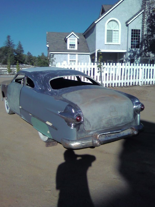

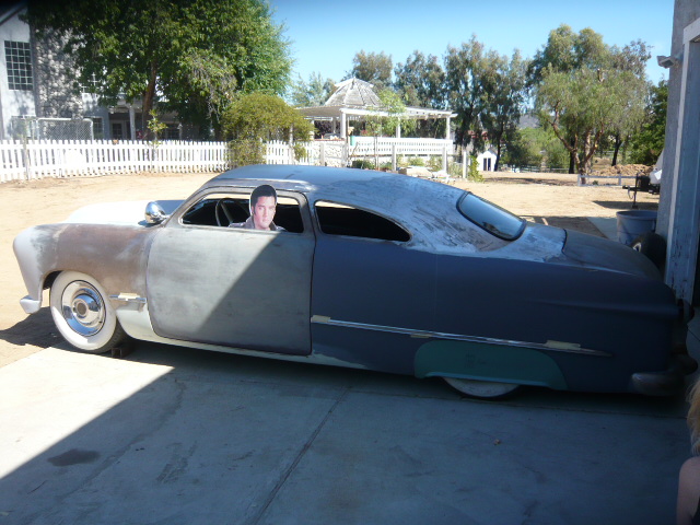

    Well between work, school, and a head-on collision back in '06, all the time I've spent chipping away at my shoebox is kinda paying off. The one thing that has been bugging me forever was the back window that I did way back in '03...simply put, it was ugly and way too flat. So last Monday I decided to do something about it :)
    More soon...
  2. Wow, that is a bad *** chop!
  3. shoebox1950
    Joined: Jul 17, 2008
    Posts: 1,221
    shoebox1950

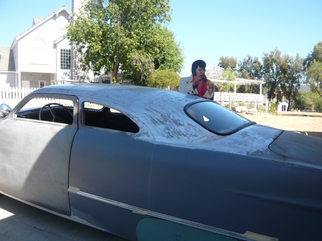

    Thanks. I have been doing some little subtle tricks to correct the proportions...I also opened up the front windshield into the roof, shaved the driprails, and installed my Appleton 552s. Check out more on my shop page...

    Wow! Is it the same shoebox you used to run in white primer? If so, you really went at it w/ a vengence! I think it was great then, its goin to be even greater now.

    Hey man! Looks killer, always loved this Ford and it looks better and better! Loved that you opened up the windshield, that's the peg leg of shoebox chops.

    Raising the top edge of the windsheild higher into the roof and thereby making the windsheild opening taller. Kind of unchopping the windsheild a little. makes the rook visually less "heavy". Also this trick has been done with several 39/40 merc coupes that I have seen.
    Lots of people would not pick it out unless they were told it had been done but it makes a big difference in the visual proportions of a car.

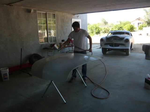

    BTW, this a 50 sedan I bought already chopped a few years ago. Bought it to sell to get build-money for my coupe. Posted are photos of what the new owner did with it....he made it pretty nice. Long live shuboxes!

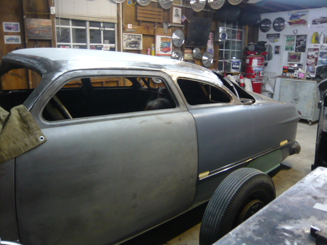

    Thanks guys...this is how the car looked in 2006. Yep, it's the same car as the white primer one I used to run around in...but no more bags, flat roof, and bad bodywork. After the wreck, I tore into it pretty hard and replaced EVERYTHING. It's finally coming together now and I want to thank my good friend Octavio Chavez for the fine bodywork he has been doing...
    Anthony, how the heck are ya...I've been meaning to email ya...
    Here's the same car in 2006 after some fat ***** on a cellphone hit me. I almost killed her.
    And some other recent pics, too...

    Moving thet roof foreward on the backend really makes the car....nice job.

    It looks really good with the new shape of the rear window, and back portion of the top...what an improvement, and bold move to do. Most would have left it alone. The opened up windshield and Appleton 552's are perfect.
    This sure will be one that will be remembered... and hopefully copied.

    I got a lot more done today but nothing worth posting a picture of- mainly just finish welding the sailpanels and rear roof area. I will post a pic of the completely finished chop when it is done.
    I took out the airbags simply because I am over them. I thought they were cool in 2002, but I don't anymore. I never once had any problems with them and the car rode great, but I am taking the car down a more "traditional" path now. Just don't look under my hood cuz the 350 is staying :) haha
    Having the time to redo my roof has really motivated me and now that it's almost done, I think the rest of the work I have planned will fall into place.
    I'll post pics of the tail lights when they're finished, too...I don't want to spoil it for now...not a new idea at all, but something I haven't seen repeated since Barris did it.

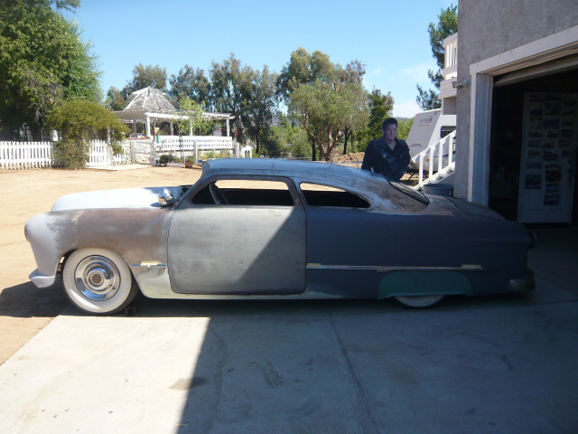

    I finished restyling my chop today...onto the tail lights next. More pics soon. :)

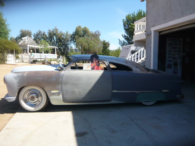

    Nice that Elvis stopped by to help. Thank ya, thank ya very much. :cool:

    Wowee! Looks amazing Rob, doesn't even look like the same car. Are the bags already out in the new pics you just posted? Sits beautifully.

    Bags are still sitting in it so I can eyeball the stance then take some measurements for when I lower it. I had a pair of rear leaf springs dearched 4" and they're ready to go. Coils are on stand-by too :) But, yeah, that's about how I want it to sit...
