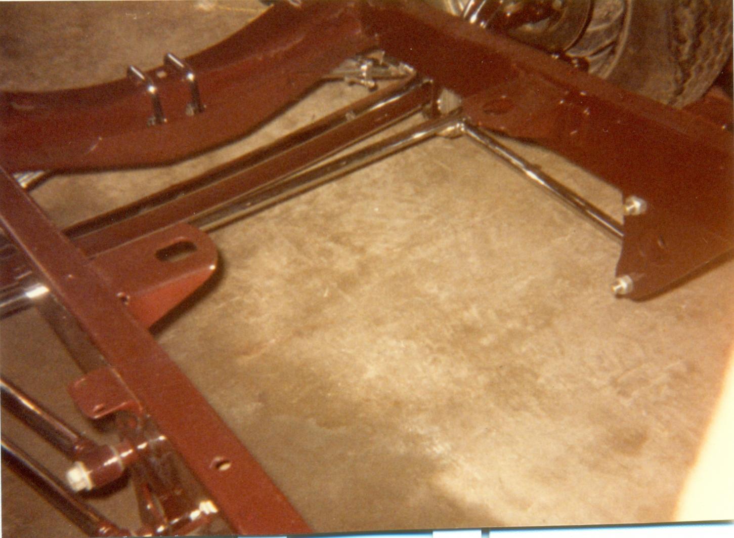

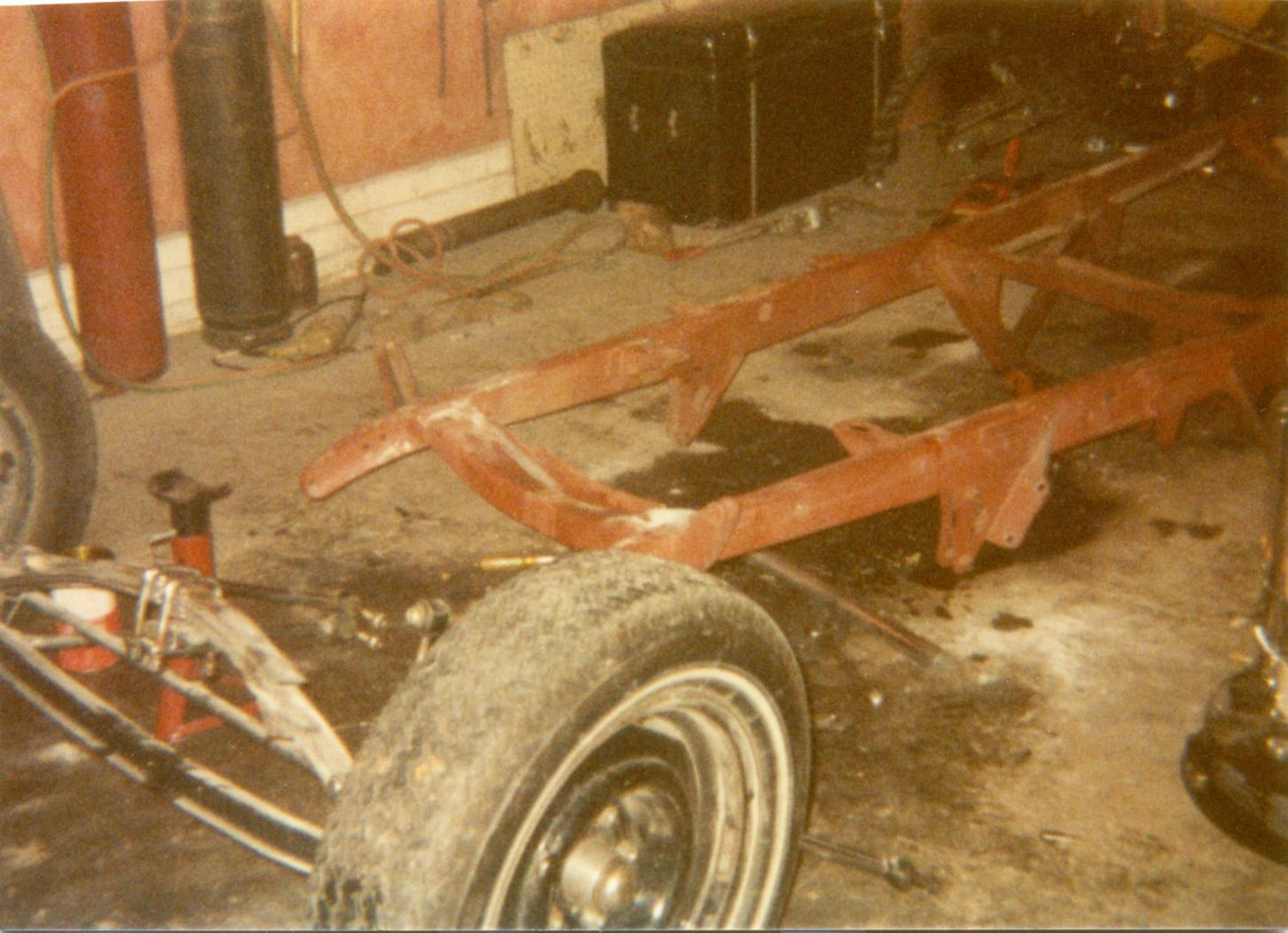

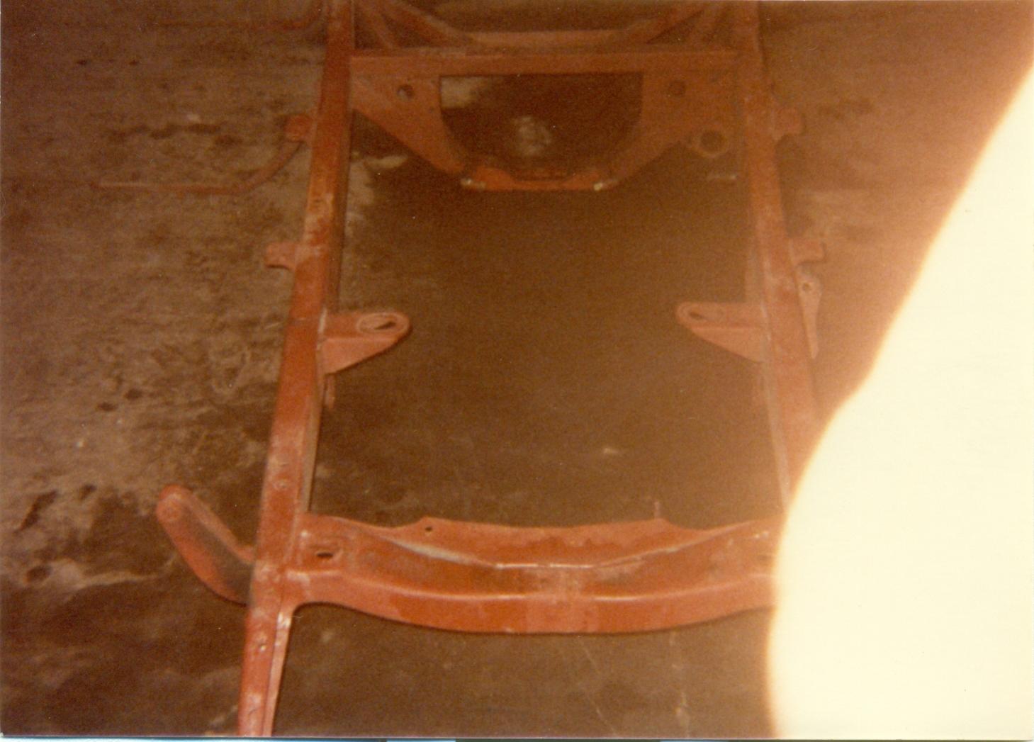

    No extra parts and the front crossmember was not from this frame. Someone had bolted it in with 3 bolts and the rivet holes didn't line up at all. I do believe it to be an early 28 frame as the 31 frame that was under the car had provisions for steering box mounts on both sides and the early frame had only one on the left.
    Didn't the AR frame have taller rails over the car frame lets say 6" compared to 4"? Could you show me the differences with a pic or 2?

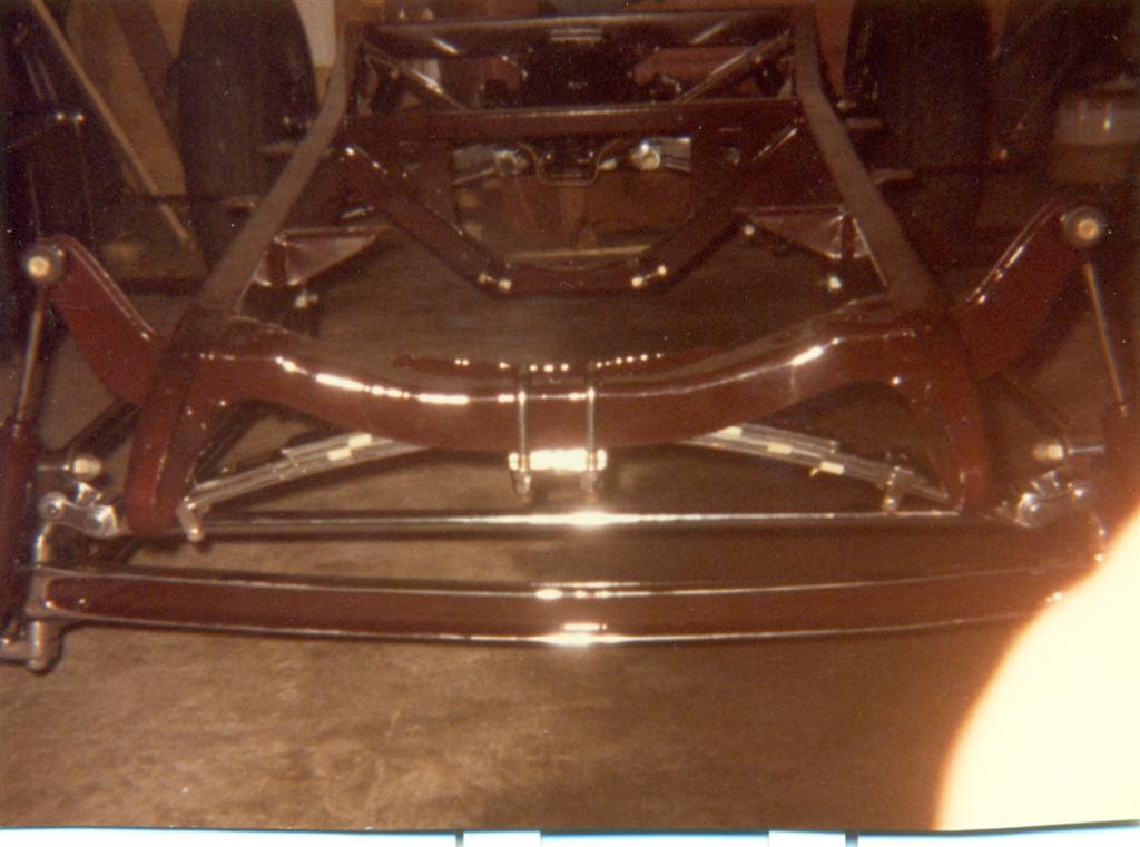

    Here's some poor pics of my AR frame from 79 or so. I remember, i think, t******* the rear lip for clearance for the lower pulley. It has the forged brackets through out and a bracket riveted on the left side for the e brake which you can't see in the pics. I think but not sure that the bolt pattern for the fender braces and running board brackets where smaller than the stamped brackets.
    Nice project you have there. Glad to see you found a coupe roof.
