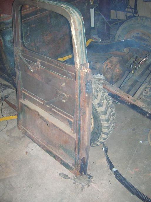

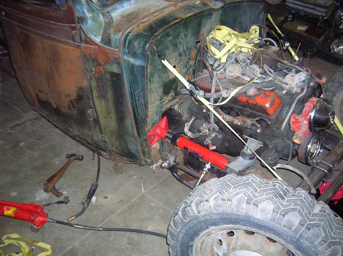

    Then you need to get your door gaps where they need to be. You need to push, pull, prod, poke, and pound to get it there. I used a porta power and a bunch of ratchet straps to get mine straightened out. This thing is floppy so you need to work at it and redo thing over and over until it stiffens up.
    When you get the cab where you want it you need to weld the cab to the floor front and aft.
    With that done you can take out the wood. This is a stinky and messy project. Do like I do and have a nice cold beer in your hand while you cut all the hardware holding the wood in. That way you can cure your scratchy throat from the smoke and put out any little fires that you WILL start from one handy can.

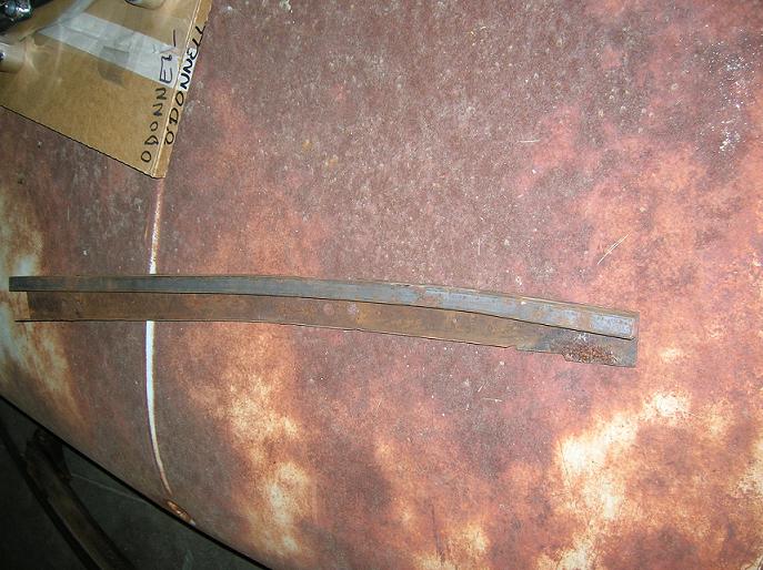

    Being a tool junky comes in handy sometimes. I got one of those cheap ring rollers last year and it is tits for rolling sweeping bends in tubing. I thought I took a pic of it but apparenly I neglected to do so.
    I used the interior trim piece as a template and rolled out the shape I needed. Make sure you get it right because the cab derives its shape from this piece.

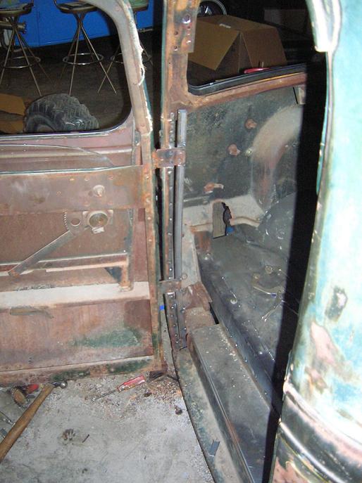

    I then reinforced the pieces and cut out the spot for the hinges. I put the door back on and lined up the gaps and welded the hinges to the tubing. Now the door shuts effortlessly. Before it was about falling off and wouldn't hardly stay on.
    Simple! I did this project in about 2 hours and 4 beers. I used half of one putting out a small fire though.

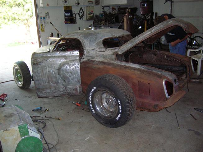

    The Cisco kid has been working on his stede coupester as well. He has the doors swinging and stuff.

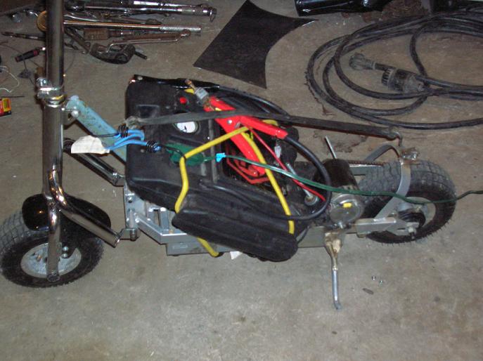

    His kid Jeremy is just as screwed up as him, look at the "power upgrade" he added to his little electric scooter. I was over there last night and he had a whole car battery on there. Ha Ha Ha

    I like the electric scooter too, I've been wondering when someone would HotRod one O' those Segway scooters.
