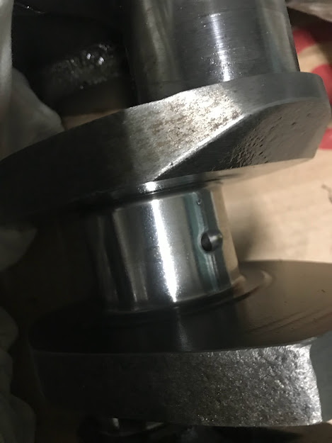

    The crank looks like new. The upper shell looks OK. The bearings are Std size.

  16. I would check the clearances with good quality micrometers or you can use Plastigage.......looks like that bearing might have been installed too tight.

    It was dis***embled to install a cylinder sleeve due to a crack in the cylinder wall. Engine was using water. I built the engine 15 years ago. and has about 50,000 miles.

  19. Always remember this .
    100 bucks is nothing in Flathead dollars,,,,,,,replace the mains,,,,check the rods .
    By the way,,,you are right,,,,the crank journal looks great in that pic .

    What has been said but 50,000 miles on a standard size crank - was it a NOS - just polished or what ?

    It is a **** crank as it came out of the engine.
