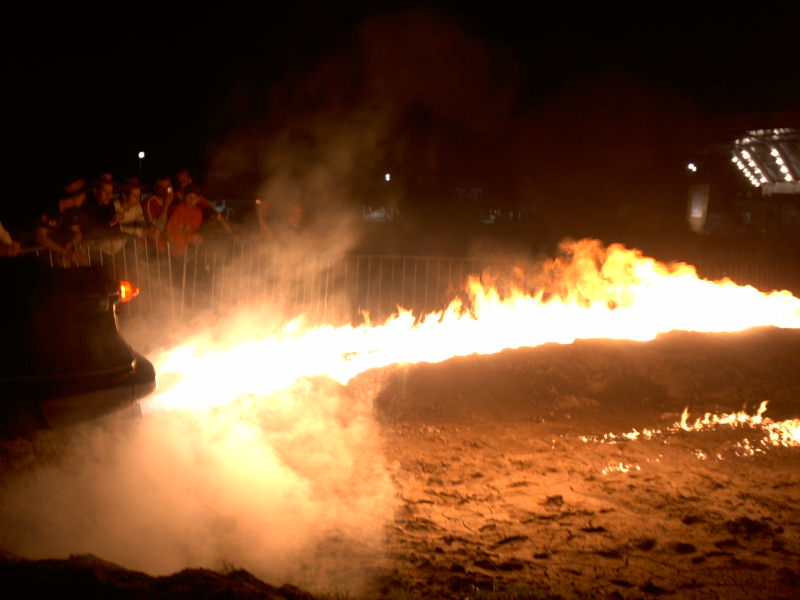

    this is my home made flame thrower.
    It is just the first try.It only gives 20 fT flames.
    We are aiming for 100 + FT :D:D:D:D
