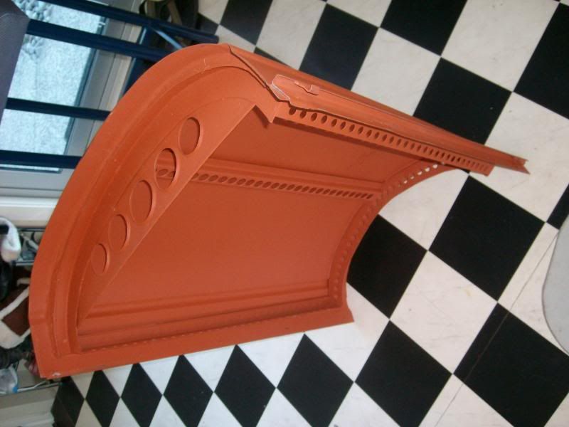

    When we built this 'A' , we wanted the channelled look ,so built these 'skirts' that mount below the body & cover the rails, so I thought I would show Chris how I done the front section inside that green circle, as the body was narrowed there was a little bit more work.

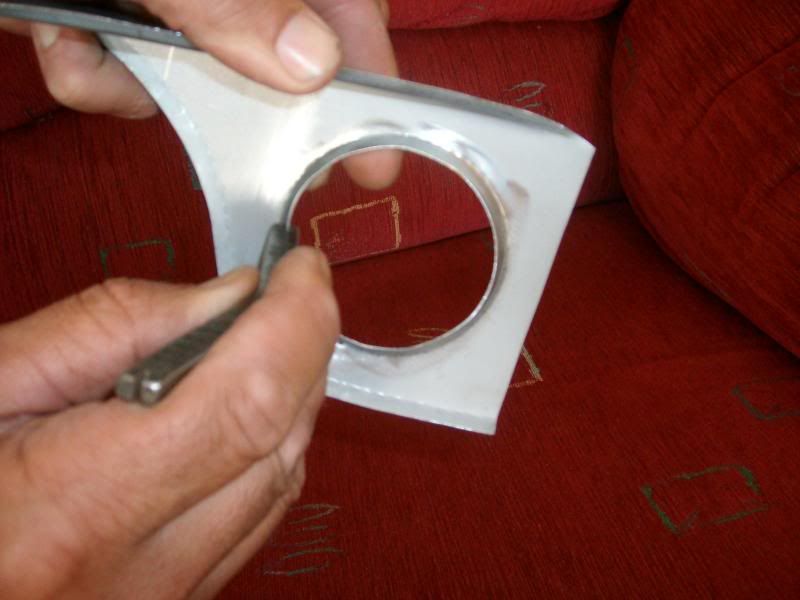

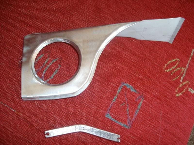

    First we cut the shape we wanted out ,drilled the hole in the correct location ,folded it at 90 degrees in my small folder , then the 'tool' I made came into use...

    As you can see We not only used the 'Flaring Tool' for the hole ,but to flare the edges, where the arrows are pointing ......

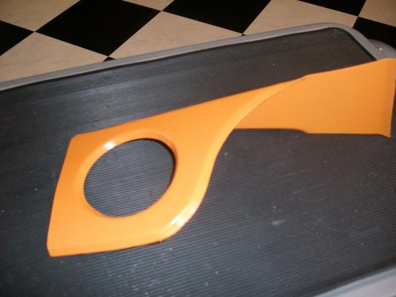

    Then I gave it a quick shot of some paint (ugly colour :p) I had here just to show how it came up ,this was without to much clean up and pretty much straight off the tool, this from start to finish only took 30 minutes,Chris was really supprised at how simple & quick something like this was done

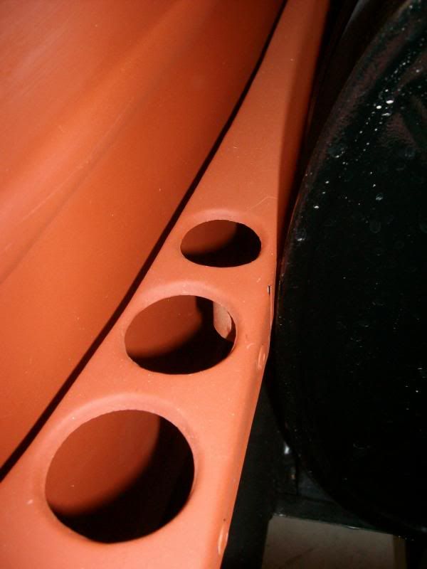

    This pic here is from the inside of the 'skirt' below the body line , again both the bottom and top fold (approx 6mm) was done by the flare'n Tool, then just hammer'd & dolly'd up;
    The amount of material you want folded is determined by how much of a cut you do in the Flare'n Tool.
    My folder is only about 600mm ,so any thing over that I have to use that tool , plus also my folder is not the best for folding 5 or 6mm folds as it tends to move the material around a bit.

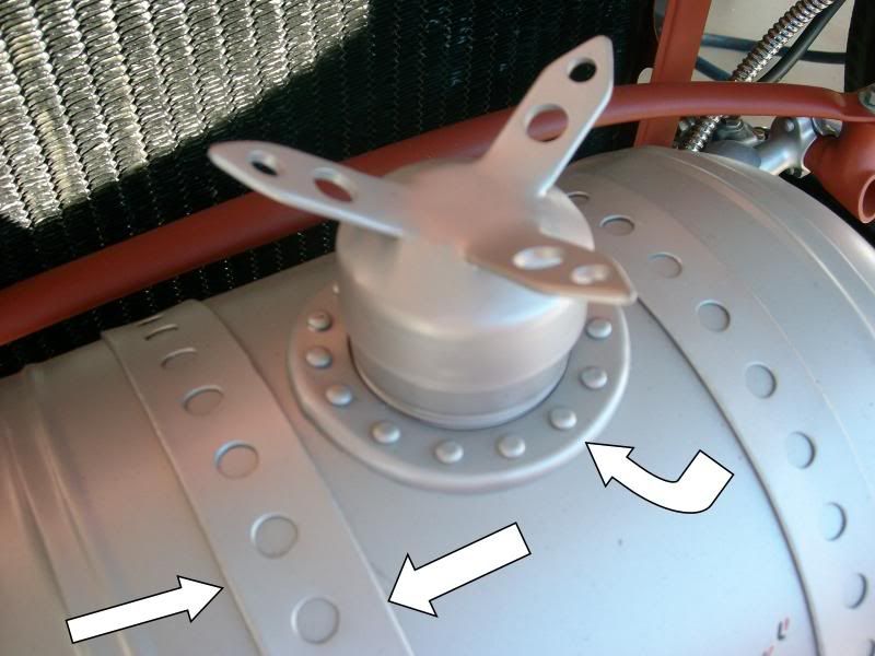

    We made this 'Moon' style tank from two end caps of unknown origin ,made the rolled center bit by rolling around the mig bottle again, wanted the straps to have holes in them but still be strong, again my folder was to short to fold a 5 mm lip the length of the strap ,so again used the 'flare'n Tool' to fold both sides under ,them hammer down flat ,then drill the holes with a step- drill.
    Also ,with the flange around the inlet , this was cut out then 'flare'd' over ,screwed into the tank, screw holes filled over to look like riverts.
