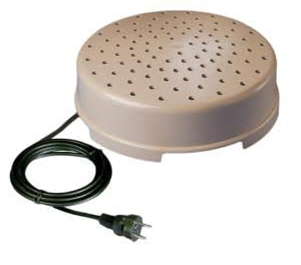

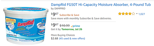

    Hey Gene,
    We all have some sort of water damage or moisture in our houses and cars that stay outside. But, in your case, after you get the car back from the insurance company, you will have to dis***emble it for best results. Yes, the desiccants are a good way to get the moisture out, but if you cannot get the desiccants from a shipping company, then go to your local big box store or amazon.
    These plastic containers with Damp Rid Pellets work well, but you have to check them every day to empty out the liquid that fills up the container. Dump the excess and put it back in place. The hanging ones are great, but as they absorb moisture, get overloaded, they drip or leak. So, we have only used these large plastic containers for ease of use and emptying.
    But, for garage with the body empty, you can safely place one of the Davis Air Dryers in place and shut the door. It heats up the whole area without a flame or hot coals. You can leave it plugged in overnight as long as the top and bottom are not clogged up with combustible materials. Air flow is a must. We had it sitting on a large piece of floor tile and it worked well. Always wipe off the top surface to keep the dust and other combustible stuff out of the holes.
    Jnaki
    Here are a couple of old posts from 2016 that talks about the mildew and moisture problems. The first was taken care of by desiccants and the air dryer. The Corvair needed towels, remove the carpet, a big garage wet/dry vacuum, and a large fan going all night and day until the moisture was gone. No desiccants were available back then and there was not something like the Davis Air Dryer. Just a big fan blowing for a week, all day and night in the garage.
    Hello,
    Wherever you store your car(s), there is some moisture that is getting inside of the structure. In an old house that we used to live in that was built in 1963, someone had poured a concrete patio up against the house's weep edging. No air was able to go in and circulate. So, the inside of the closet that backed up to the wall started getting some mildew.
    This device solved the problem from the inside. I had to go out and clear out the concrete away from the house to let the weep edging do its job. mildew solved. But prior to this, we also used those crystals in a plastic container. That soaked up the moisture, but was a pain to empty without spilling.
    Davis Air-Dryr 1000 Mildew Fighter
    This device plugs into any outlet and is relatively trouble free. There are no moving parts and it is a low powered heating plate underneath. No fire hazard unless you store it next to stuff that will combust over time. On a concrete floor, it is best. on carpeting, you might want to place a floor tile underneath.
    On a friend's boat, he had one plugged into the shore power outlet and that kept the boat dry all winter. Just sitting in the dock, thin fibergl*** walls weep moisture during the California winters and it runs down the side of the interior walls to the sump. Sometimes, during the winter when people are sleeping and it is cold outside, ordinary breathing moisture builds up inside the walls and runs down the walls to the sump. When this device was turned on, the moisture on the walls was not there. It also provided a slight heated cabin upon arrival the next time to go sailing. It does work.
    In your case, you might need at least two of them, depending on how large your garage is and how much it is exposed to the weather.
    Jnaki
    If you put one in each car, you might want to roll down the windows slightly and put a floor tile under this heating device. For the small space, it definitely will keep everything dry and no mildew smell. Also, did you check your heater/hoses for leaks under the carpet? This Davis Company makes smaller versions, but they don't put out as much drying power. YRMV

  29. I have used damp rid in a lot of my old cars that leaked water.The stuff really works.Bruce.
    jnaki likes this.
