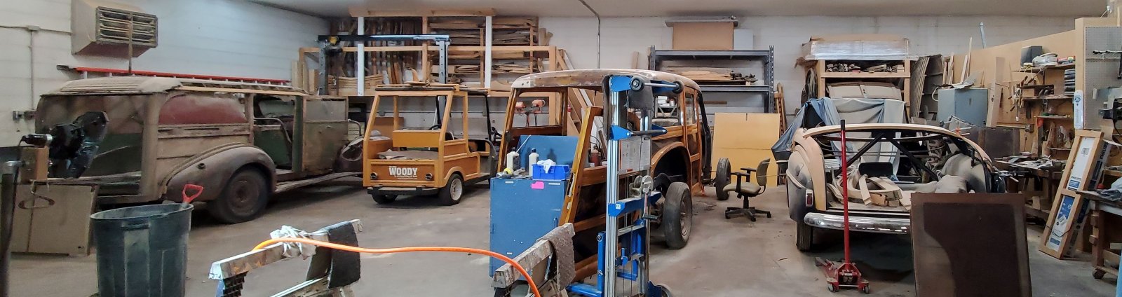

    Stopped over to see what's new at Kings this morning. Amused to see how they 'do' puzzles. They received another 39 last Friday and here is how it was delivered. 20220722_102734.jpg
    So it seems that their puzzle days are a lot different than mine. Somehow, they will take that pile of rotten wood off the back and end up making it (and the one next to it, also a 39) look like this

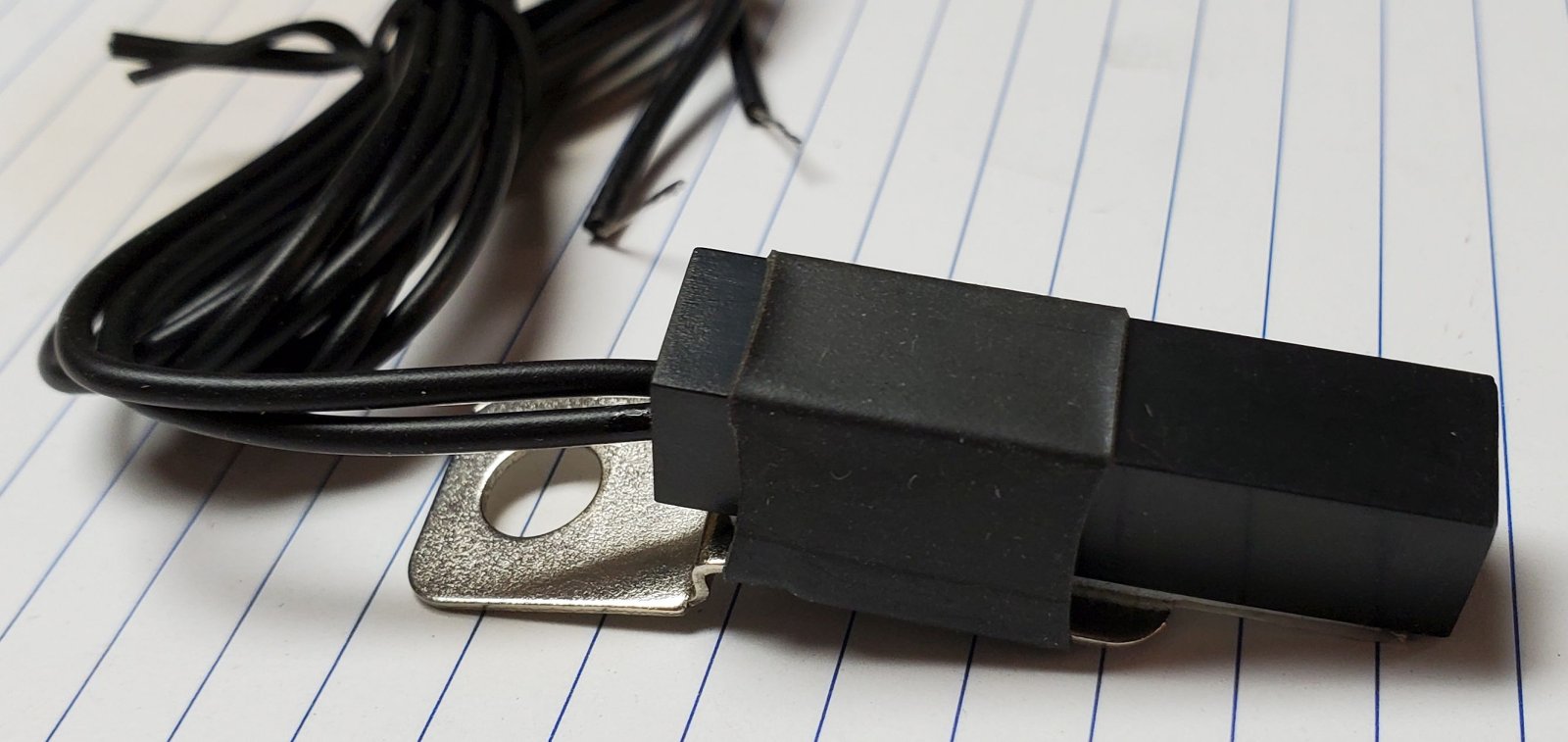

    I am giving up on rolling ball tilt switches. I tried to go with the environmentally friendly tilt switches but they just don't do the job. Trunk and hood lights are on reasonably steady if engine is not running. Soon as I start the engine they start blinking as the ball bounces on and off of the contact position. I have ordered Omega AU46 switches from two distributors and had to send them back. Even though the image shows a gl*** tube with bead of mercury the switches are now fitted with sliding ball instead and I can't get any of the suppliers to correct their web pictures or make suitable statements so hope none of you are getting ****ed into this ruse. I finally found some mercury switches at Parts Express and a very cooperative customer support person that was willing to check and confirm for me before I ordered. My original 50 had an aftermarket hood light that had a mercury switch in it and never failed to work. Hopefully after I replace the switches in the current lights I can get comfortable with the lighting again. Don't have a lot of work listed to get done this winter but this job is at the top of the list. Regards to all, hope you are having a good fall/winter/spring/summer wherever you are.

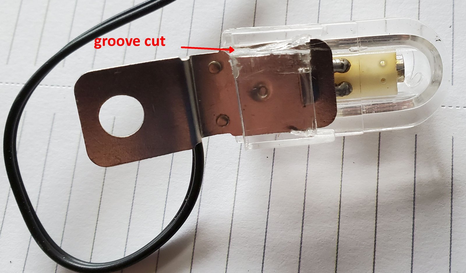

    For any of you that are faced with the tilt switch swap I noted a post back, here are some details of how I went at it.
    I found a seller of real mercury tilt switches and ordered some. The new switch is not in the same package as the AU46 (original or phony new ones with the sliding ball) so after looking at the parts for a short while I decided to use the original switch bracket to mount the new switch so I would not have to fabricate a custom bracket. ts 1.jpg
    To extract the bracket from the plastic housing I decided to carve a groove in the back side so I could break the band apart and 'pry' the plastic up enough to allow the bracket to back up through the frame.

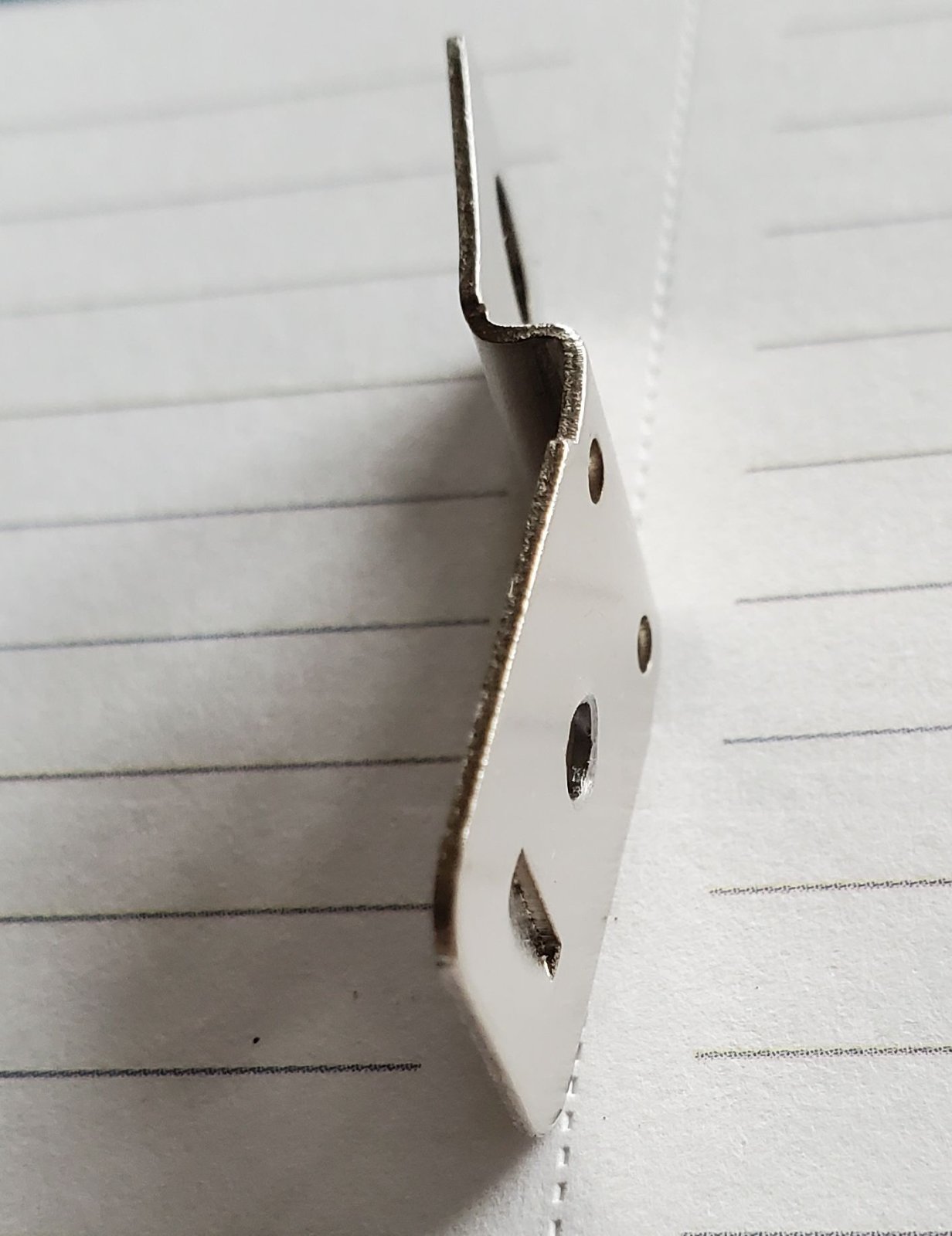

    Once I had the bracket free I drilled the dimple out so that the new switch module could sit flat on the bracket surface.

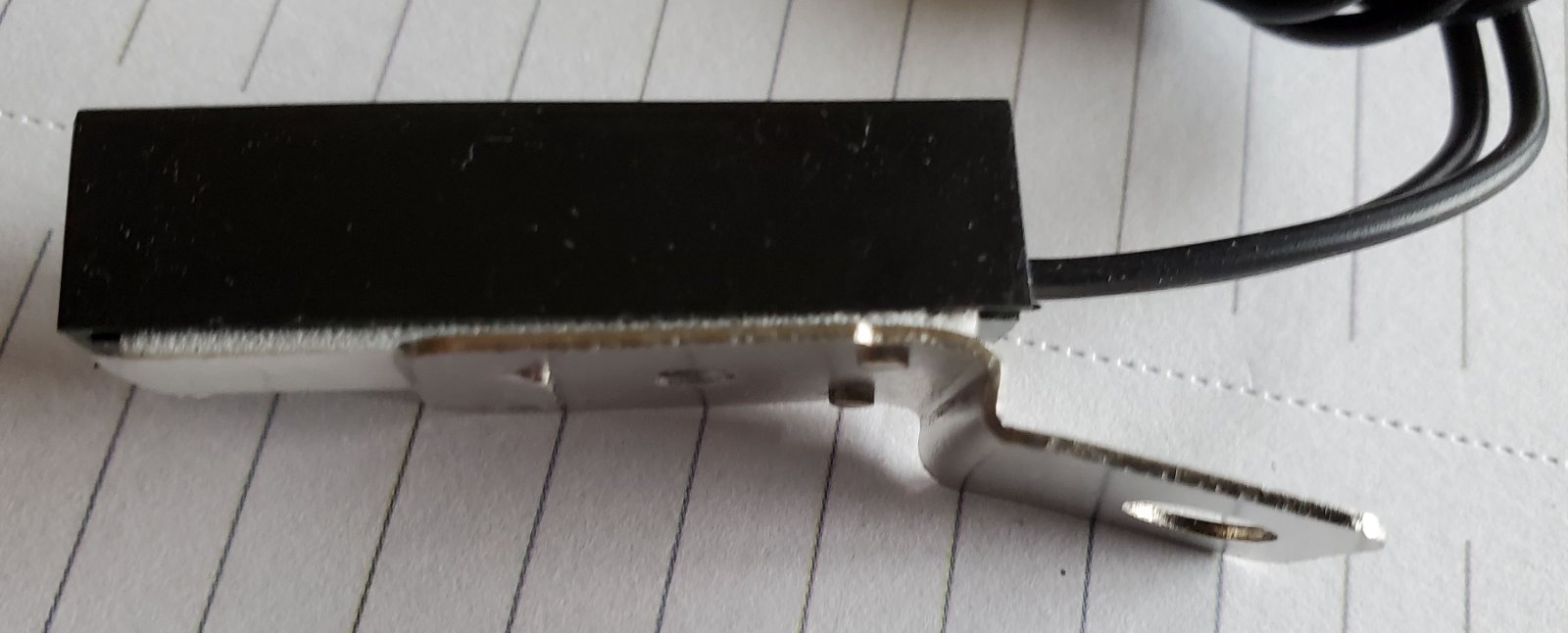

    I used the double stick tape they supplied on the mercury switch module to mount it to the bracket.
    And, considering the hood light is over the engine and would be experiencing a lot of heat soak I thought it best to make sure the switch stays fixed to the bracket so I put a band of heat shrink around it and set it 'tight'.
    Checked fit and all is good so next trip to the shop I will connect and put all back together for testing. I have meter tested the switch ***emblies to make sure they are all good and am not disturbing anything else in the lamp enclosure so feel comfortable with final testing after re***embly. Also,,, if I did mess something up it only takes about 5 minutes to open up and check out. Regards to all of you and your projects. Bob

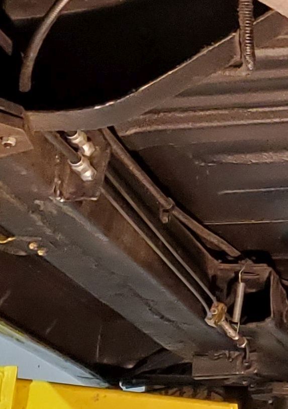

    I don't know about the rest of you, but I really get frustrated (and worried) when I fix something and don't know why I fixed it! Went to work on the parking brake issue (has not worked since I replaced all the shoes, wheel cylinders and bled the system) and after checking the cable operation from dash handle to breakout area. FB50 PB problem 2.jpg
    I decided to test each side cable before digging into the wheel ends.
    The p***enger side cable (lower) worked as expected (medium pull to take up slack and then heavier pull to expand the primary shoe) but the driver side cable would not go past taking up the slack.
    Pulled the wheel off and inspected the cable run. Did not see a problem so I figured I probably made a mistake when I was installing all the new parts and re***embling the brake mechanism. SOOOO,,,, took it all apart, piece at a time,,, checking and taking pictures of how it was installed before removing. NADA,,,, could not see any issues as I took apart so just before removing the shoes I decided to check the cable pull again and IT ALL WORKED FINE!!!! OK,,, so figured that as spring or lever arm of base brake system was interfering with the cable when ***embled. I started replacing the springs and operating arms and kept checking the cable operation as I replaced each part. Finished putting all together and the cable was still operating normally. No Idea what the problem was, but it was gone after re***embly. Put the tires back on and next time out, I will test the parking brake with the car still on blocks and wheels free to turn.
