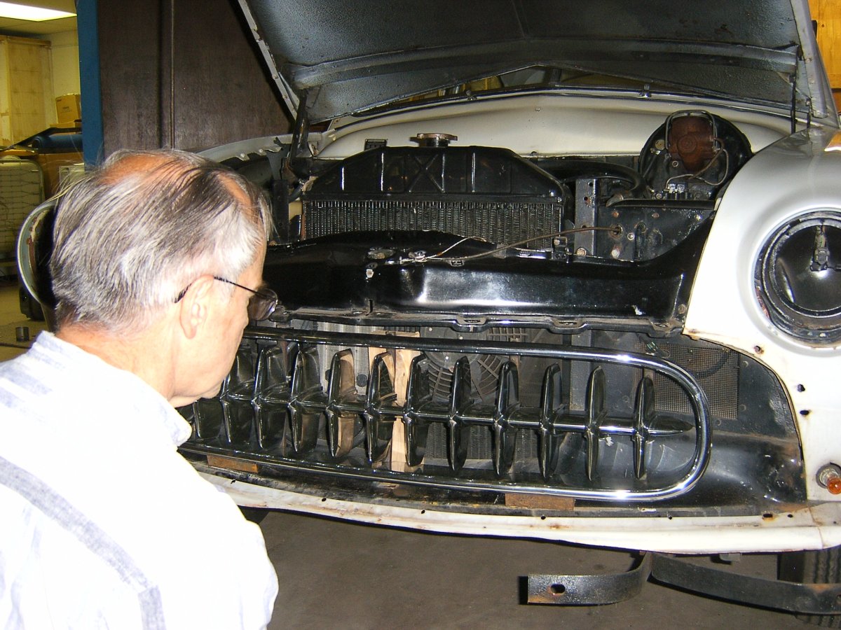

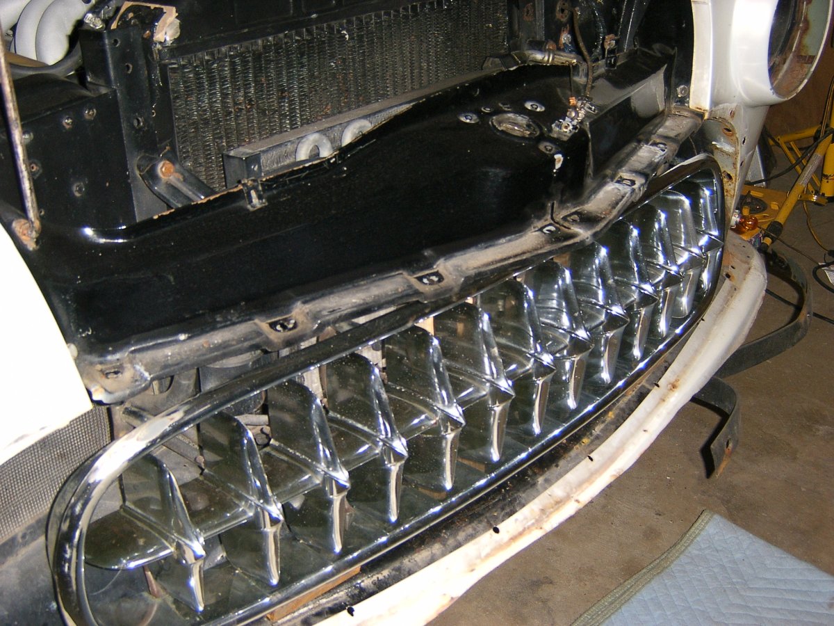

    We planned to work systematically from front to back replacing all metal that was rotten or too tangled from previous damage to be worth straightening and filling and then commence with the custom modifications that were the goal of this project. Before sending the car to the body shop, I was busy working on design and implementation details for the front end. The original car had a 53 Chevrolet grille bar and the old George Barris style ominous mouth treatment. I wanted to stay with a toothed grille but with a less prominent center grille bar. I chose the 57 Corvette grille for this project with the intent of building style matching parking lights into frenching buckets on the grille/headlight centerline intersections. With the car partially tore down, I borrowed a 56 Corvette grille from the body shop that was to do the major restoration work and did some show and tell exercises to see how much and how different it would have to be. I decided that the grille bar and teeth would work fine but the chrome surround trim would not. It seemed that it would be better to make a form for creating the grille surround and chrome trim pieces that will bolt in to maintain serviceability of the radiator, transmission and AC heat exchanger cores. By creating a custom surround trim arrangement it would be possible to make a more integrated transition between the peaked hood shape of the Ford and the rounded base shape of the grille. It was clear that the Corvette surround trim would stick out reasonably at the sides but would be difficult to merge into the body metal around center since it would be well under the lip of the hood, even if we rounded the hood a bunch. The following pictures were taken while we were figuring out the shape and form needed for this work.

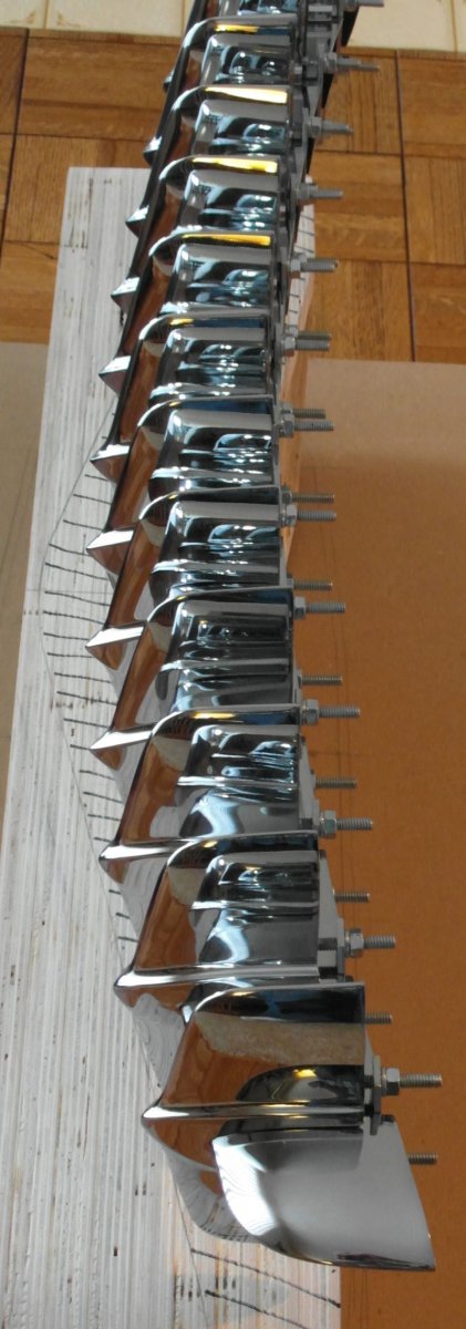

    While considering those factors it seemed that the chrome surround trim should not be as heavy as the trim on the Corvette was since there would be other items of significance in the front and the heavier chrome trim would seem to distract from the grille teeth effects and isolate them instead of integrate them. All that in mind I started on the layout and design of the grille surround and a pattern on which the grille surround and surround chrome trim could be built and checked.

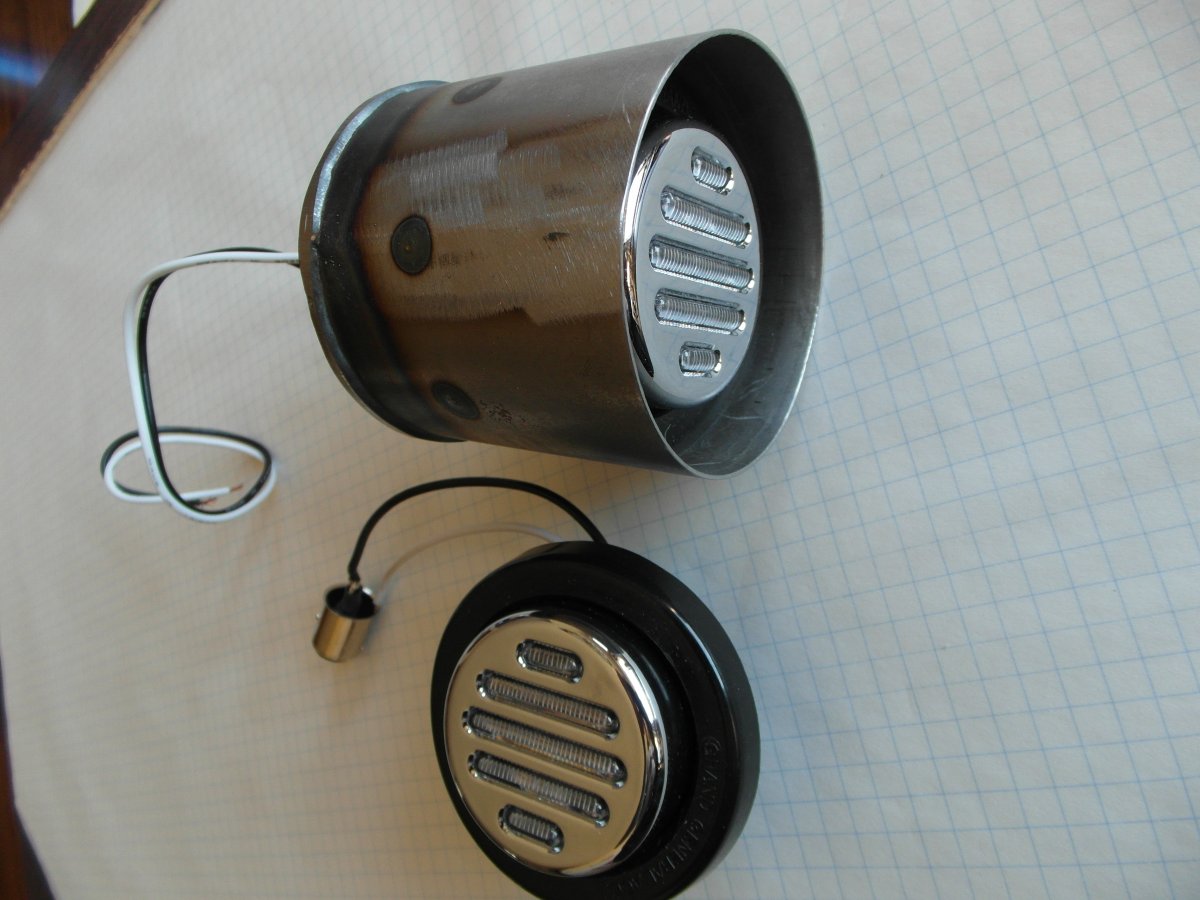

    For parking lights I wanted to continue the toothed style and found some truck marker lights that did a reasonable job of transitioning while keeping the style. I had to make some conversion plugs to get the two brightness levels out of a marker light but that worked out well and then I found some universal sockets for dual circuit bulbs that fit the frenching bucket perfectly
    The car was moved to the garage and basic recovery and restoration work began. Finally, after a few months of intense body panel replacement and basic restoration it was time to tackle the front end and see if the wooden pattern and all that sketch work would pay off. The surround shell, to be welded into the body metal, was built up on the pattern, mounting brackets for the grille bar spotted on the shell and the entire ***embly clamped in place and some trial bridge pieces formed and placed into position, to see where we were with the whole idea.
    The initial results were gratifying so work commenced to finish up the mounting brackets, form the bridge pieces, weld them into place, and grind off the weld beads in prep for final finishing and prime work.
    While this work is in process, we are also trying to work our way through the hooded and frenched headlight stying and metal forming. A couple of attempts at stick building did not seem to be yielding the results we were expecting so we did some research and decided to try some 1955 Chevrolet headlight hood patches. It seems that with some mild modification work these will bring the proper form and at***ude to the headlight hoods.

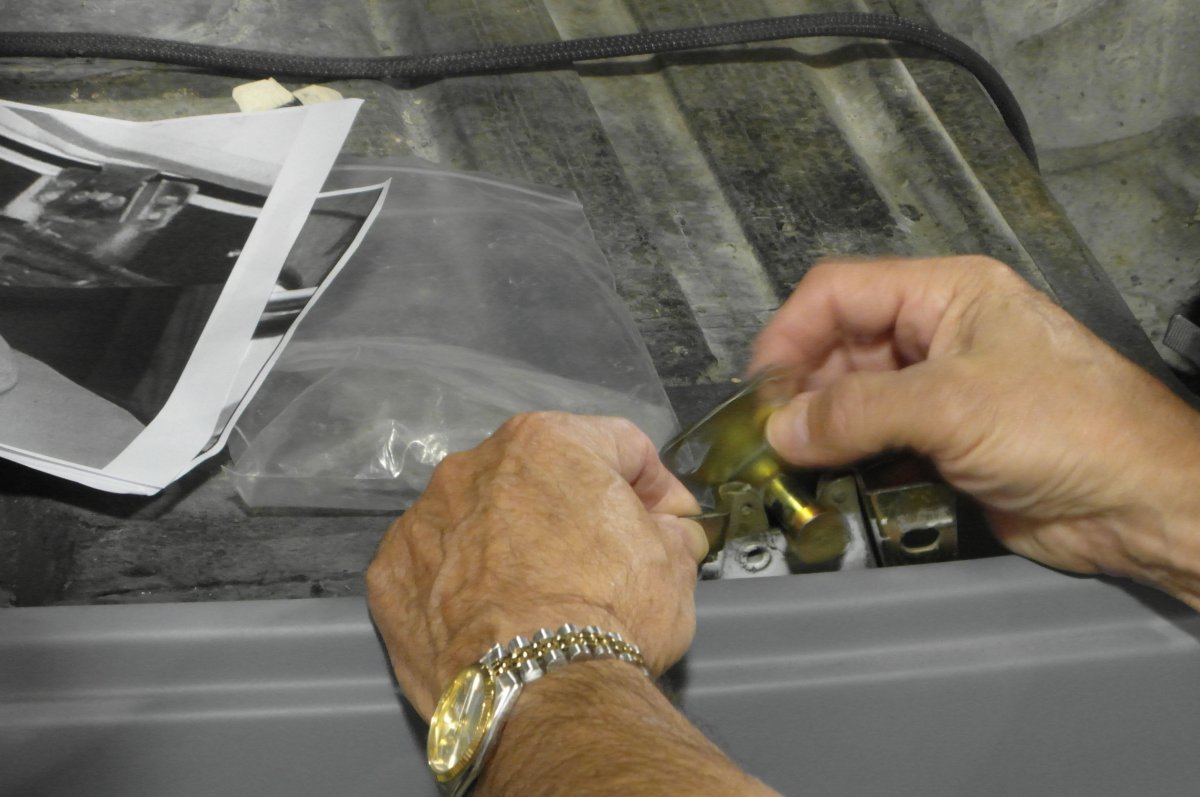

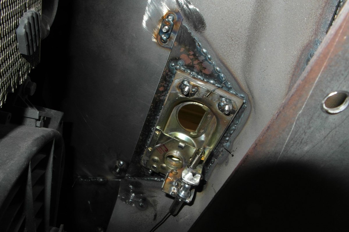

    8-22-13 Thanks to you that have shown interest in this project and hope that I am not getting too detailed. We have made some progress with 55 Chev hood patches to clean up the headlight styling and VW MT52 hood latch to resolve the 'oops my hood flew up' problem. The hood patched had to be 'split on the ridge line so that they could be properly mated to the fenders and then welded back together. They also had to be 'squeezed' a bit to reduce the diameter of the opening to match the merc frenching rims OD.

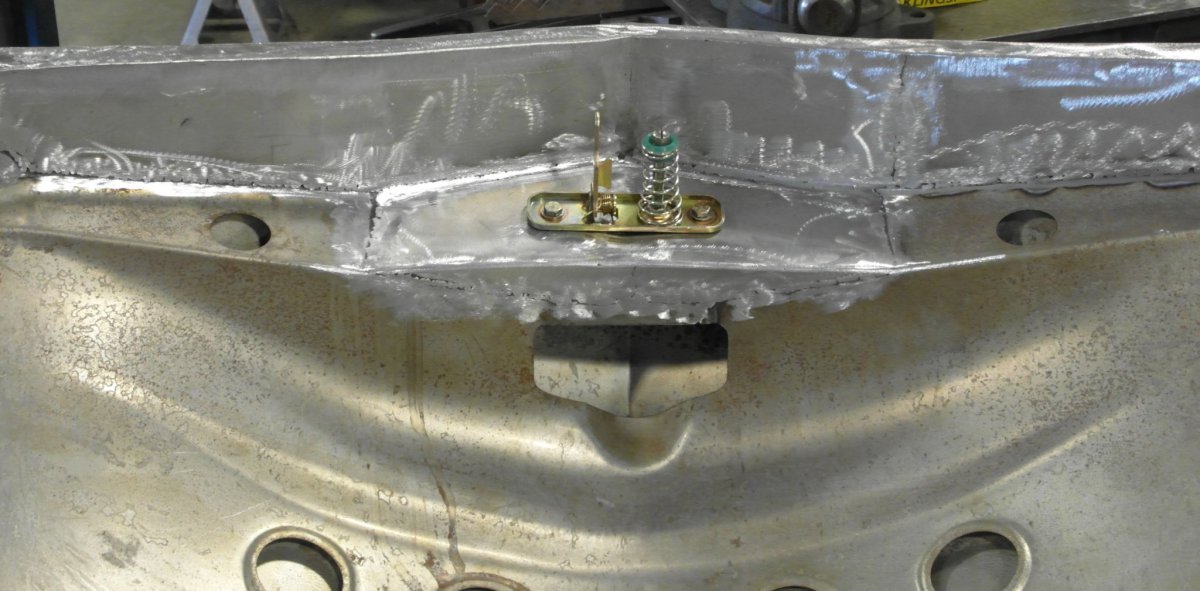

    We will put a 'push ****on' in the wall above the grille surround ledge and extend the safety catch arm below the latch deck so that it can be operated by the push****on when reaching under the lip of the released hood. The lower latch ***embly will be recessed mounted to keep the lines clean. Plate has been made to accommodate the recessed mount.

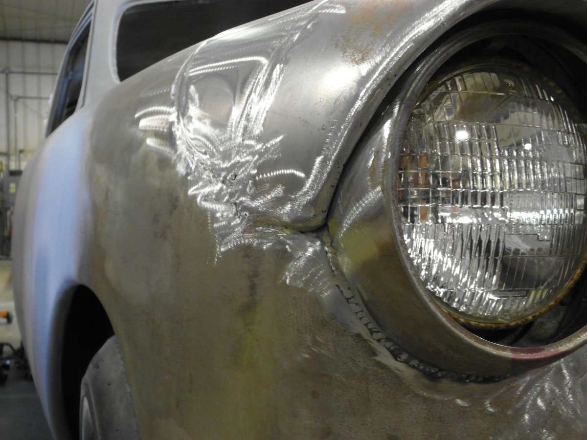

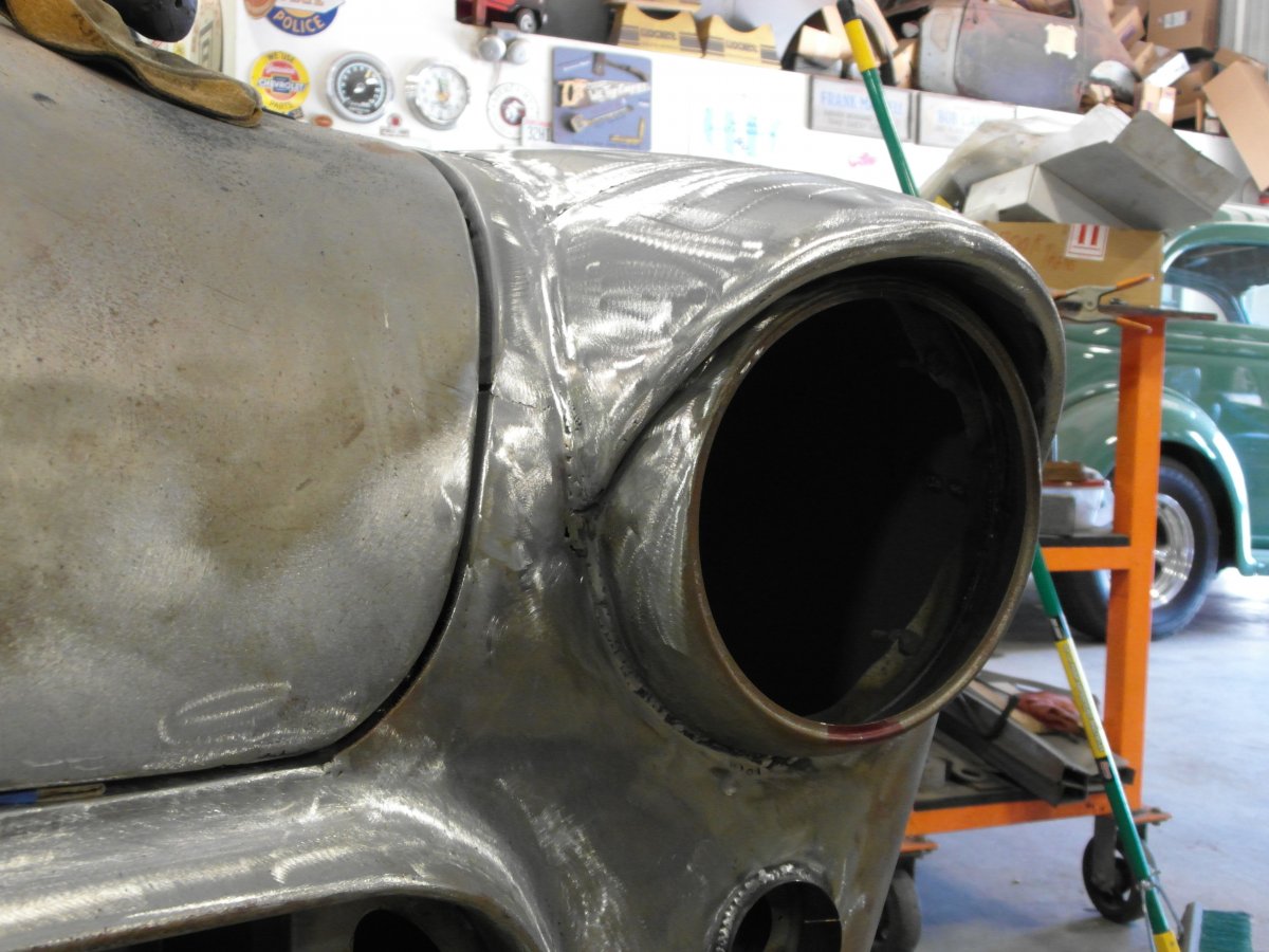

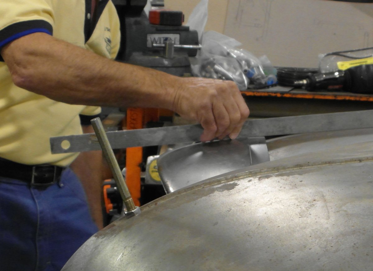

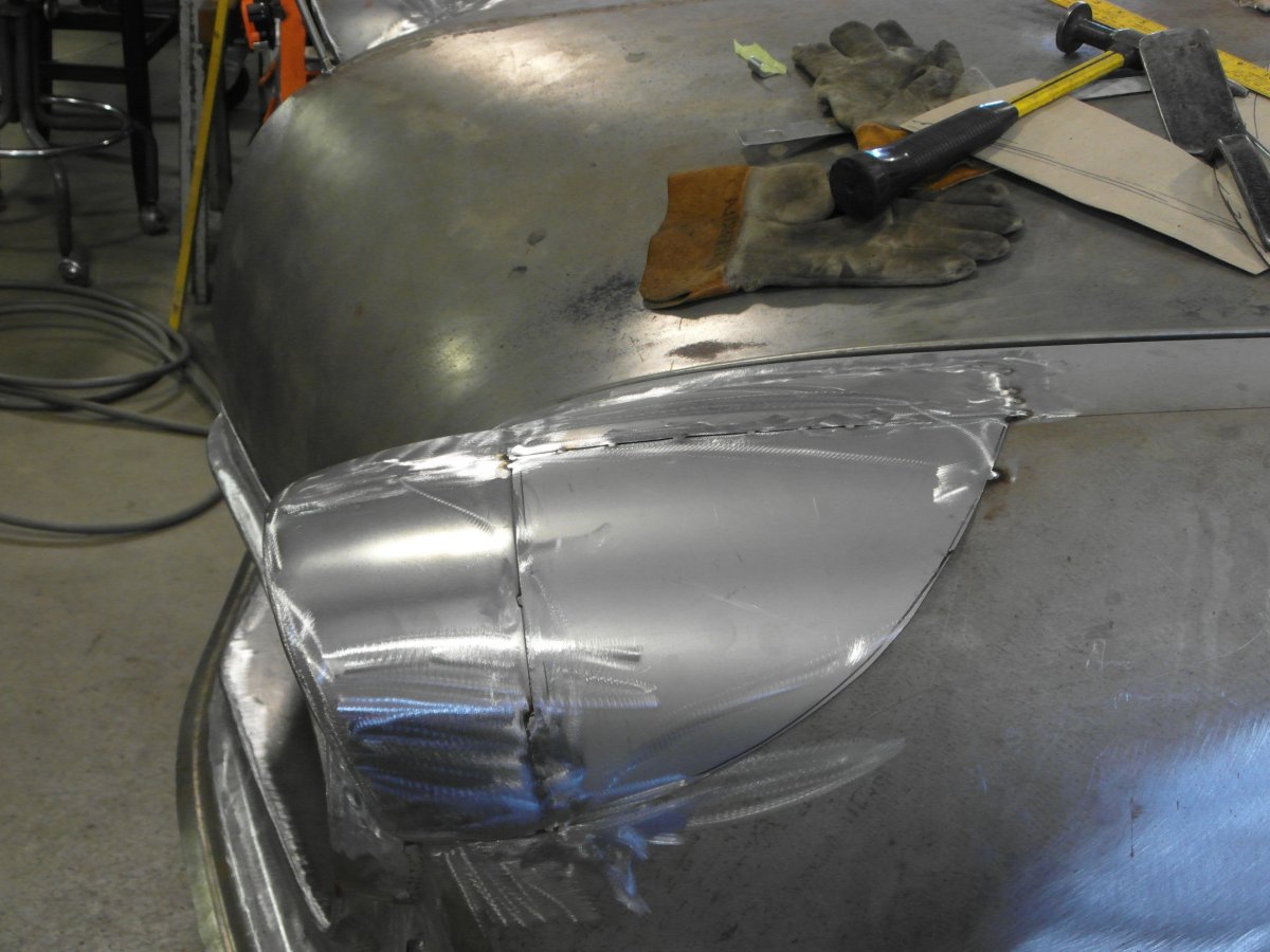

    Thanks guys for all your interest and comments. Here is the progress from this past week.
    The 55 Chevy headlight hood patches were split, inner portions welded to the merc rims and then the outers were welded back to the inners and to the fender. The extension patches were formed, fit, and welded into place
    Then the seams were welded up and the fender 'crease' was forcast to the new hood area and formed up with weld bead and grinding.

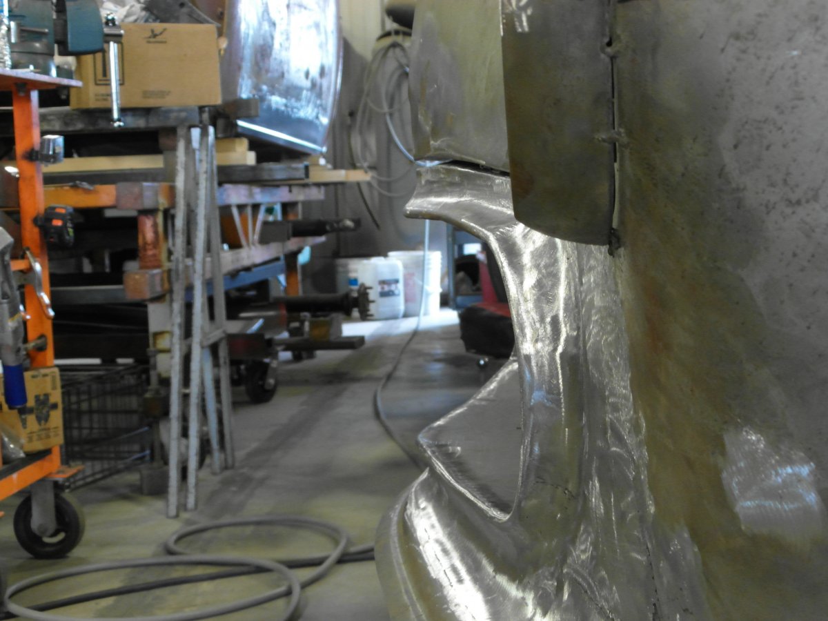

    The outer panel was contoured and ground to make a small 'flap over' area in the area just behind the headlight rims where the fender had a more aggressive roll in.
    We had a discussion about how to terminate the inner lip of the hood and more or less agreed that gentle convex contour was better than defining crease line or other ideas. That will be taken care of when Andy does all the final fill and prime work.
    The final look as we left this project for the day was very 'inspiring'.

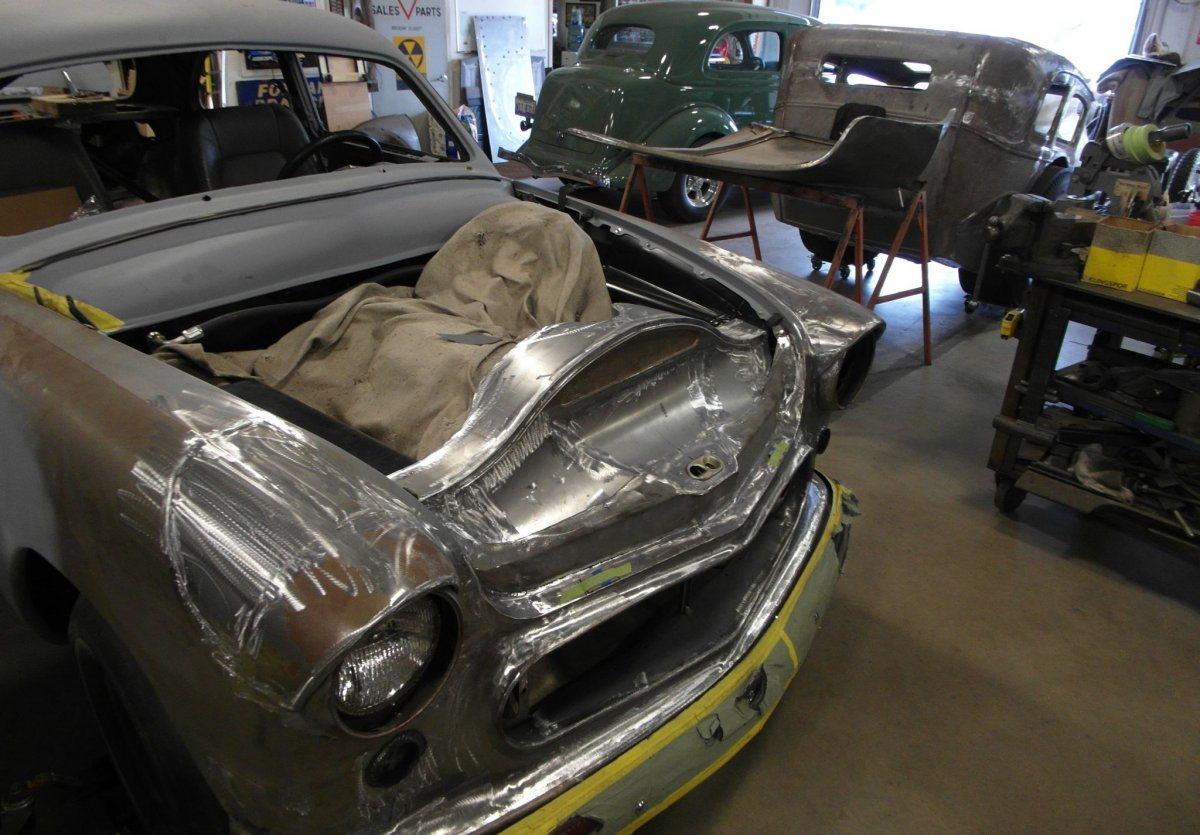

    With the headlight hoods pretty well under control it was time to go after the rest of the configuration of the hood latch and air baffle. After several discussions we decided it was best to 'flush' mount the lower latch part and move the pull cable stuff underneath. Looking again at the 'dress' panels Kerry and Wayne decided to 'drop' the original plan and expand to a full 'apron' concept. As it had to be removable for access to the radiator, transmission cooler, A/C heat exchanger they worked out mounting and t******* options to make it a 'swing out' type mount. Following are some pictures of the most recent work, taken this morning.
    Some dress pieces will be cut and fit around the hood latch (upper) to clean up the details for the mounting as well as 'beef' up the cross brace.

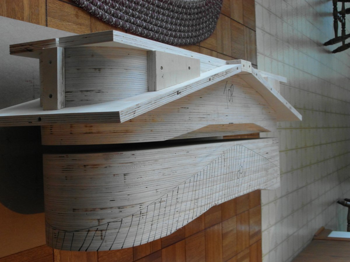

    Thanks for all you interest, pm's and emails. Yes, I would be willing to rent out the patterns used to form the custom surround and chrome trim ring insert to the surround, for the 57 Corvette grille. There are two patterns, one for the body metal to be formed to fit (block to the right)
    and the other for the chrome trim ring insert to be formed on. Kerry decided it was easier to use the chrome trim ring pattern to make the surround shell and to get the ring insert shape. I think that there was some interest along the way on the rounding of the center 'point' of the grille outline. We decided to set the pattern to 12 inch radius and transition the peak of the hood from the original 'sharp' point to a matching radius at the bottom of the filler (filling in where the bullet relief used to be). That, in our minds, made the transition from a rather pointed center of the grille to a rounded and better blending transition to the uniformly curved Corvette grille. Bob
    Please send a pm if you want to pursue such arrangement. Regards, Bob

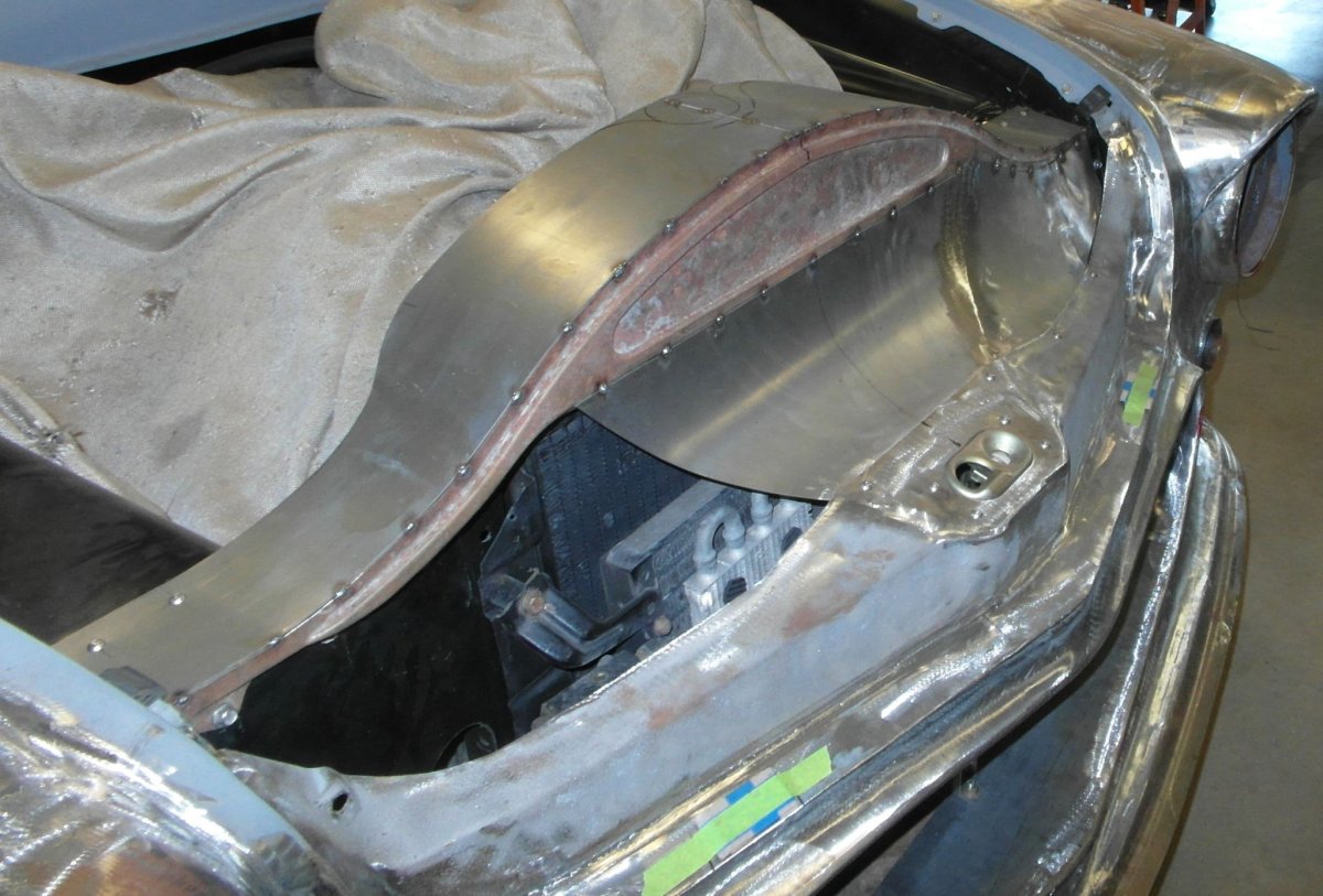

    Thanks for all your interest. Here are some shots that explain where all the air shroud / vanity cover stuff is going.
    First, front view of shroud ***embly mostly together (left side fill piece was pending decision on hood prop rod which was made this morning).
    From the rear you can see that the radiator cap is now accessible in the recessed area cut into the top band.
    From the side it all starts to make for a clean front area with hood up.
    Not a lot left to do on the shroud but will finish up with rear skirt pieces. This picture is Wayne holding one of the pieces into place for fit test.
    The hood latch area is now filled in and the last detail to be executed is a hole for the hood prop rod (will be on center line between the latch ***embly and the front ledge of the hood) to fit into. We will remove the old prop rod mount/pivot hole in the radiator side shrouds and the new rod will locate into the plunger hole of the hood latch receiver plate.
    That's it for this update. Thanks again for all your interest. Bob
