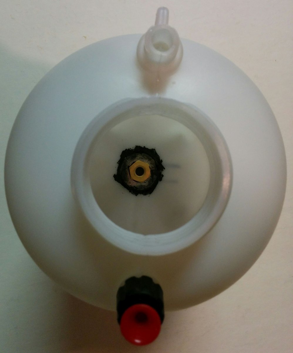

    I certainly hope you are all going to enjoy a great Christmas and peaceful new year. I got just a bit more done before it was time to shut down for the holiday activities. Turned out that the top opening of the tank was sized perfectly for a 2 inch washer with a 3/4 inch bore to take the fittings needed for the 1/4 inch air piping.
    Used the same washers on the bottom with some Permatex sealant as well as the gaskets that I cut out of the closed cell foam sheet. It got a bit messy trying to troll the squeezed out sealant around the inside washer but I kept at it till there were no fine strands sticking out.
    After the sealant dried I ***embled the rest of the fittings on each end using petroleum jelly as a lube, in case any of it was left behind to be in contact with the oil.
    Then I prepared the bottom rail with tabs to hold down (anticipating the pull of the air hose could be enough to tip unit out of base) to base, and completed the ***embly.

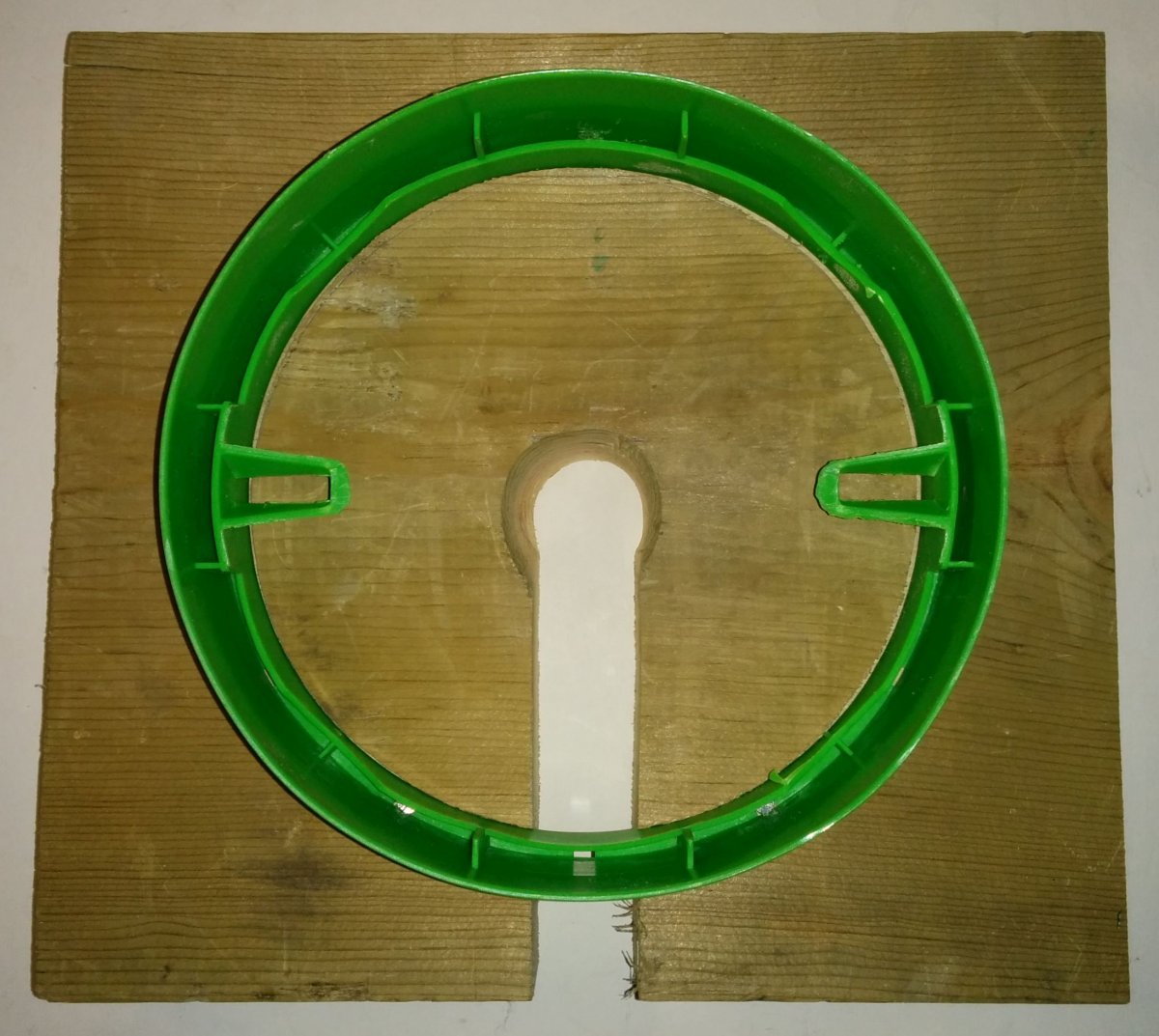

    The base is just a piece of s**** 2x10 that I had in the shop with a slot cut into it for the outlet piping. The original hose fitting was plugged with a br*** '****on' that Larry whipped out for me. In the week between Christmas and New Years I hope to get back to the quarter window seal fitting and will have some time to do a pressure test on this rig to make sure that it can be used up to 40PSI without any issues.
    Best regards to all and hope you have a great Christmas. Bob

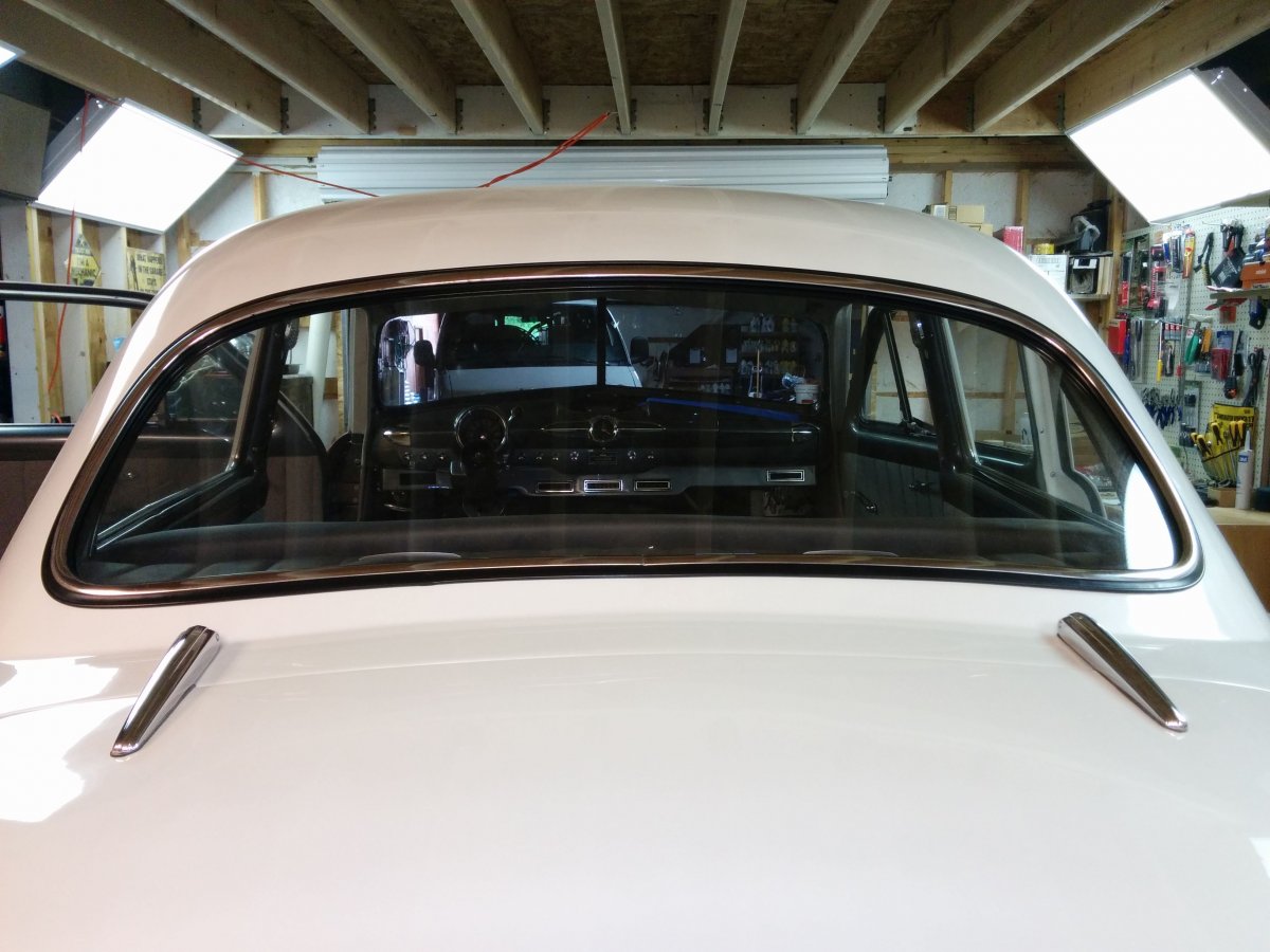

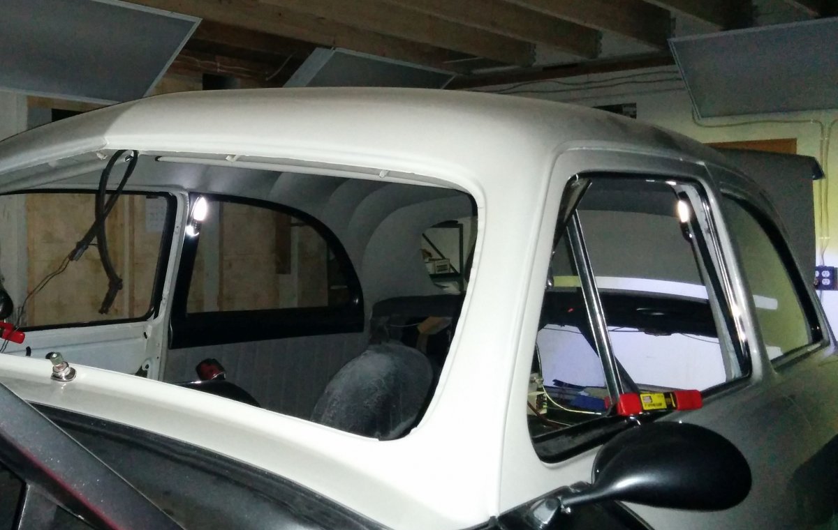

    Finally got the rear quarter windows installed. I just had to give up on using the Steelerubber weatherstripping that I thought was so good for the application. A great product but I was not seeing the solution after several weeks of coming back to how to fit the stripping to the opening. The problem is that the custom windows are 'full cut' and therefore the gasketing needed to ride up on the windows in certain areas (corners) and the relief space between the gl*** and the body metal varied a lot. Finally found an MD product (1033) that whipped the solution into view.
    This stripping worked great as it could be formed around the corners (following the outline of the opening that I had traced onto the windows with a grease pencil) with a couple of relief cuts to the outer rim and it was thick enough to make a sandwich that fit perfectly in the trough formed by the body metal ***embly.
    The windows went in after a small amount of t******* in the areas where the fastener pads for the vent and main channel mounting screws used to fit into the upper rim.
    I do need to figure out what to use to fill the gaps where the channel post used to fit into the window ***embly as the stainless trim mounting rail was bowed out to accommodate the extra thickness and not originally noticeable due to the rubber seal flaps that lapped over all.
    I'm looking for epdm rubber stripping that can be trimmed to fill the gap, or a tube of sealant that finishes to a dull rubber look. Perhaps someone can recommend where to look or what to look at. Thanks for your interest, regards to all. Bob

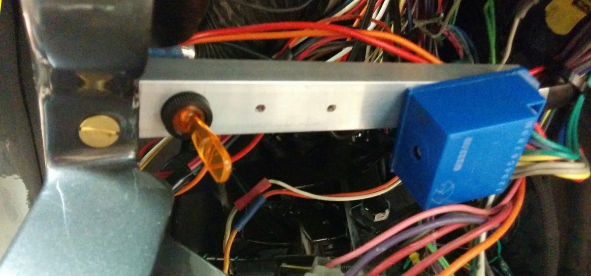

    Well,,, this was a week to 'live and learn' or perhaps pay attention and learn. I am trying to check out and power up all the electrical circuits and made a really dumb mistake. I thought it would be a good idea to put an illuminated switch in for the manual fan power (radiator fan). I had combined the old manual fan relay power with a diode bridge to the AC clutch power lead from the temperature controller. I got a bit ahead of myself when I ordered the illuminated switch to replace the old steel bat handle switch that was under the dash. I bought a switch that had the LED for illumination wired from the wiper to the NO pole and required putting a ground to the NO pole. On proper illumination switches the ground pole is to the second section (dpdt type base). The manual control worked fine and the switch lighted just as expected. However when I tried to check out the AC circuits and cycled the controller to the on (clutch power) position, the diode bridge from the manual switch circuit to the AC clutch circuit provided a short circuit path back to ground and I ended up with some very warm wires.
    I have now ordered a new, proper type switch to take care of that problem and still have an illuminated switch when in manual mode. While waiting I have removed the AC controller box (blue box upper right) and am going through the circuit to make sure all is ok.

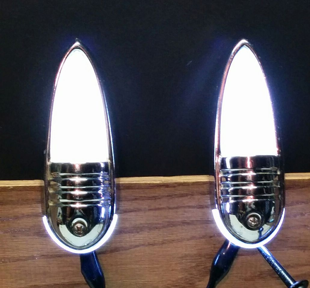

    So,,,some may remember that I changed the pillar lights out from type 87 bulb (that keeps melting the plastic lens piece) to LED to keep them cool and brighter.
    Last week, while checking out the fuse circuits, I got the box of prepared pillar light parts out and then I remembered that I was going to do something about the ***ist straps. I had decided that I did not want them on the rebuild, but had not done anything about the gap that removing them left in the chrome cover for the pillar light (bottom was slotted out to allow the straps to anchor on the mounting bolt (1/4-20) at the base. I talked to Larry about it and asked if he could make a Delron (black plastic that is polishable) filler.
    Larry called a couple days later and noted that he had measured the slot up and 3/8 sheet stock would be perfect for the filler piece but he did not have in Delron. He did have acrylic (clear stuff) and said that he could pop them out of that if I wanted to paint them. I agreed but when he brought them over I took a look and realized that painting them would be wasting an opportunity. It took me a day or so to work out using up more of the left over LED strips that I had and decide how to finish the acrylic but here is what I ended up with.
    With the bench lights off, I get a nice spread of light from the bottom piece and believe that it will work very well in the car to help illuminate lower area for anyone needing access to the back seat/floor. Bob
    daddio211 and cool57 like this.

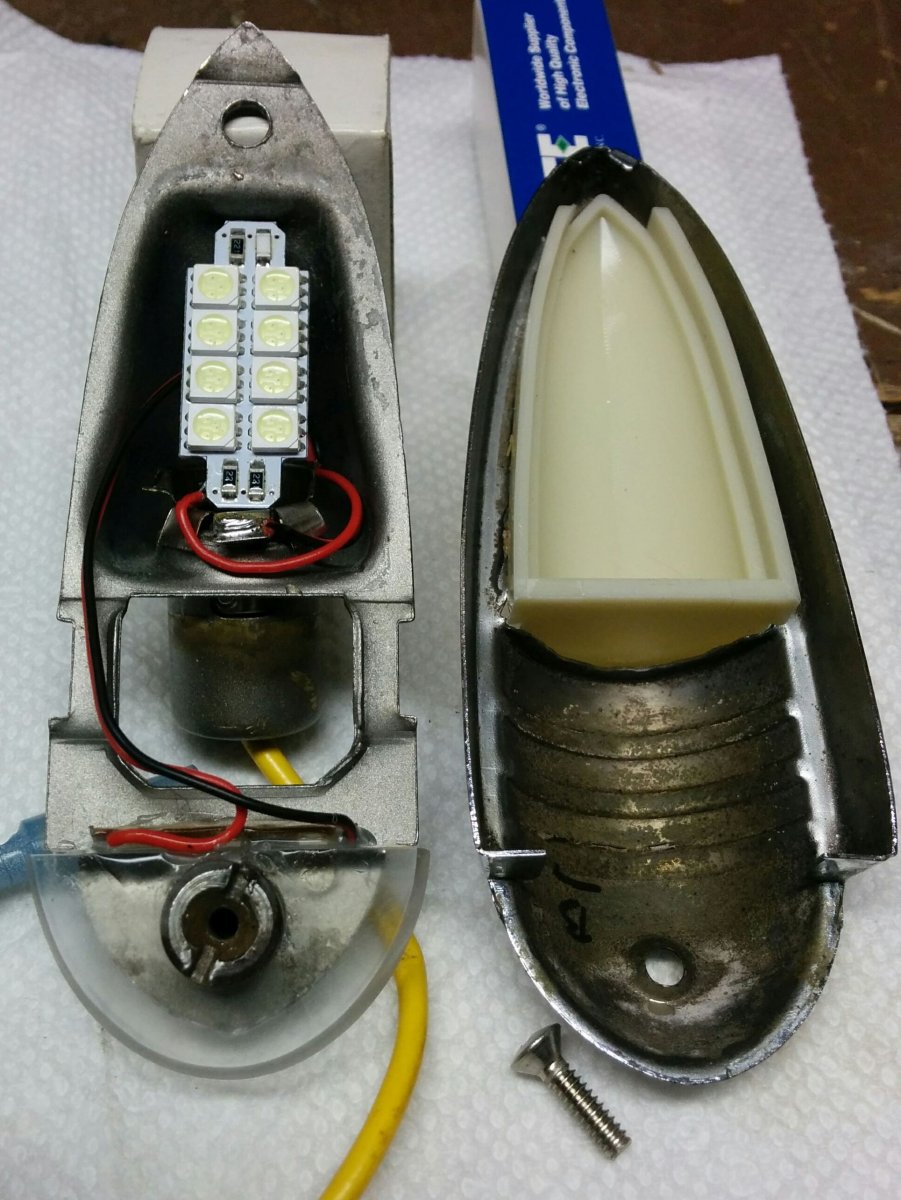

    OK Eric. Hope that I don't upset anyone with the details. Here is the build up. Quite a while back I posted a tech look at converting the pillar lights over to LED and this was the result of that work.
    Taking off from there,,,,, when Larry gave me back the lights with the acrylic pieces added, I decided to look at the inventory of LED strips (most of those you can cut in three LED segments and attach wires to each segment.
    I tried a few different types and decided on the one sandwiched in between the pot metal weight and the acrylic piece in the picture above.
    After testing with power attached I was happy and then got to figuring out how to attach.
    I used super glue on the top of each LED to bond optically close to the acrylic. When that dried, I used silicon sealant (gl*** clear) to strengthen the bond of the LED strip to the acrylic piece. Looked over possibilities for connecting the power leads and decided that direct to LED array that replaced lamp was better than 'T' connecting outside of ***embly to the power feed to pillar. Took just a quick tap with a hot iron (mini tip) to add new wire connection to the existing (tip of power wire) connection and the socket ears were tinned br*** so they took the ground wire easily.
    Dressed the wires so that they would not get crushed by the lens cover and retested (posted that picture first) after putting all together.
    That's it in a nutchell. Have a great weekend. Bob

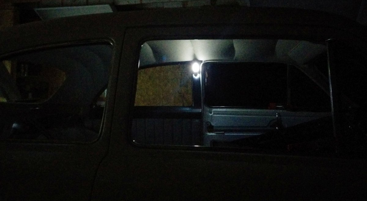

    Pillar lights are now installed and tested.
    Quite happy with the light spread from the bottom acrylic pieces.
    They show up from front/rear end better than I thought they would

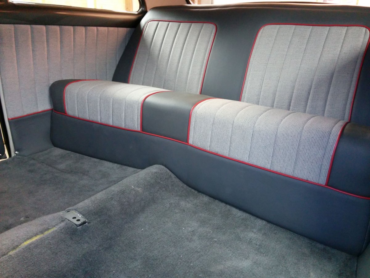

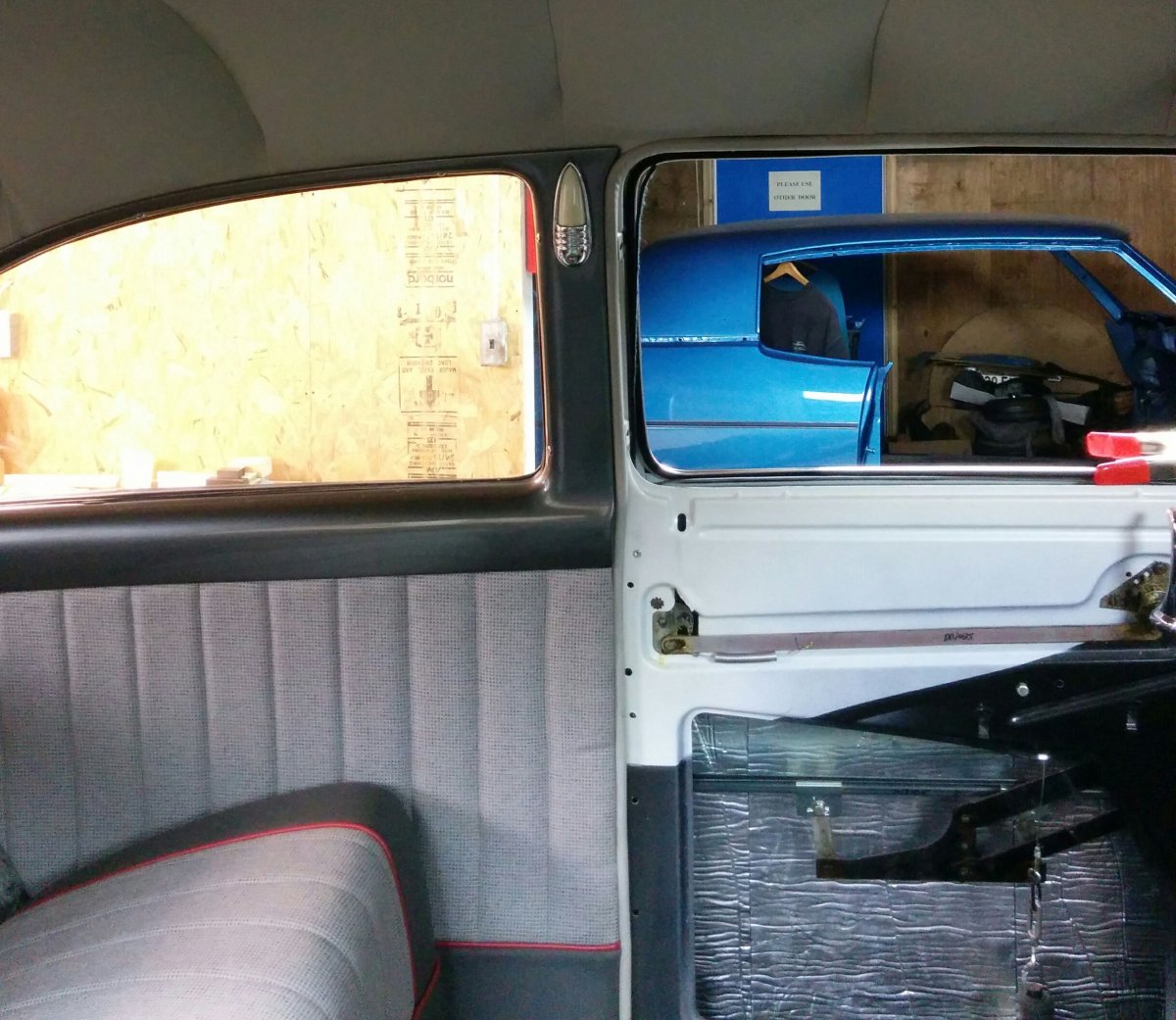

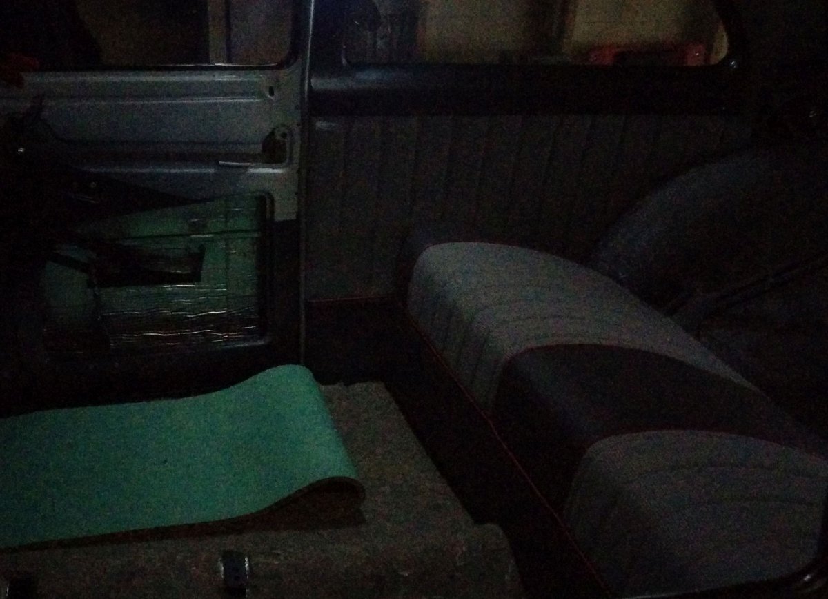

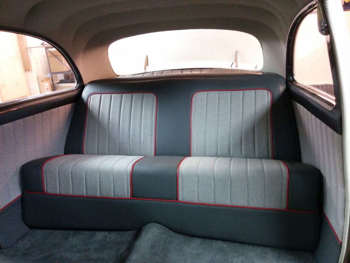

    Have just come out of the heavy part of semester for CLR and getting some time in on the car for a few weeks till things load up again. Found an interesting problem when I tried to put the doors together. Either the 50 window frames are deeper than the 49's or the 49 doors were not not as deep as the 50's because when I put the frames on and tried to fasten down the window was being pinched due to a narrow gap. This also could have been because the 49's used fabric fuzzy strips while the 50's used stainless backed fuzzys. No matter what the reason, I had to find a work around. After going at the problem from several directions I decided to space the frames away from the mating surface on the doors by about 1/8 inch. Then I used dense rubber matting (1/2 inch thick) strips of about 1/4 inch width (cut with our electric kitchen knife per advice from my 'woody' friends next door) and stuffed the strips in the gap before pulling everything down.
    That worked out well and, in fact, the window frame pushed up against the wind lacing better than before. Today, I finished getting both doors ***embled, speakers installed, radio fully tested, and also got the pucker out of the package deck with a riser panel under the center area.
    spring clips on the vent windows due to still trying the get the rubber to set properly before I put the handles on the vent windows. I have new black knob (to match the dash knobs) cranks for the doors but did not get to them yet.
    Started working on the adapter for the MOMO steering whell. Larry is machining up a new lock lever for the telescoping steering wheel and I will polish that when he is done so that it matches the rest of the hub.
    Carpet was pretrimmed today and will be bound for final installation in a week or so.
    By the way,,, I changed to black oxide hex drive screws at front and rear of door frames (had to add the rear holes and rivet nuts) so that they would not stick out so much. Original Ford frame colors were much lighter gray and the stainless hardware was not so noticeable.
    The picture above was taken while I was still struggling with the window cramping issue so the vent seals were not set properly hence the strange rollover in view.
    Almost forgot the 'pucker gone' shot of the package deck. Here is that 'solution'.
    Thanks again for all your comments and suggestions. It seems that we may get this car on the road by summer.

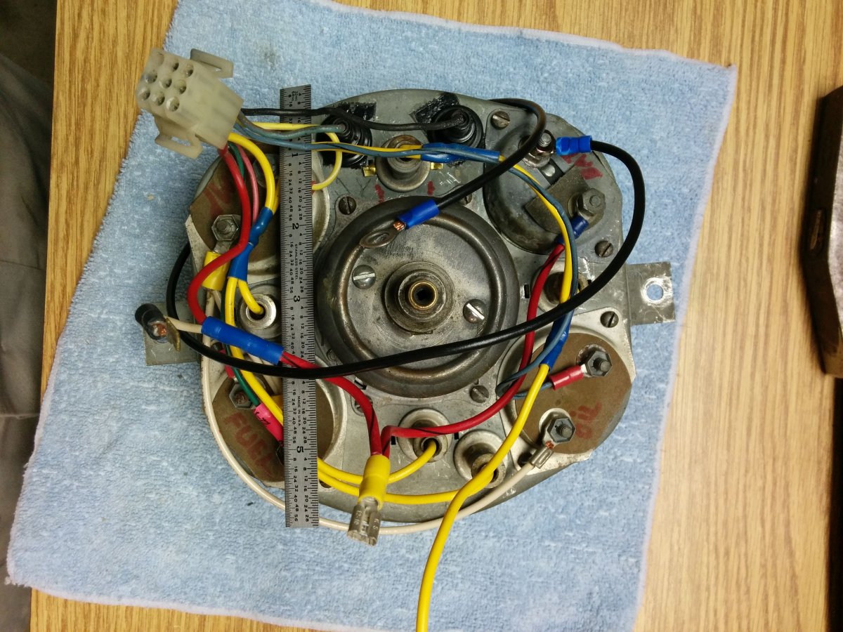

    Above is the ruler positioned between the dash stiffener rail and the body ledge that the dash is attached to and even with the ruler slanted there is less than 5.5 inches to work wth.
    Clearly the instrument cluster is close to 6 inches measured vertically and diagonal length form lower rear bottom to upper front top (bottom is away from us in this picture) was close to 7 inches. So I knew that the cluster was going to have to be tilted into the upper clearance space and the bottom swung into position in the cavity. Could not get it to go! Gave up and went home for the day. Friday morning after about 6 cups of coffee and a lot of thoughts about having to drop the dash just to put the instrument cluster into place,,,, I realized that if I unplugged the high beam lamp socket and the upper cluster lighting socket there might be a chance that I could tuck the upper cluster housing/frame and Fuel/Oil gauge circuit boards into the cavity between the body ledge that the dash mounts to and the inner top space of the dash cavity. Pulled the sockets put some masking back on the stainless dress rim, and in it went. UNBELIEVABLE! I didn't even have to push or pull on anything.
    Spent the next hour or so thinking about all that I have forgotten over the years and cleaning up the mess of several days of frustrations. Good news for the day is that Sheldon is planning on finishing up the upholstery modifications this week coming and that means that I can finish up putting the interior together.
    Hope you all had a great week and a lot less frustrations than I did. Regards, bob

    Sheldon finished up the upholstery and we did a trial fit of the back seat.
    Pulled it out after fit check as the guys from Rockford Auto-Gl*** will be here Tuesday morning to install the front and rear windows. RAG has a guy that specializes in cl***ic car gl*** work and he will be doing the installation.
    They "paddy caked" (their expression not mine! for steaming) the fabric areas and carpet areas that had 'puckers'.
    And then I got everything ready for the window exercises.
    Hope you all have a great weekend. Regards, Bob

    OK,,, gl*** is in. If you noticed the back seat fit in the picture of previous post, it would not go down on both sides and lock into the latch ramps. If we put one side down the other side popped up off it's ramp. While waiting for the gl*** guys, I looked the problem over a little better and confirmed that the crown of the tunnel was interfering with the seat positioning and the seat was tettering over it like a pivot point. Looked around the shop and found a piece of 7.5 inch pipe split down the middle, put a piece of padding and carpet over the pipe and it fit into the arc of the tunnel relief perfectly. Got Tracy to let up on his woodies (got a really sharp 48 going together now) for a bit and help me coax the seat frame to a bit more of a curvature by putting some force (we sat on the ends and bounced a bit) to the frame and it bent just right. Had to trial fit a couple of times so that we did not over do it but here it is.
    A few issues popped up after the windows were in but nothing show stopping. The guys from Rockford Auto Gl*** worked their tails off for 2.5 hours to get the windows in and seated to their satisfaction. I thought they looked great well before that, but these guys are really tuned into the cl***ics.
    I have some fitting left to do with the center post rear view mirror/map light setup but Andy will come back when I am ready to put the post into place (his request, to make sure I don't screw up something) and that will finish up the gl*** work all around. Larry and I looked over the translator panel/wire bundle from the fuel control system eyesore and figured out how to get a cover fit on the area to mask off the ugly but still allow air flow. I will work on that next week while getting the engine prelube going.
    Hope you all have a great weekend, I am off to the grandson's last soccer game for this season. bob

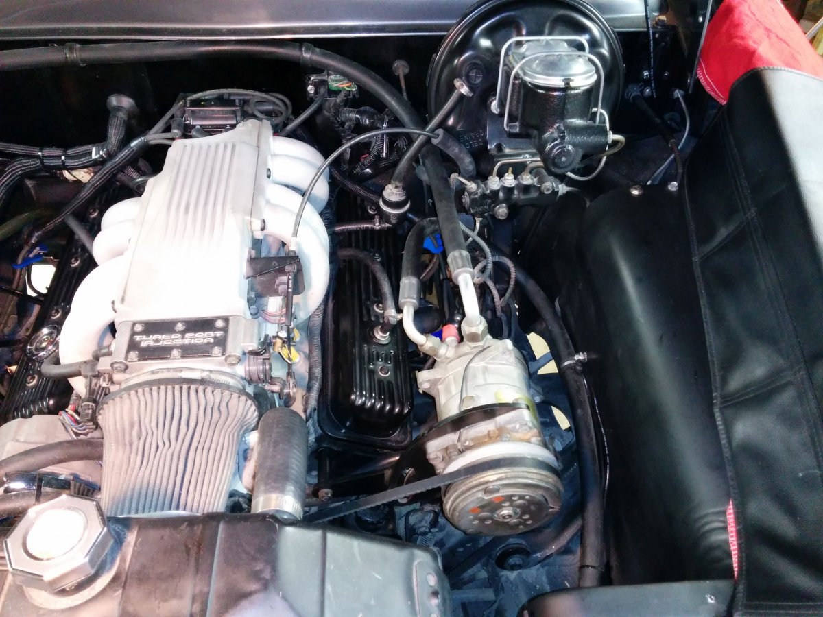

    Did you ever wonder if some guys are just so strong that they don't realize they are cross threading fasteners. In my case 4X! Somewhere along the way of the car to me, someone apparently did not remember that US car manufacturers were slow to convert to metric and managed to put 4 M8 bolts into the fan mount extender. Took me a bit of time to figure out what the original threads were (used thread gauge, inspection mirror and lamp to work on back end of holes in the water pump flange) and then some more time to carefully retap the holes to original spec. so that I could put proper bolts in the flange.
    That done, spent some time getting the plug wires properly distributed and decided to sheath the run from distributor to first loom bracket. Am almost ready to put fuel in the tank, test the pump, purge the air from the line, check the fuel pressure, and see if the engine will fire up. When all is OK, I will put on the new air filter and extension (cover) of the plenum over the distributor.
    While working on the plug wire looming I noticed one of the fuel lines up against one of the 'A' frame bolts so also took some time to redress and cushion the lines against abrasion. A week of progress just would not be the same without a mystery. While reworking the mounting for the translator panel under the dash (longer bolts so that we can put a dress cover over all), one of my wrenches went missing. I mean missing! The shop is probably more organized and straightened than it has been for some time as I just could not find that wrench. Tracy took a break from his '48 woodie project and stopped over to see what was going on. As I expressed my frustration about the missing wrench,,,, he asked what were you doing when it went missing and I went through the whole timeline,,,, yep,,,,, that's when i realized the last time I had seent he wrench. Did some digging and sure enough an expanded understanding as to why I have found, over the years, wrenches and other tools in and under things of other's cars. Here was the solution to my mystery.
    Hope you all have a great week. Bob
