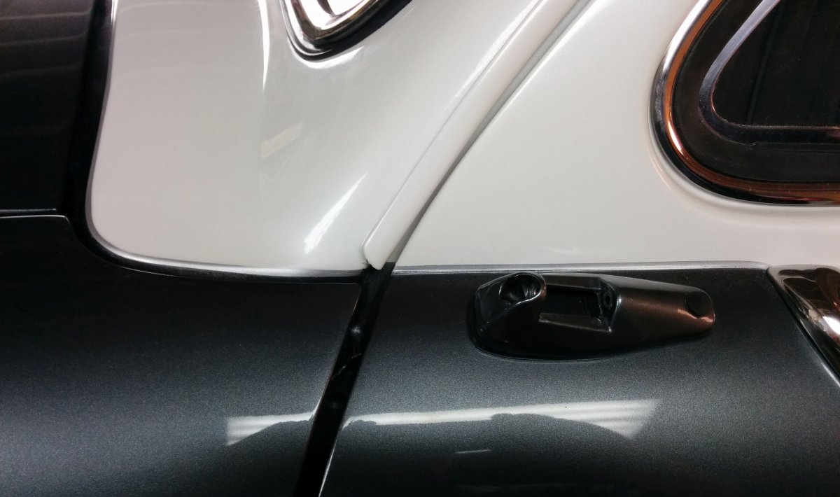

    Had issues with the new receiver location (for the key remotes - doors and trunk) as in the center of the dash there was so much good old time soft metal (lots of iron in the sheet stock) so I worked out the issue by stringing the antenna wire out of the lower windshield center clip and up to the rear view mirror, with a short piece of 2mm elastic cord to keep it taunt but allow it to be unhooked easily.
    Finally got the car off the blocks, and the tires back on the ground Tuesday and after some mop up work and final adjustments I was able to take it out of the garage, yesterday, and around a few blocks to test drivetrain, brakes, and check for rattles/clunks. It was very rewarding to see it almost done,,,, but seriously I did not remember it seeming so low to the ground.

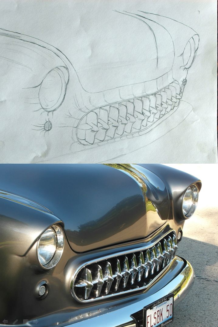

    cleaning up a few minor things and do***enting parts of the build. I realized that I had not posted shots of the interior in it's finished condition so here are a couple of those
    Did some follow up on sketch to implementation for various parts and am quite happy with the results. Here is one of them in visual reference.
    Have entered the car in it's first show on September 10th. and getting stuff ready for the show and some cruising night activities locally. Hopefully we can have some fun before the snow flies and car goes back to garage for the winter. I am thinking of switching the injection control system over to Holley HP series this winter so I can access and modify/tune via laptop.
    Regards, and best wishes for all your projects. bob

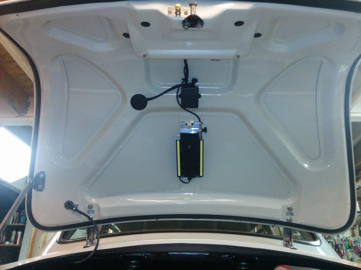

    Hi All. Sorry i have been absent for several months. Got distracted with a rebuild of a rental home - - - not nearly as fun as working on the car project! Finally got back to the car last week and have been taking care of some cosmetic stuff and getting car ready for our first full show season. I had noted above that i was not happy with the backup lights as they looked a bit crude, and i had ordered some alternate versions to try. The test went well and we have now changed the backup lights, under hood, and trunk lighting to the new style strips. Here is a shot of the backup lights showing that the new lower profile strips have tucked all inside the surface envelope and put a little more respectable appearance to the license plate ***embly.
    Here is a view from side angle.
    Trunk and under hood lights look better to my eye also.
    New result is more uniform and brighter lighting over all areas.
    While working on items i found a coolant leak inside the p***enger compartment (heater hose to builkhead fitting hose clamp not fully tightened or hose squished down over time) that has put a stain in the upper lip of the carpet front of the p***enger seat. I bought some fabric coloring (like paste dye) from Hobby Lobby and will try my hand at spot treating the stain (about 1/2 inch wide and 4 inches long vertically) with this product after I try on a test piece. Finally figured out how to adjust the coverage of the backup switch and have eliminated the need to hold the shift lever up a bit to keep the backup lights on. I also found and fitted a better brake pedal return spring so the brake lights do not 'flicker' on when going over rr tracks or surface bumps. Car should be ready for the Cl***ics and Chrome car show (2 day indoor show - one of the best venues in this area) May 6 and May 7. Have a few details left on drivers door (fuzzy strips that came loose and window lift bar that slid out of place) but don't see that as major challenge. Looking forward to getting some time on the injection system (that was my goal for past winter months) but that may wait till fall since the show offerings are starting to increase and I don't want to take a chance of putting the car out of commission with harness changes and fuel tank modifications. Best regards to all. Bob

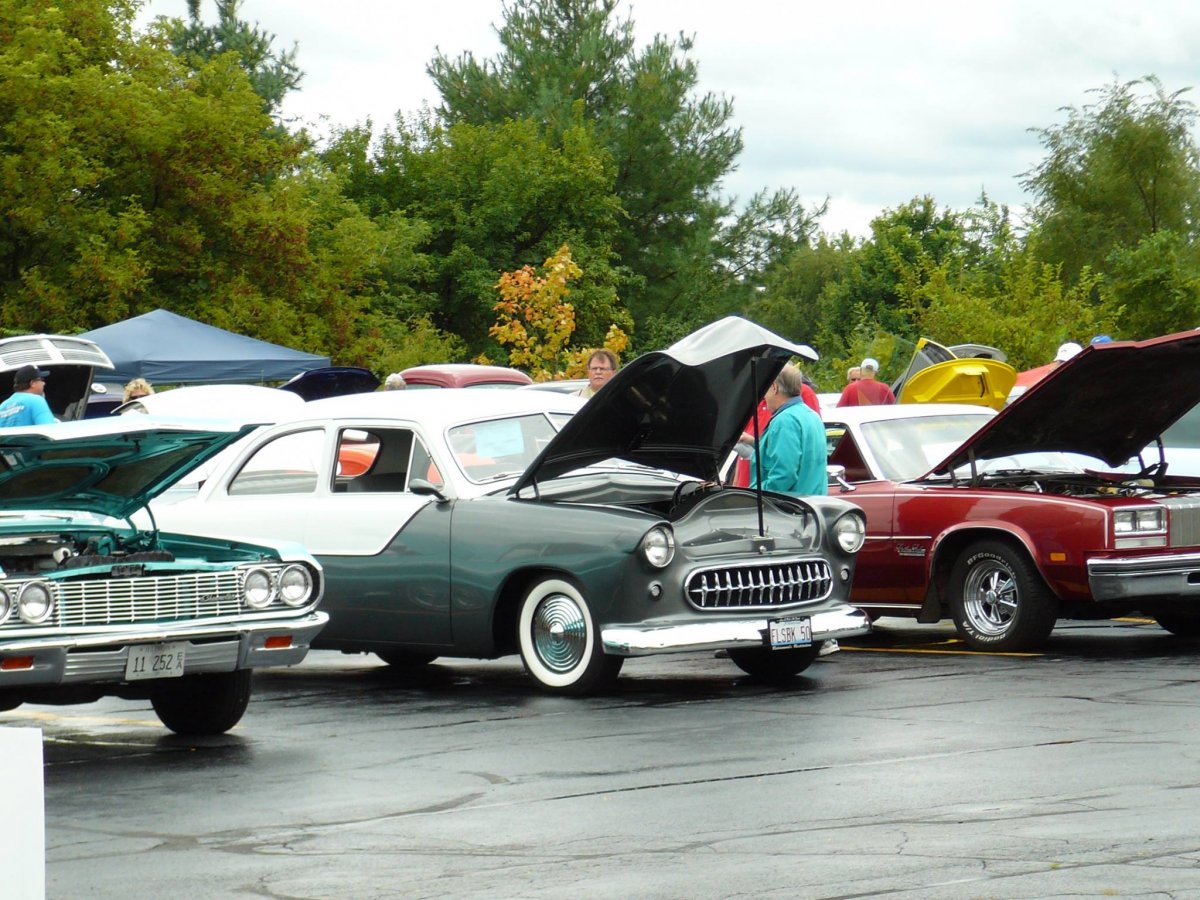

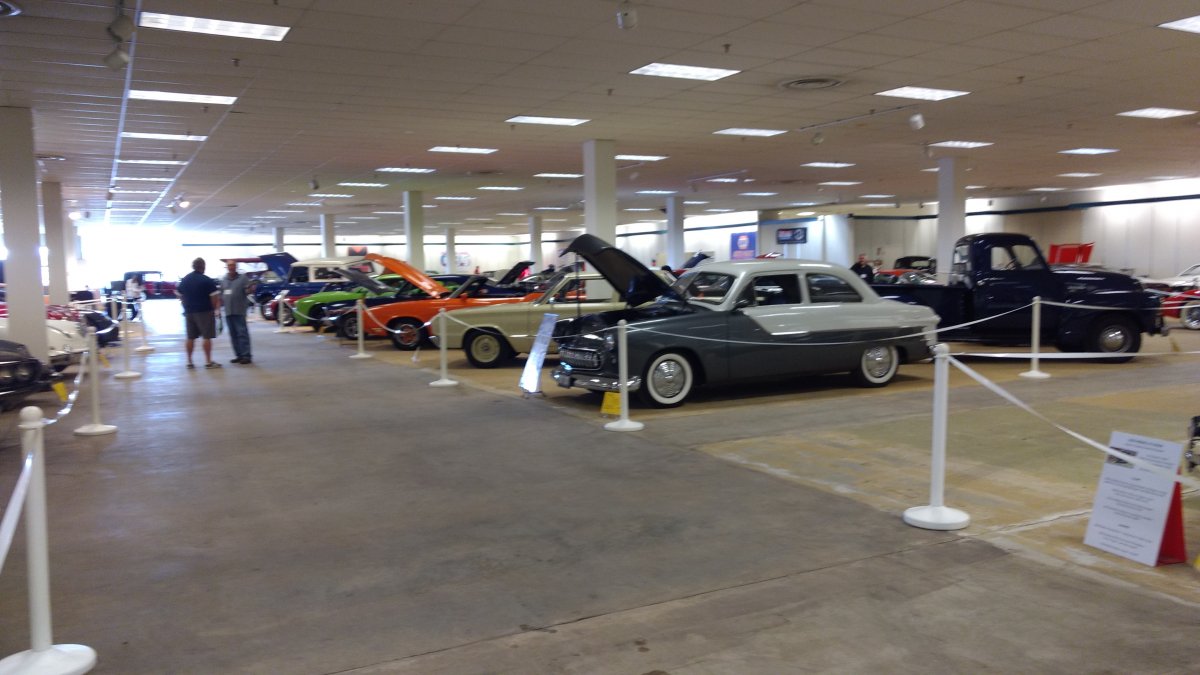

    Made it! Been a busy couple of weeks but took the car over to Cl***ics and Chrome car show (indoor in old mall store) this morning and it is reasonably all together. We have replaced the LED stuff as indicated previously. I had found a stain in the carpeting due to the coolant leak at the bulkhead to heater hose connection
    My wife led the way to Hobby Lobby fabric dye department and i found the perfect stuff for touching up spots in carpeting. The following picture was taken while i was waiting for the coloring dye to dry (it darkens ever so slightly and then dulls off a bit) but wanted to get this picture before i put the baffle back in place.
    Did get everything put back together, got a good coat of Mequires Show glaze on the car, and tried the Mothers chrome shine / polish for the first time.
    When i got to the show, there was some confustion that ended up being a bit of luck for me as the car ended up getting a corner spot on one of the main aisles.
    The show opens tomorrow at 9AM, and i am looking forward to this event as it is the first show of the season in this area, a two day indoor event, and already a ton of vintage and exotic cars in the building. This makes the last four years all worth while. Hope all your projects continue toward a path of completion prior to depletion of all other things. Best regards, bob

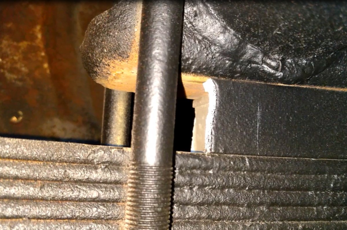

    We got through Cl***ics and Chrome car show and decided to get the alignment checked on a 4 point system rack. Barely got started when Ray (Ray's alignment) said come on over here and take a look at this.
    OK... so now the sequence of events makes some sense. We did not notice any crabbing last fall but just before we put the car up for the winter, we took it to Andy for paint and panel touch ups from final ***embly goofs. and then had the brakes checked and went through the issues with vacuum levels and modified arrangement for higher gain master cylinder. By the time it came back to the garage, winter was knocking on the door and we put it away without a lot of checks. Apparently all the brake lock checks and other stresses either finally broke off the cracked lowering block or cracked the block and spit it out. After Ray showed that to me i agreed to take the car back to the garage and work on replacements. There are no 1" lowering blocks for 2" springs and Ford keying available on line so talked to Larry and he agreed that if i could get the good one out, he would make a couple replacements for me. The replacements will be solid aluminum so we won't have to worry about this kind of non-sense in the future.
    The extraction process was far simpler than i had imagined. Talked to Andy and he suggested that i jack the car up to the point where there was just a little spring give left and then break the nuts loose and see if the axle would pull away from the blocks,,,, I did, and IT did!
    Once the axle was free, i just kept wreenching on the nuts till there was enough space to wiggle the blocks out over the pegs (and under the dimples)
    Had noticed that the block on the drivers side was cracked also and was wondering if it would fall apart when i started wiggling the block to get it out of the nest.
    The block cleared the peg and dimple without further issue, and came out all in one piece.
    These blocks were really made from some **** material. Don't think it was pot metal, but if it is aluminum, it was the part of the aluminum billet that they normally scalp off and use for abrasive. The blocks that Larry will make will be solid and quality aluminum bar stock source with pins inserted for the pegs. Hopefully will have this all done in a week or so and be able to get to the Belvidere Heritage days car show on the 24th. Regards to all. bob

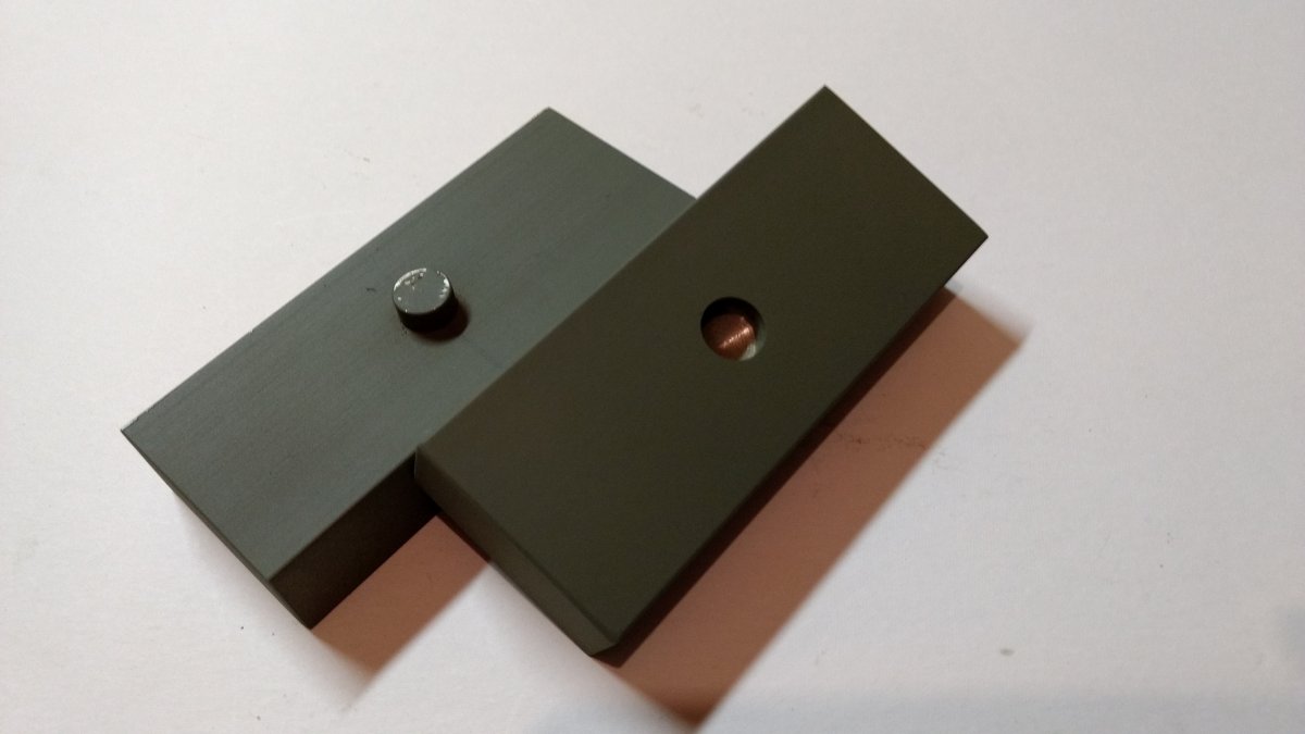

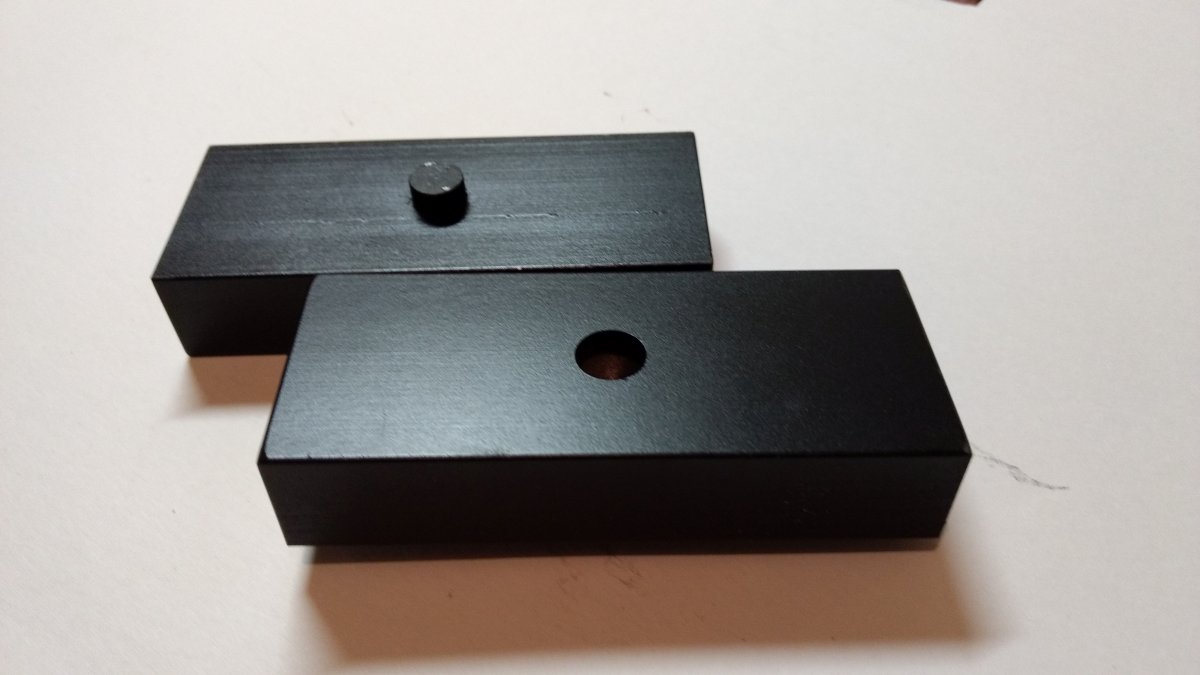

    OK.... so i got distracted with some domestic chores and decided to talk to Larry Alex about the blocks and when i would like them. Larry informs me that he is working on them today due to a hold up with one of his customer's jobs. This afternoon, he calls and says,,,, your blocks are ready,,, are you at the shop??? my answer was no but i can be there rather quickly and i made a dash for the shop to meet up with him. We checked the block fit to the side that i had opened up and all was well. I picked up a can of self-etching primer and brought my can of Tough Stuff black semi gloss paint home to work on the prep of the blocks.
    Here is a shot before any work done.
    I knocked the corners down so there would be no chance of sharp edge against the leaf spring face
    and scuffed all surfaces for better adhesion of the primer. Note the second block has offset hole for spring nib. That is a fall-back in case the crabbing is not resolved with realignment. Probably will not need to go that route.
    Got a good coat of self etching primer on the blocks and let them dry in the sun.
    after they dried put a good coat of Tough stuff satin black on them so they will match the rest of the rear axle components paint as closely as possible. They are now setup for drying (should be dry enough sometime tomorrow and then i will get them installed and get the car back to Ray's for completion of the alignment.
    Hope you all have a great weekend. I had thought about getting the car into the Rokford First car show this weekend but will not have it back together yet,,, and probably that's a good thing because the temperature and humidity are both supposed to be in the mid 90's. Regards, bob
