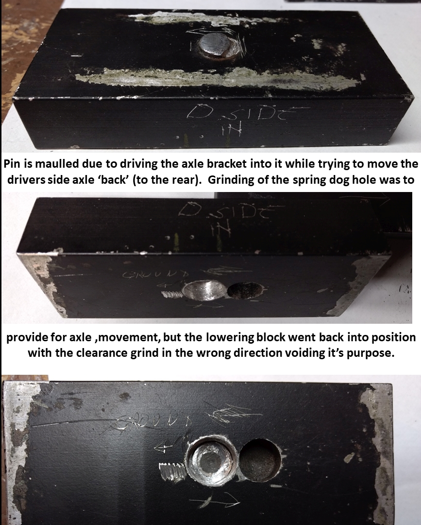

    Ray's Alignment took the car back in on Tuesday of this week, and we got it done right this time. They had to move the drivers side rear axle mount about 1/8 inch aft (used die grinder to oval out the hole as the provided 1/2 inch alternate mount was way too much of an correction) on the spring tab and the p***enger side axle mount about 1/16 inch forward in order to get them both to come into less than 0.01° toe. Actually when they finished locking everything down the drivers side was at 0.000 and the p***enger side was at +0.005°. Car is now traveling down the road with no perceptible crabbing and actually handles better than ever. Due to some complications will not be able to get the car to the Belvidere Heritage show this weekend, but will be picking up on the scheduled events by end of next week. Thanks for all your interest, and best of luck with your projects. Bob

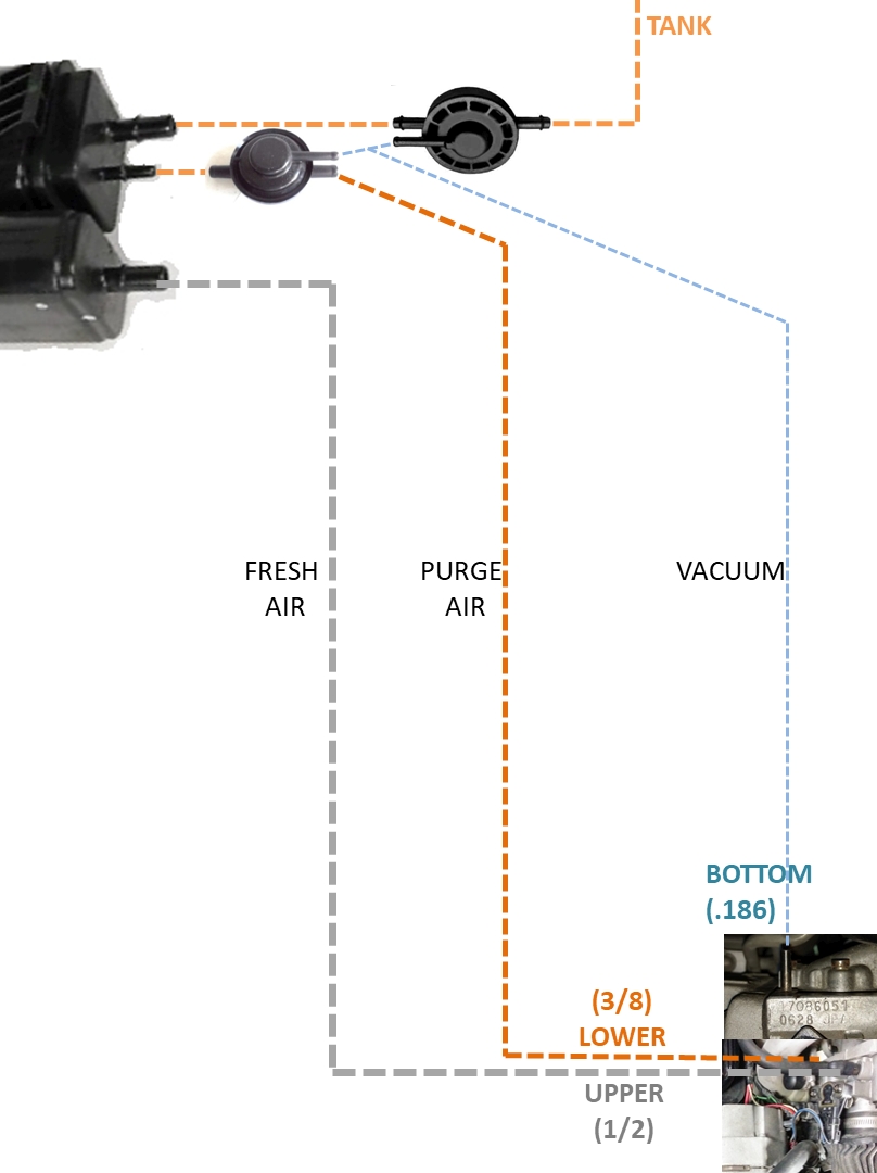

    Have gathered up and ordered all the parts to do the vapor control - tank pressure relief project. Here is a shot of the main components for the switchover.
    The small K&N filter is to replace the fresh air to valve cover plumbing so that the fresh air from the throttle body (upper) port can be sent to the carbon canister in case there is any residual vapor pressure from the tank with engine off the vapors will be ported to the air intake of the throttle body instead of directly to atmosphere. I found a canister that will fit in the cavity just in front of the firewall, over the p***enger side wheel well inner fender. The fuel filler neck has been fitted (thanks to Andy Didio - Suicide Axle) with a vapor breather tube. The pinched area on the tube is additional measure to resist liquid fuel (splashes) from being drawn into the vapor line. This morning I used rust inhibiting primer/paint to seal off all the bare metal area that was used to prepare for the welding of the tube. Hopefully, by mid week, the Parker vapor hose i ordered will arrive and i will be able to proceed with the installation. Larry will be making a mounting platform to hold the canister in place. Here is a shot of the approximate position that i plan on installing the canister.

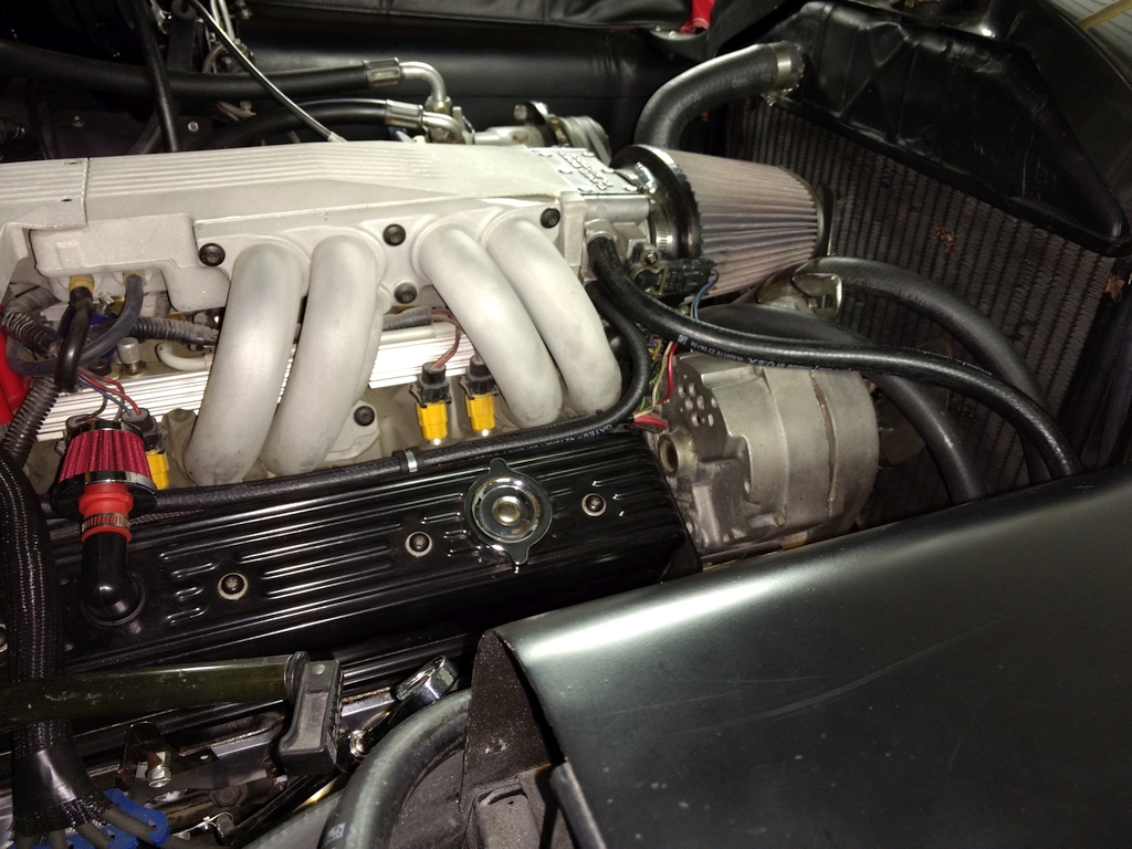

    Finally got all the hoses run and valves connected and canister mounted. Here are a few shots to show the vapor recovery system which, for the most part, got tucked into lower visibility areas.
    starting in the trunk behind the side panel, I brought the vapor hose through a smooth rimmed grommet and looped up high enough that fuel (splash, spray, overfill) cannot drop into vacuum hose.
    tucked the canister into the pocket of the front fender next to the cowling, and managed to get all the purge valveing worked out in that same area instead of sitting around the valve covers/intake manifold.
    decided to route the fresh air hose for the canister front side with the heater hoses.
    Have a couple of clamps left to install and the will be ready to connect the hose in the trunk and test the system.
