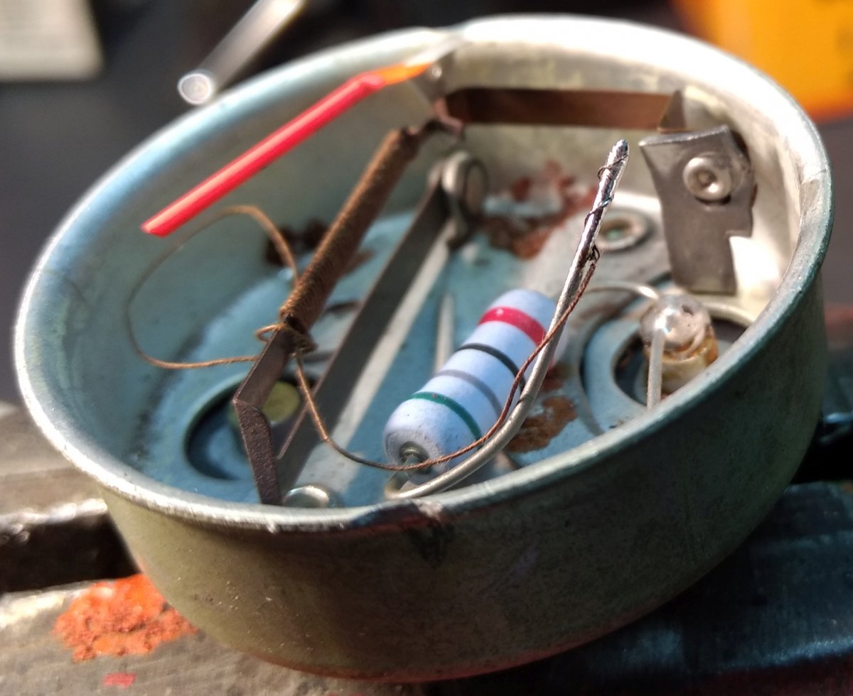

    Good morning Paul. Here is what I found and what I did.
    The gauge panel actually had the markings from original dash (fortunately they had clipped off the decal and left the original gauge part number showing. It is a 1A-9306 which should allow us to backtrack and find what it came from.
    When I opened up the gauge it did not take long to find the problem. Whoever did the mod apparently had never dealt with Nichrome wire and tried to solder it leaving a big ball of solder on the end of the scaling resistor lead (to change from fuel voltage span to battery voltage span) with the Nichrome wire not really involved (probably had enough flux solidified around it to hold it in place for some time).
    As I probed around I found the wire would slide into and out of the ball of solder. I cleaned all the old solder off the resistor lead, re-tinned it, and carefully s****ed the end of the Nichrome wire with an X-acto knife.
    Then managed to get my fat fingers to twist the end of the Nichrome wire around the resistor lead a couple of times so that the next step would be more positive. I cut off the lug from an insulated #22 crimp lug and used the crimp barrel to connect the Nichrome wire to the end of the resistor lead.
    I reformed the resistor lead to take the pressure off of the Nichrome lead wire coming from the base of the thermal element (I believe that leaving the tension there would have messed up the gauge calibration as just moving the wire would make the needle respond.
    Bench tested the gauge, recalibrated the low end to get the needle to rest 'off of the D' marking and re***embled the mounting bracket to the gauge. I will reinstall this afternoon and close everything back up. Regards, bob

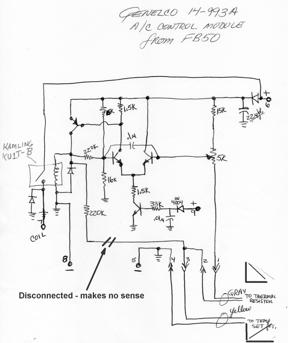

    Last weekend, trying to get some road time on the car, the AC stopped working on the second trip, on the way home. The AC in this car is an old Southern Air version converted for separate temp and fan controls (by me) so I could match up all the knobs and bezels on the dash. Beginning of last week I checked out the problem and found that the connector had two pins not making contact.
    Not knowing if the control had malfunctioned and drew lots of current through the pins or if the pins had become loose over the years and finally decided to generate high resistance contact and then melted the housing, I took the pc board out of the housing and traced the circuit and then checked the components.
    The control board checked out fine so I ordered a replacement connector housing and new connector sockets and rebuilt the harness connector. Stuffed it all back in the housing, re-connected the harness, and got a chance to check all out yesterday. It now works properly and no indications of heating in the connector area.
    The gray wires go to the thermal resistor embeded in the AC plenum and the yellow wires go to the temperature setting pot (potentiometer) on the dash. Best I can tell from the web search is that this same type of control was used for years by Southern Air and other aftermarket AC guys. Thought someone might get some use out of the information I had to seek out to work through this issue. Regards to all, Bob
