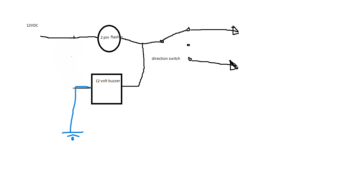

    I have a flasher in my '26 T coupe that beeps when the turn signal is on. A buddy of mine saw, and heard, it when riding with me. He has the same problem I had. Couldn't see his indicator lights in the daylight. Which, in my case, resulted in driving down the road with the turn signal on. I can't for the life of me remember where I got the buzzer/flasher in my car.
    We have both been searching for a buzzer, beeper, etc,/flasher with no results. Does anybody have a lead on a buzzer/flasher? This for a 2-prong flasher.
    There is a buzzer flasher advertised on Amazon and ebay. He tried one. Flash but no beep.
    I'm also wondering about the possibility of wiring a separate 12V buzzer up to the 2 prong flasher. Would this be possible?

  3. The one Bandit Billy shows is good, but in case your flasher can is mounted where it can't be heard, you can use any 9-12vdc buzzer from an electronic supply place (Does Radio Shack still exist?). You will need 2 diodes as well (P/N 1N4001) , I can show you the wiring details (easy).

  14. Untitled.png View attachment 6417601
    This is my first attempt at drawing on the 'puter, but you'll get the idea. Diodes not required on this, just buy a buzzer to suit. If the buzzer is too loud (and they are), put some tape over the holes.

    Hey, thanks! So basically, of the 2 wires on the buzzer, red goes to one prong on the flasher, and the black goes to the other prong. Easy enough. Thanks again.

  18. I goofed up but have modified the diagram. (blue is the negative/ground).
