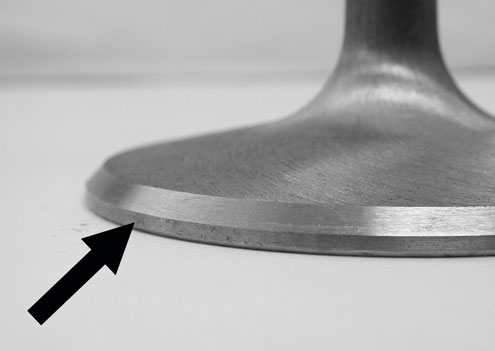

  20. Hey Carl:
    Not to stick my nose in (but here goes!) - is the valve face seat you were showing "complete" or a work in process? Hopefully I'm not over-stepping my bounds, but here are a couple things to note (probably preaching to the choir) :rolleyes:
    You should at least two-angle the valve face seating area - to reduce the head thickness, weight, etc.. Sometimes I use 3 angles - just depends on the valve.
    If you're running 45 degree angles on the seats (looks like it), then back-cut with a 30 degree angle. If you're running a 37 or 30 degree intake seat angle, then adjust your back cut accordingly. Lots of old-time flathead racers ran their intakes with a 30 degree angle and a 15 - 20 degree back cut.
    Note: If you want me to grind and post some flathead valve pictures, just let me know.
    Here are some basic numbers for face seat widths (everybody has their own opinion!).
    a) Exhaust - Seat Face Area: I normally put about a .090 to .100 wide seat area (on the valve) - then set the seat width in the block to about .050 to .060 or so. Center the seat in the valve (on exhaust) - you get it too close to the edge and it will want to burn.
    b) Intake - Seat Face Area: I put about a .060 to .080 wide seat area (on the valve) - then set the seat width in the block to about .040 or so. Put the seat contact area (in the block) close to the edge of the valve - leaving about .010 or so.
    c) Valve Head Thickness - Margin: I like to have .040 to .060 on the intakes and .060 to .080 (can even be a bit more) on the exhausts. You need some head material to cool the valve and the wider seats on the exhausts help as well. Sometimes these numbers are tough to hit on old/used valves - the intake is normally less of an issue (as it stays cooler) than the exhausts, but don't get the exhaust valves too thin - the seat area will burn. If the ones you're trying to use are already thin . . . find some more! :rolleyes:
    Here is a non-flathead valve picture - for those who may not know what 'margin' refers to:
    Also, the seat finish looked quite rough - hopefully you valve grinder can put a better finish on than the picture depicted. (Heck, you may not have ground them yet!).
    If you need any valve work, just let me know - can always fit you in a**** my various projects.
    I always hand lap my flathead valves (fine compound only) - then once I install them (with springs), I pour some lacquer thinner into the port (tipping the block on the stand) - to see if any of them 'weep' - usually you'll find a couple. Normally you can just go a little more fine lapping and correct it. If not - time to redo the valve and/or seat.
