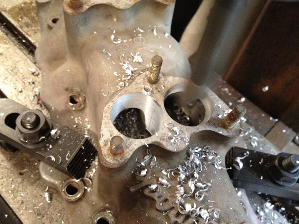

  29. Goose
    Joined: Mar 16, 2004
    Posts: 168
    Goose
    Hey Carl,
    Here is the intake manifold as it is being fly cut to match the size of the 2110 Holleys.
  30. Old6rodder
    Joined: Jun 20, 2006
    Posts: 2,546
    Old6rodder
    from SoCal
    Methinks this ain't the first time you've resorted to this cobble, Sir ....... :D
