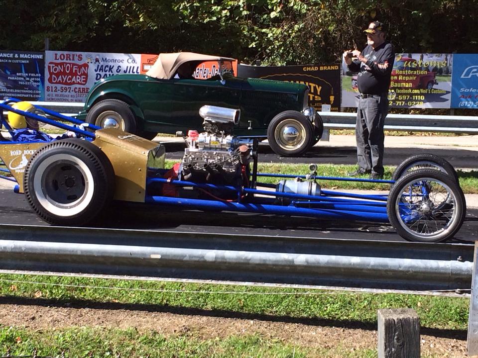

    Well we ran the rail Sunday with the blower for the first time. We now know we need some better rear tires! Our best run of the day in the 1/8 mile was 7.46 seconds and 94.4MPH!! It ran flawlessly all day with no problems. Shifting is hard with the manual transmission, but with a little patience that too became easier. We had 3 runs of 7.47 then 7.46 and 7.51. Pretty consistent when it shifted ok. With some better rear slicks I think it will go even faster.

  23. Goose
    Joined: Mar 16, 2004
    Posts: 168
    Goose
  24. Goose
    Posts: 168
    Goose
    Here are a few pics from the weekend!

    Carl it sounds completely different than it did. If we get some better tires on her it should launch a lot better. We tried taken off at a higher rpm, but it just spun the tires really bad. We are looking into getting some new slicks for her!

    Carl I definately agree 100%. Hey goose what wheelbase is your car that thing is soooo bad*** !!!!!
