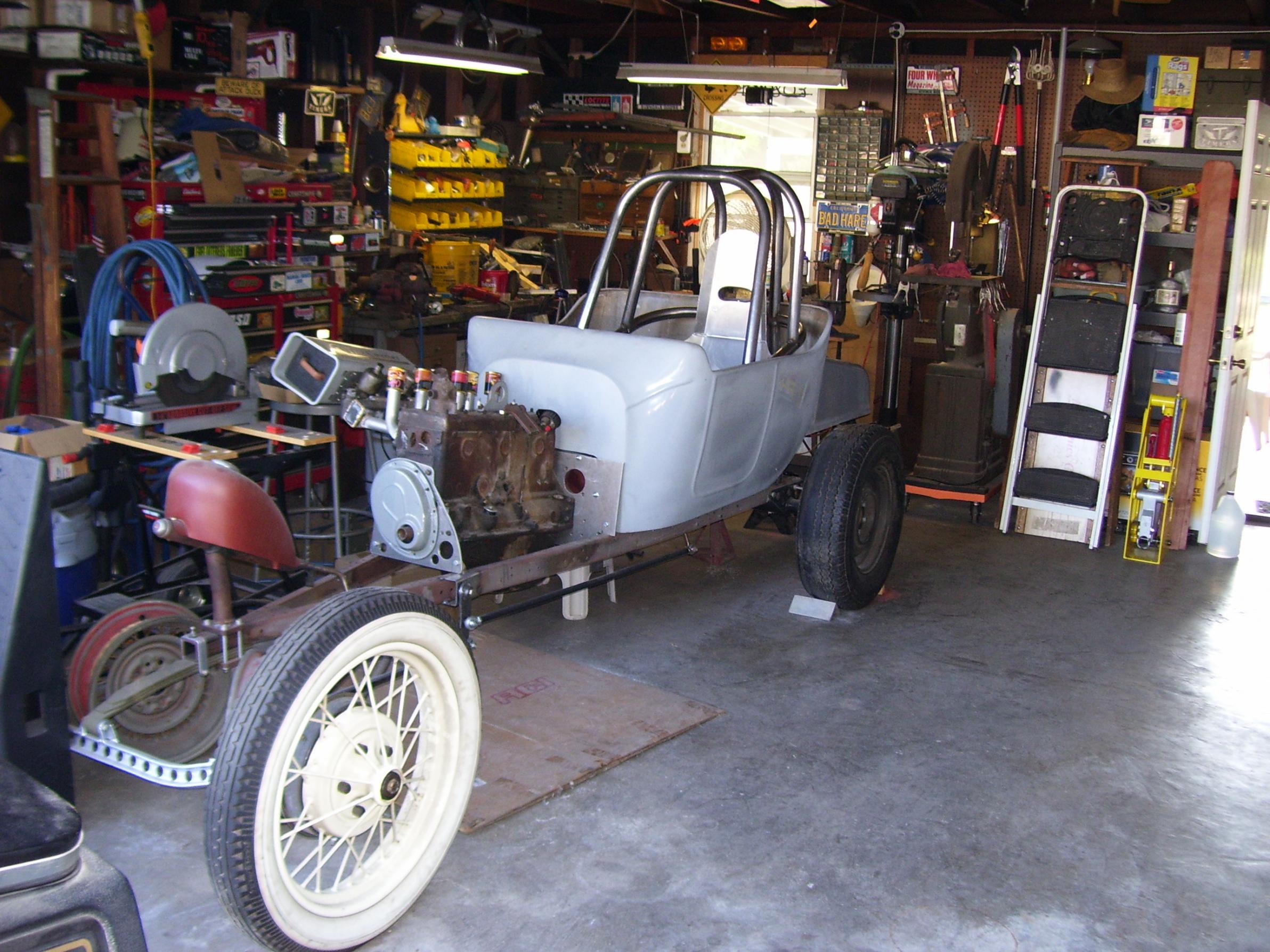

    One of these days my shop will look like that.......NOT! This picture gives a little idea of my "shop". Just add two motorcycles and the mig welder along the left side and ***orted other stuff stacked on the car that were moved out for the photo shoot and you'll get the idea.

    great lookin shop Tom, I just hafta keep mine neat and it still takes me hrs to find anything............:eek:
