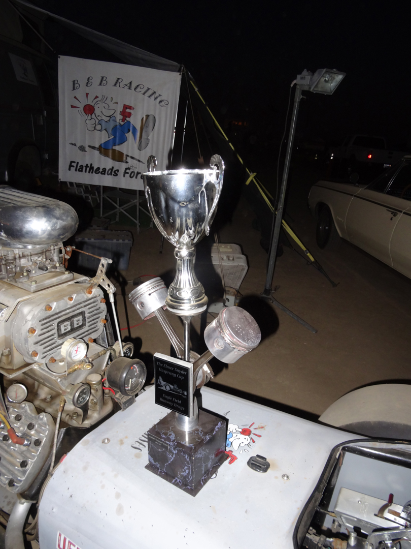

    Well Eagle is over made 6 runs, not one of them complete....UG, but ya know the saying: "the worst day racing is way better than the best day working".................. did get this though DSC01685.JPG photo 1.jpg

    Awesome. Love the trophy, Carl!
  13. roseville carl
    Joined: Dec 29, 2008
    Posts: 5,218
    roseville carl
    Thanx greaser It means a lot to us, Elmer was a special kinda person........

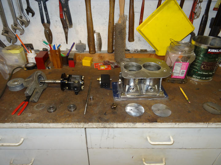

    Still pluggin away......... just goes to show ya I don't sit on my *** all the time......

  18. Looking great. You spill gas just like I do, just enough to get on your clothes and smell up the garage.
    Is your lathe a Lantaine? The reason I ask, is because it looks identical to mine.
    Bob

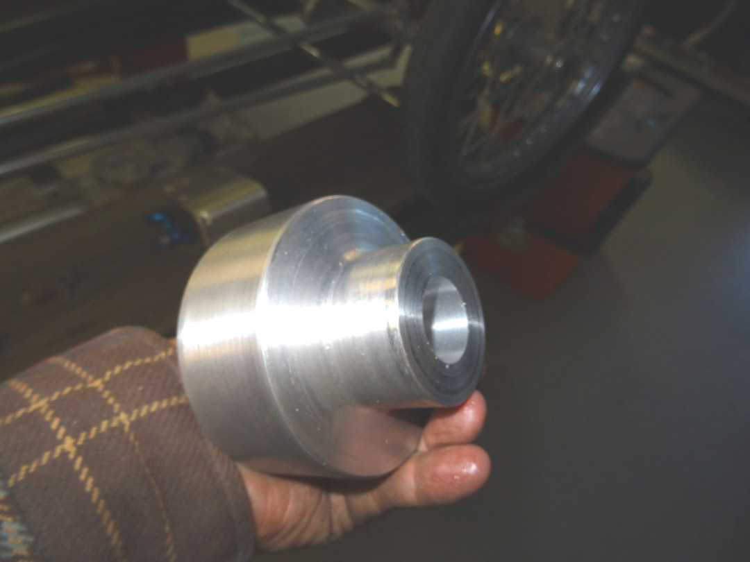

    Yea Bob not my finest moment with a gas can, but it just goes to show that not everything goes as planned. The lathe is a Smitty, not quite as good as the 36x40 Hendy I used to have but does the job only much, much slower. Miss the 7 1/2 hp 3phase and makin 1/8 in cuts at a time........ now 3/4 hp and .020 cuts at time

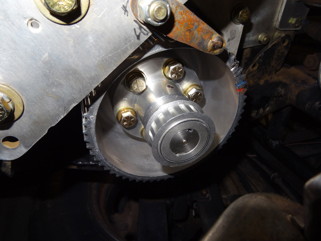

  21. roseville carl
    Posts: 5,218
    roseville carl

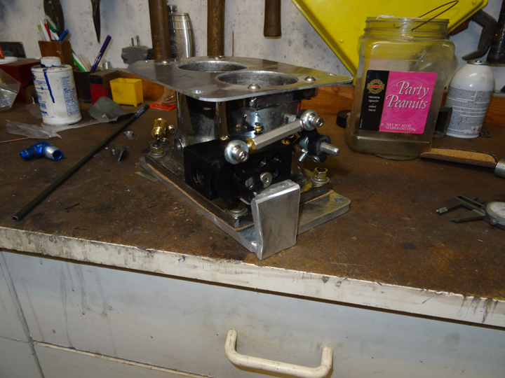

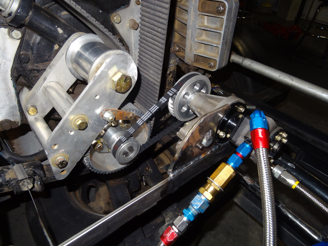

    Well she's a gettin closer to fire up time...... belts on the way....... DSC01716.JPG DSC01717.JPG DSC01718.JPG DSC01719.JPG
    loudbang and j-jock like this.

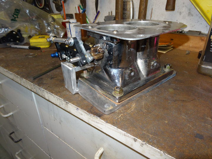

    All welded up ......
    OahuEli, loudbang and j-jock like this.

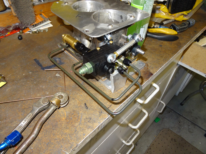

  23. Great stuff Carl - you're finally going to run a damn injector! Once you go this route, you'll never go back to carbs. :) Are you going to be running gas or alky? I'm happy to help you get it sorted out.

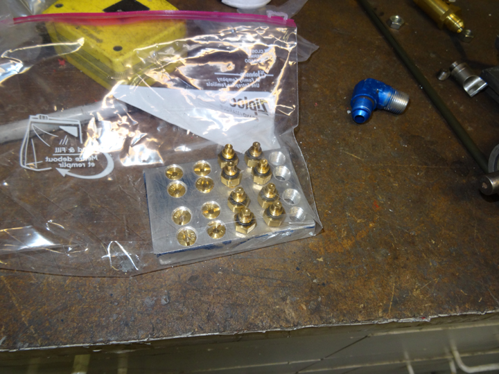

  24. Hey - what size nozzles are you running in the hat and what are you planning for your initial starting pill? Have you had the poppets setup - what pressure? This is going to be FUN!

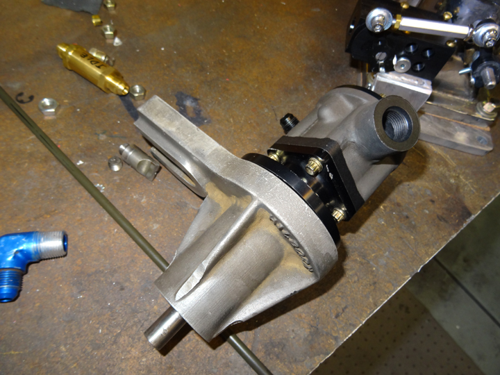

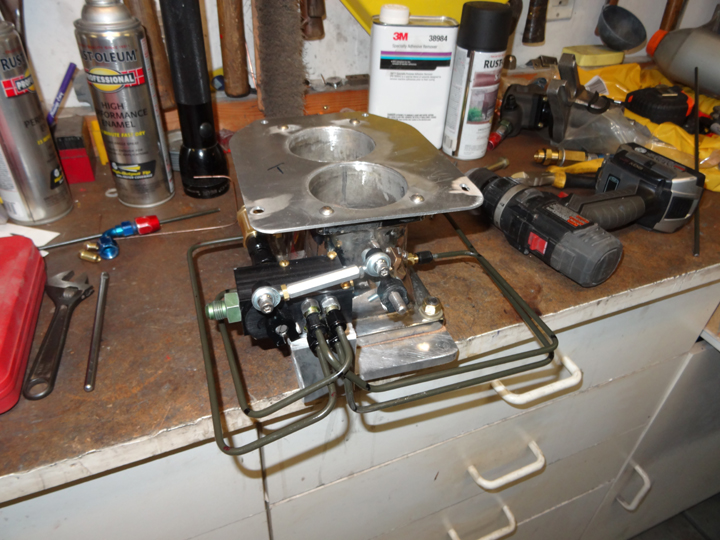

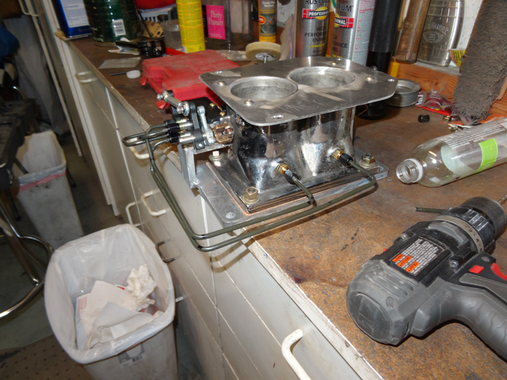

  25. roseville carl
    Posts: 5,218
    roseville carl

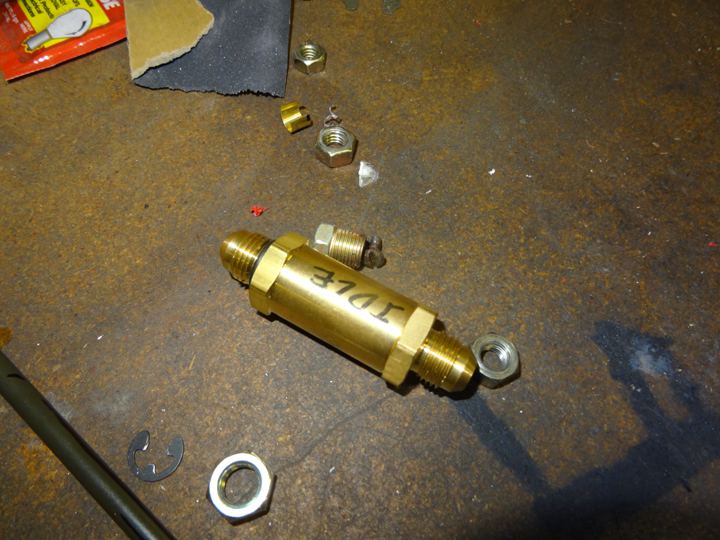

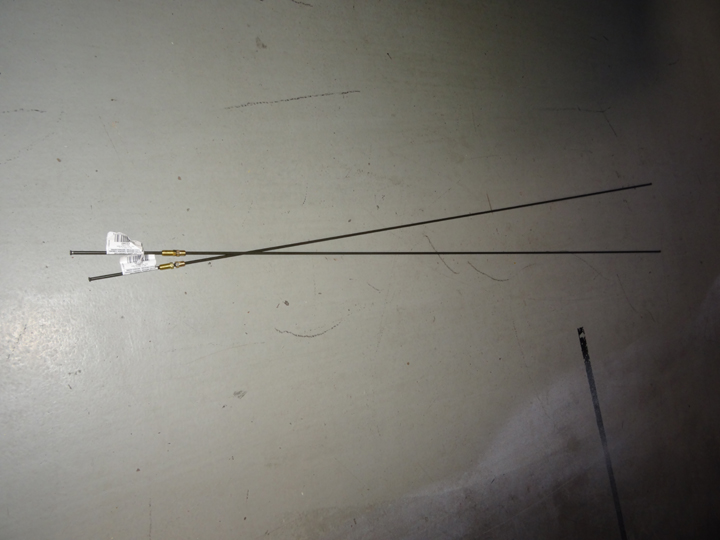

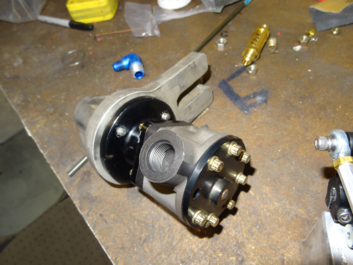

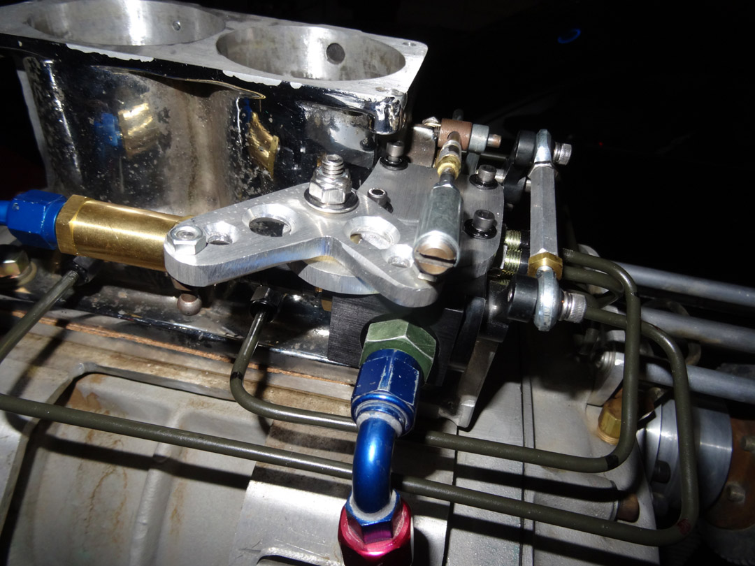

    Running gas Dale cant afford an alky suit.......Ive got .019 and .022 nozzles gonna start out with the 22's and for pills i have 120- 150 in .005 increments hoping to find a ch***is dyno I can rent on the cheap. Otherwise its track time..... Just about finished with the linkage damn I love bell cranks........ only problem is i had to make two, lost the first one somewhere in the shop yesterday spent three hrs looking for it and finally said **** it make a new one, it must have been eaten by the shop gremlins........ DSC01723.JPG DSC01724.JPG DSC01726.JPG
    loudbang, OahuEli and 9sectruck like this.
  26. Hey Carl - what cubic inches is your engine and how much boost do you run? You're only going to have 4 nozzles - correct (no down nozzles). If you want, I believe I have a spreadsheet that can do some calcs. What is your pump flowed at? What GPM at what pump RPM . . . and what is the belt ratio reduction on the pump?
  27. roseville carl
    Posts: 5,218
    roseville carl
    Yep no down nozzles, just the 4, 304CI, have no idea on pump flow its a 1/2-851 pump, 16t x 32t pulleys probably 5-7 on boost no nylon on rotors, loose pump......
    Fuel pump is the one you and Buddy game me a few years ago so its like me old and slo.
  28. You'll need to get the pump flowed - otherwise we won't be able to calculate the fuel curve. That pump actually should be a good one - but the fuel flow curve is important. You can send it to Hilborn (or other guys that can test it). If you can't find anybody in your neck of the woods, you can send it to Fowler here in Columbus (he flows our pumps).
  29. My guess is that you're going to need more fuel than the current nozzles you have - even for gas. :) The last thing you need is for it to be too lean!
