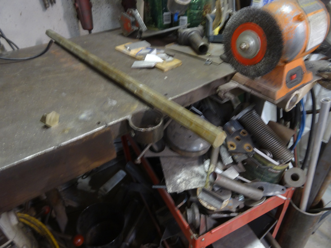

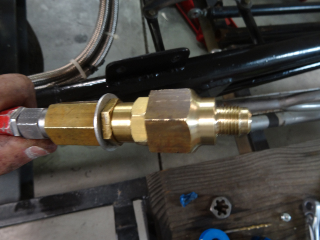

    Well somedays ya cant find the fitting you are looking for so..... what to do?
    remove everything that doesn't like what ya need,
    And presto grigeo...... a fitting emerges.....
    beats the hell out of the mickey mouse adapter I had on it...............
    Countn'Carbs, j-jock and loudbang like this.

    Wow, nice. Did you cut the threads with that die laying there or a bit?
