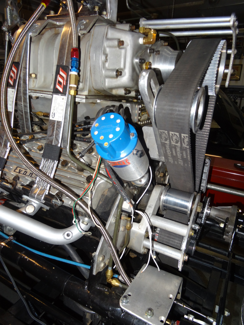

    Yea it was a bad day at the dyno, felt like ignition problems and yep that was it, with all the fuel changes didnt think I would have ign problems turned out the coil wire was not all the way into the dist, boot was all the way down but wire was up about an inch......ug...... spent so much time trying to get fuel right didn't catch the wire issue........ amazing she would idle fine but fall flat on her face above that, hummm oh well at least we found it and now can concentrate on some runs!!!! Was a shame to waste all that money, but the info we learned was actually better than going to the track and waiting for runs.....

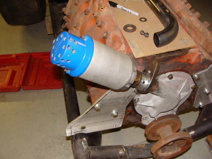

    gonna change ign to this....... being gone thru as we speak.................tired of ign problems dragster hamb 008.jpg
    mctim64, j-jock, loudbang and 3 others like this.

    My first edition had a MSD system with alot of boxes, A Magneto looks and works better ;)
