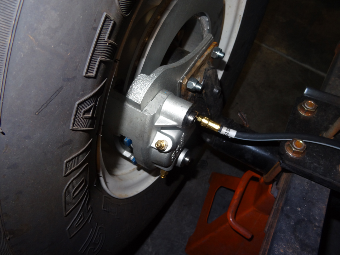

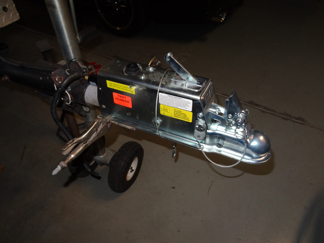

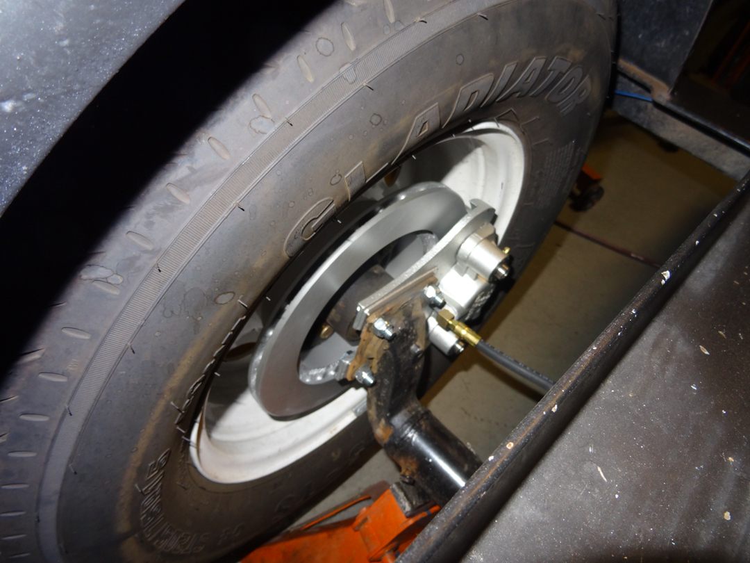

    Why surge brakes instead of electric? Just wondering. I've never had good luck with surge brakes and with the new electronic brake controllers and self adjusting backing plates I've never had any issues.
  2. roseville carl
    Joined: Dec 29, 2008
    Posts: 5,218
    roseville carl
    gotta start somewhere. Never used either and surge sounded good to me.

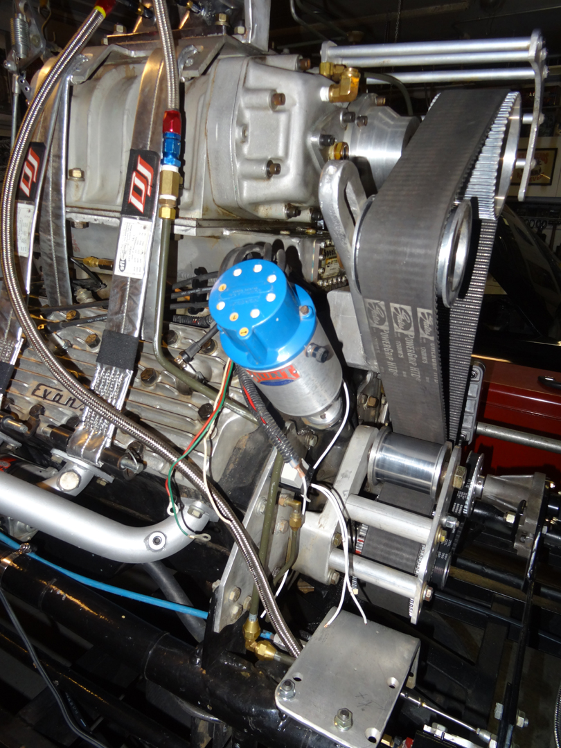

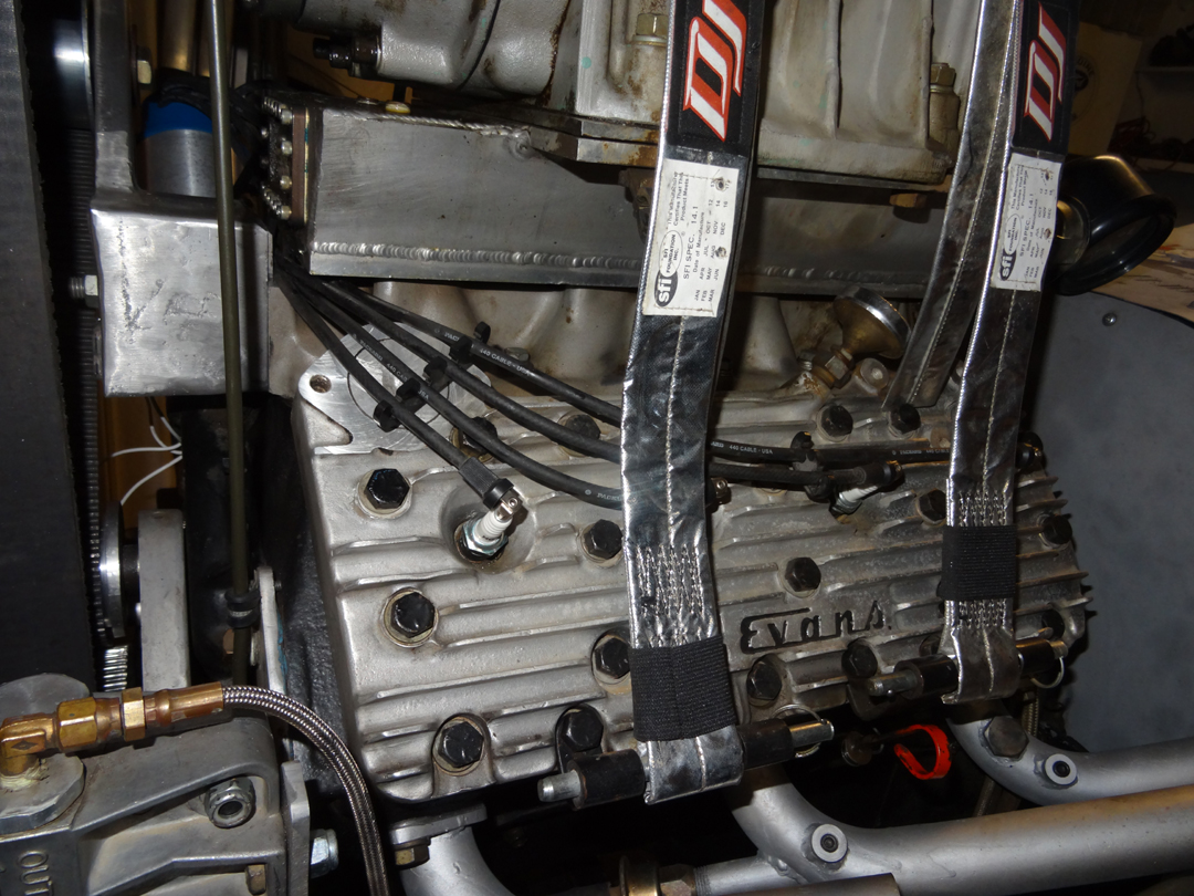

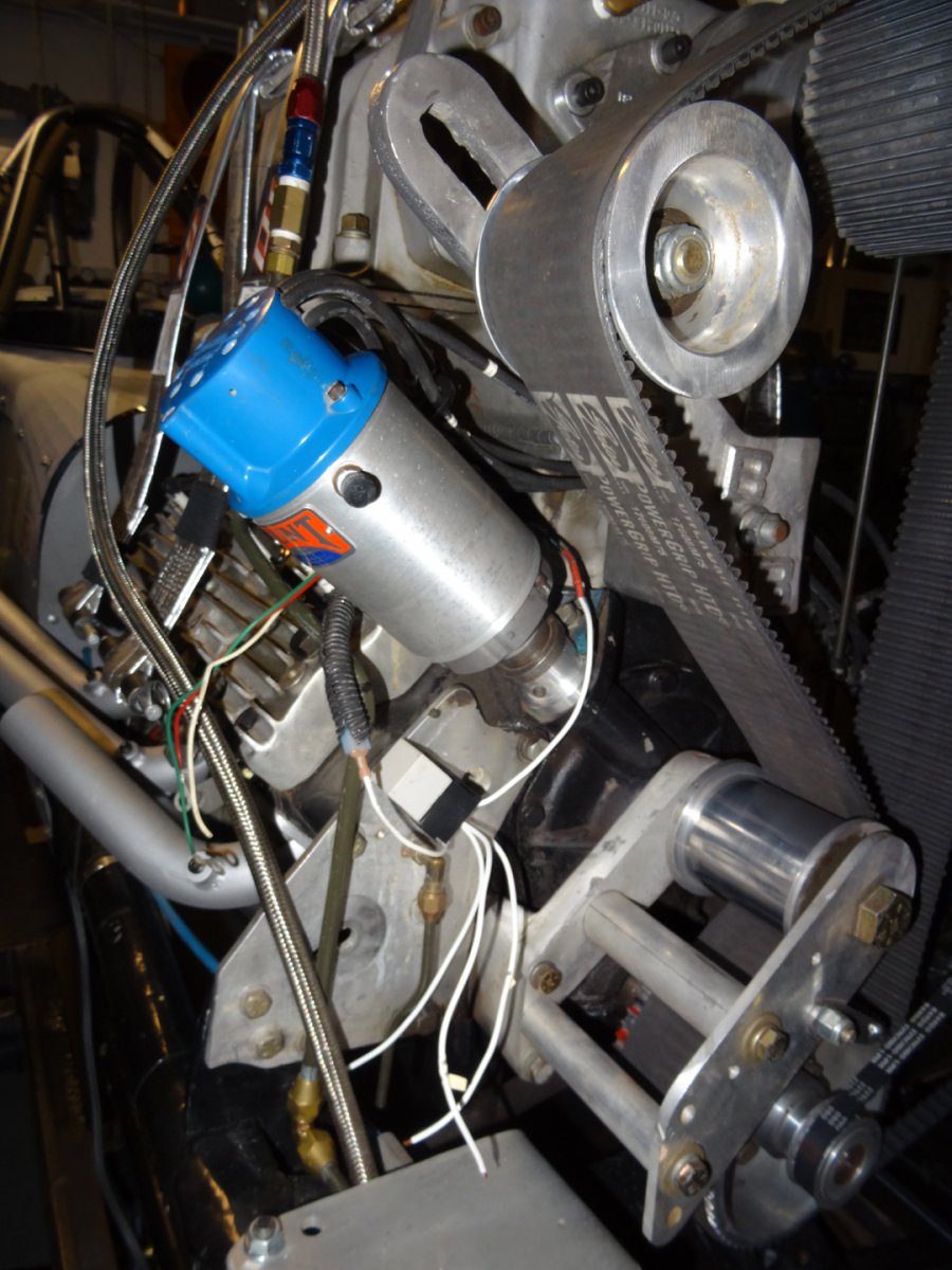

  3. Now we're talking - a REAL ignition! You need a lot of spark energy for alky . . . now you'll have it.
    Do you know whether or not it has advance plates in it? Hopefully it is 'locked down' and has no plates (so the initial timing is IT). If not, then hopefully it has a set of timing plates designed for a flathead - with 6 - 8 degrees of magneto advance (12 - 16 crank). If it has the "normal" SBC advance weights (24 degrees crank), then it will be way too much . . . and BAD things will happen! LOL
    chryslerfan55, mctim64 and loudbang like this.

  5. Sounds good Carl - I would set static timing at about 25 degrees (locked down). I would check it with a timing light to make sure it is solid locked. I've seen plenty of surprises in magnetos in my time. :). Also, don't be surprised if it acts differently - as having a strong spark should burn more fuel, make it leaner and make some more horsepower.

    a little better with spark...........

  11. loudbang
    Posts: 40,351
    Man if that is a cold start she fires up right nice now.

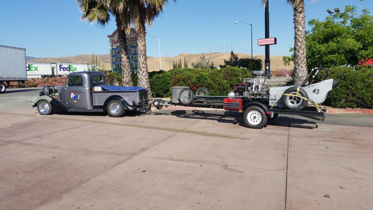

    Well that didn't go as expected, 3 runs sat, none Sunday, its the ****s when your tow vehicle is faster than your race car.........
    Uggg well its back to the drawing board till we get this alky thing figured out............... video later.......
    Did have fun with the Flat8 / 6Cyl shootout though........

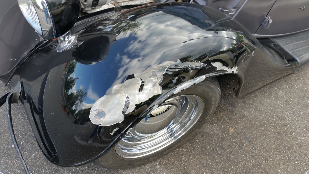

  24. loudbang
    Posts: 40,351
    Well at least the rear cast plate on the supercharger looks real good from that camera angle. :rolleyes:
    1947knuck likes this.
  25. 13clicks
    Joined: Dec 2, 2014
    Posts: 166
    13clicks
    Is that your truck? Bummer.
