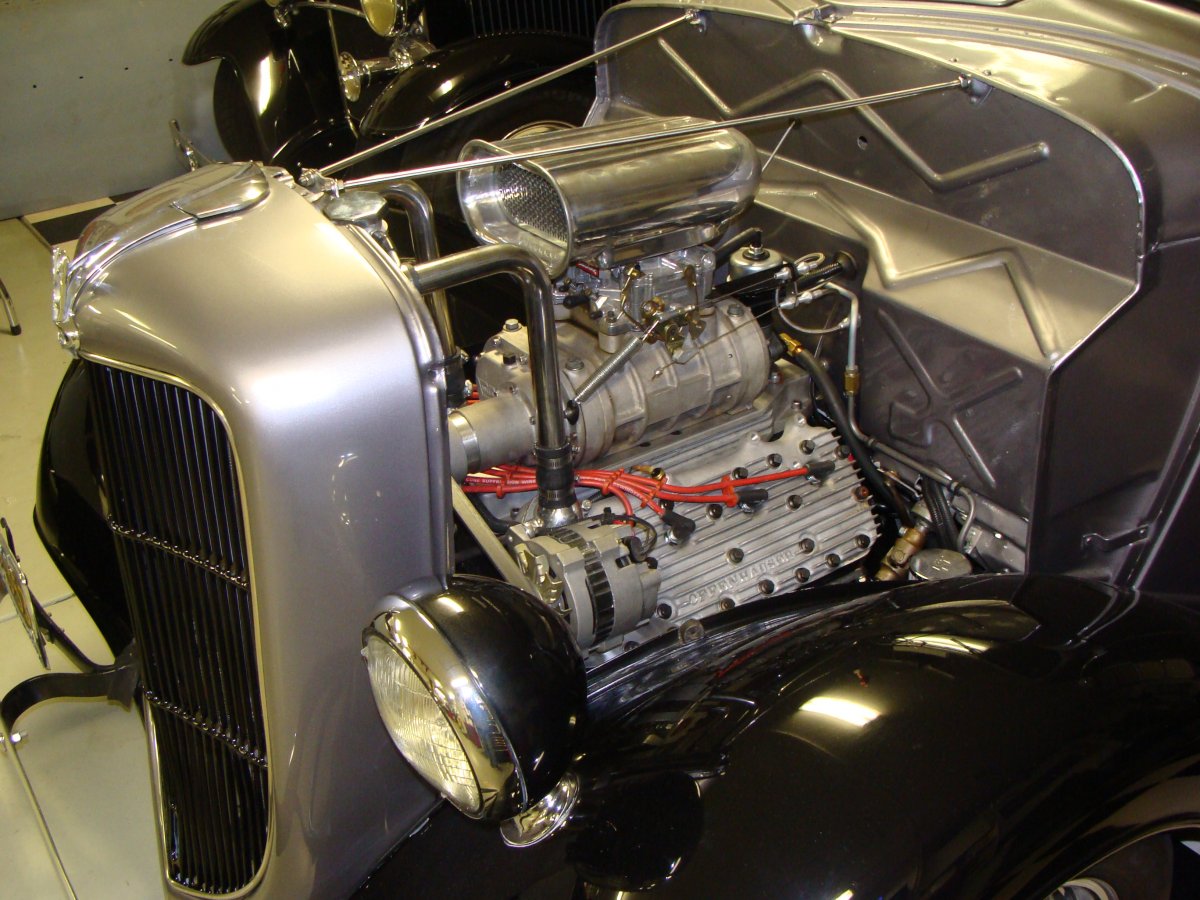

    Well almost ready for some paint....... Uggg I hate this ****...................didn't I do this 16 years ago..... DSC01814.JPG DSC01815.JPG DSC01816.JPG

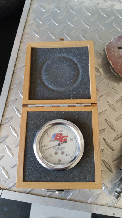

    oh and I got a new toy...... something else to add to the equation......
