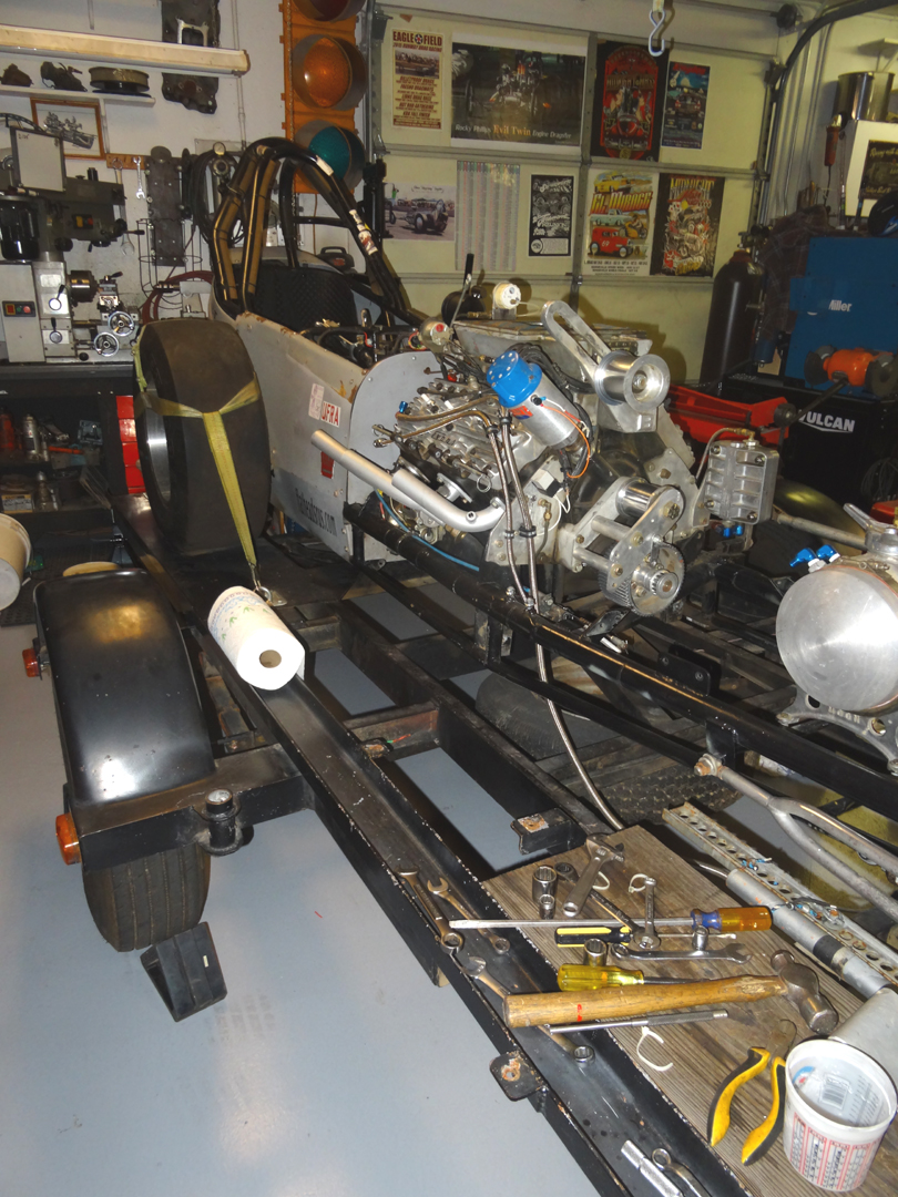

    Well another change......3/8 air vent

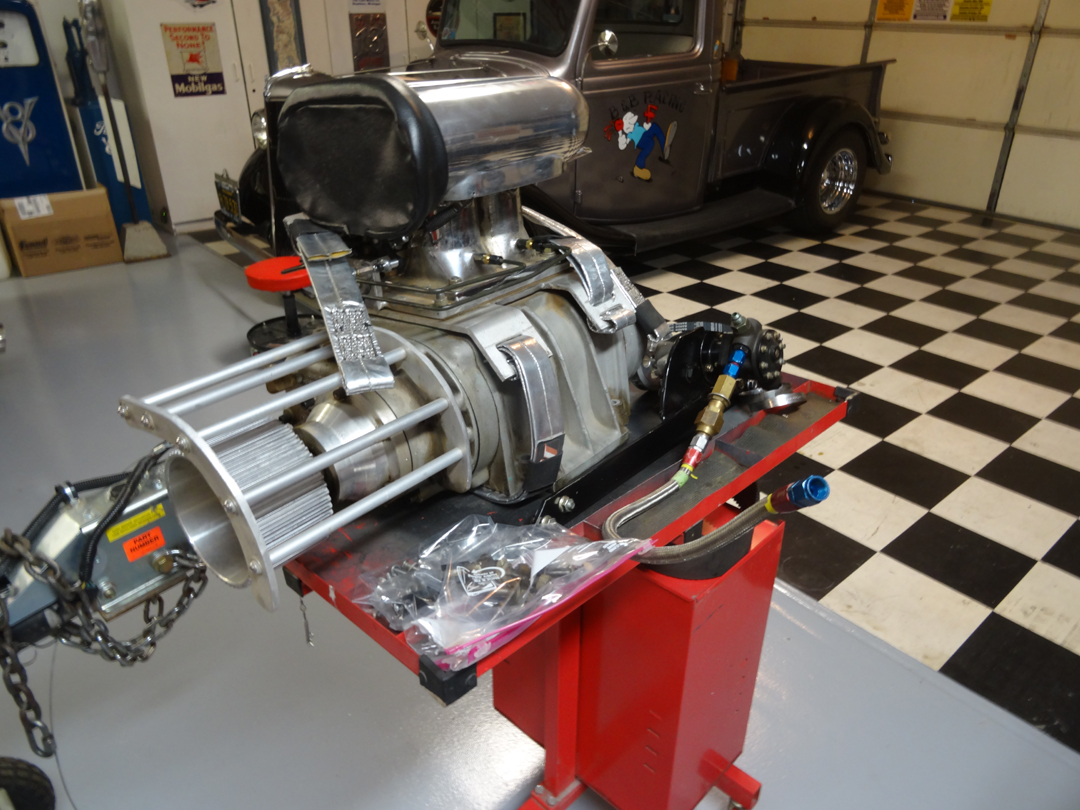

    Its a never ending cycle....... and da beat goes on

    A lot going on there Carl. New injection?
  11. roseville carl
    Joined: Dec 29, 2008
    Posts: 5,218
    roseville carl
    new linkage.............its a kluster ****..............

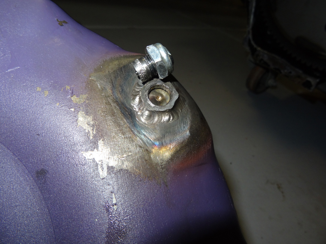

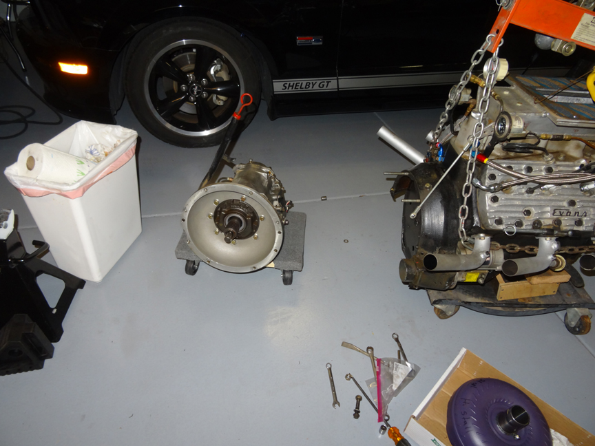

    Ug Monday morning Blues......
    And the culprit of all this ****............torque converter bolt................

    Looking in the wrong place to begin with?
  22. roseville carl
    Posts: 5,218
    roseville carl
    na just doing regular maintenance and found it..................

    Better to find it like that than having it come apart in the traps.
