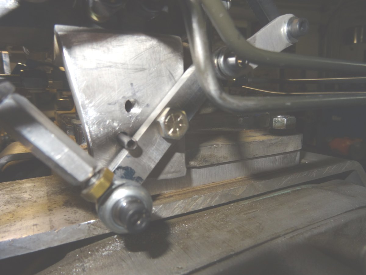

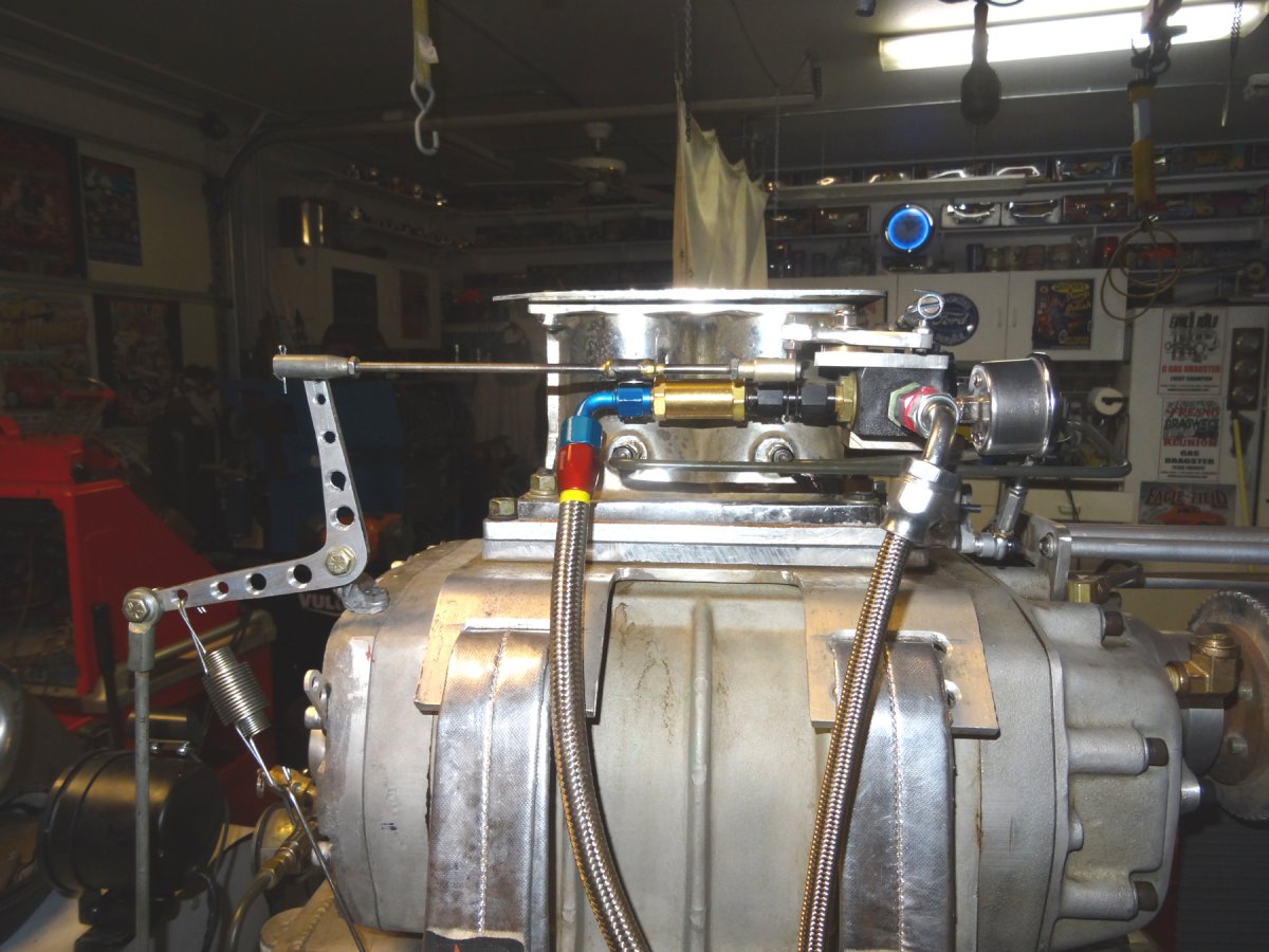

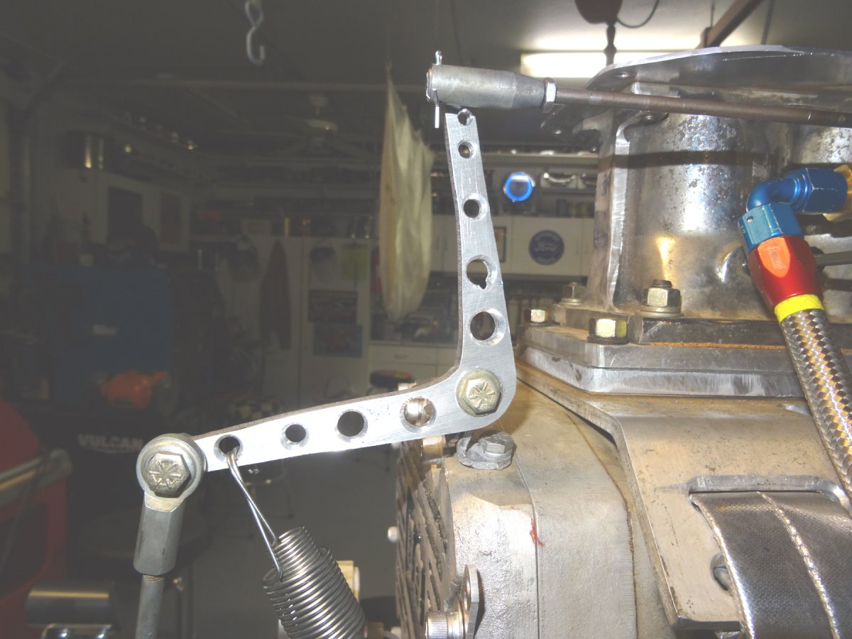

    Hummmm attach a to b, b to c, c to d ect. ect. ect.
    linkage 9-11-18 (1).JPG linkage 9-11-18 (2).JPG linkage 9-11-18 (3).JPG linkage 9-11-18 (4).JPG linkage 9-11-18 (5).JPG

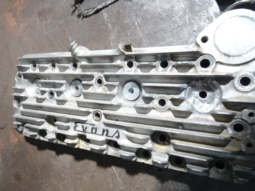

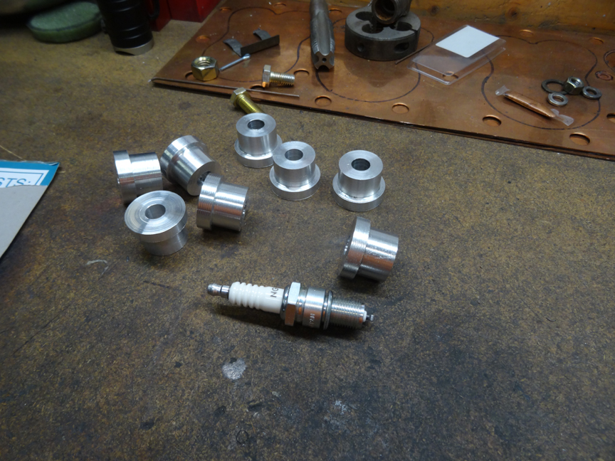

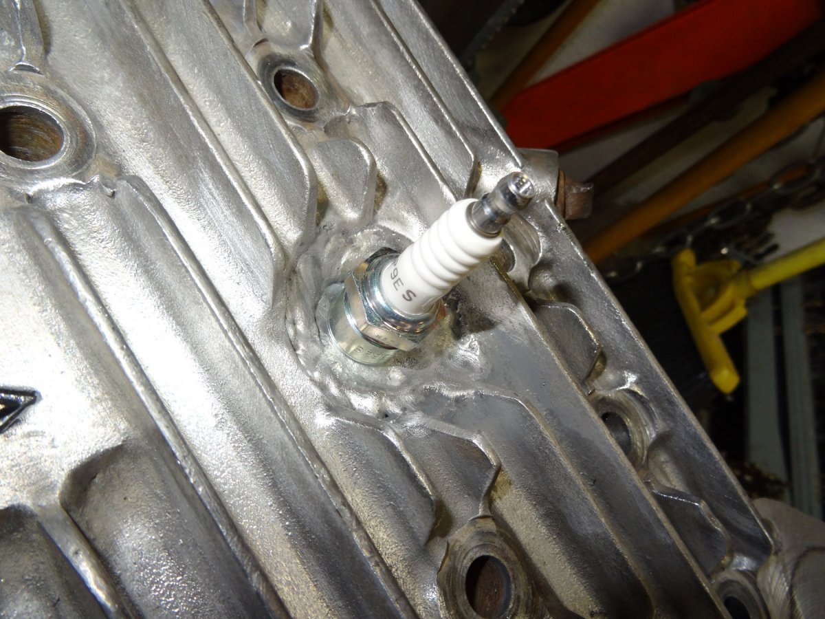

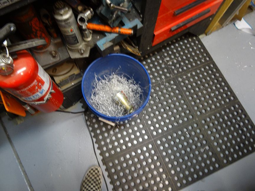

    And the beat goes on. The never ending saga continues. Due to m***ive head modifications now some dummy wants 3/4 reach spark plugs sooo DSC01933.jpg
    Make adapters, happiness is a bucket full of shavings
    and eight adapters now to weld em onto heads and thread em
    OahuEli, loudbang and ottoman like this.

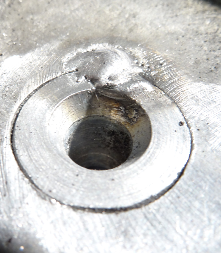

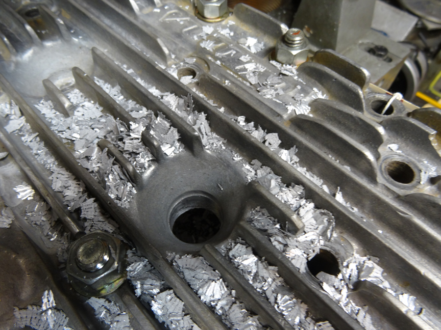

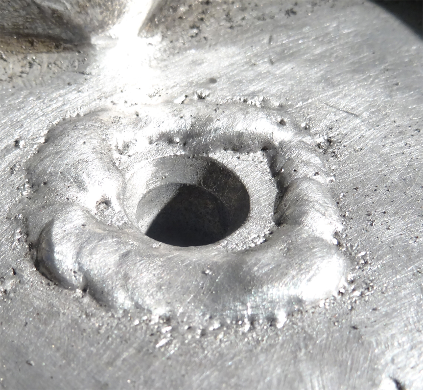

    sometimes things just dont go the way ya think
    kinda ugly but will get ground down.............

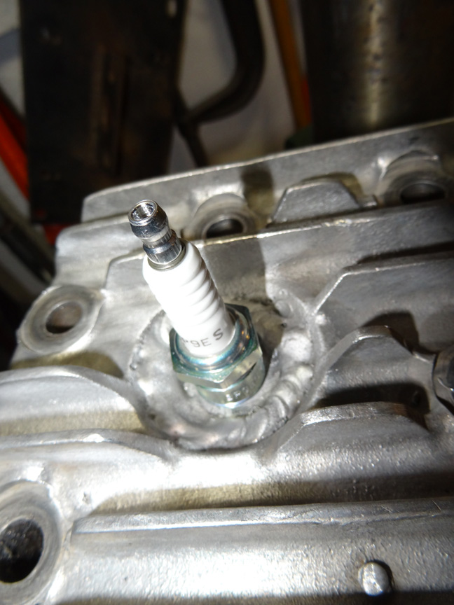

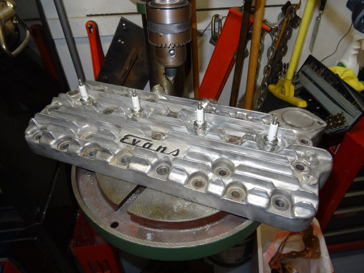

    well one head one to go..............
