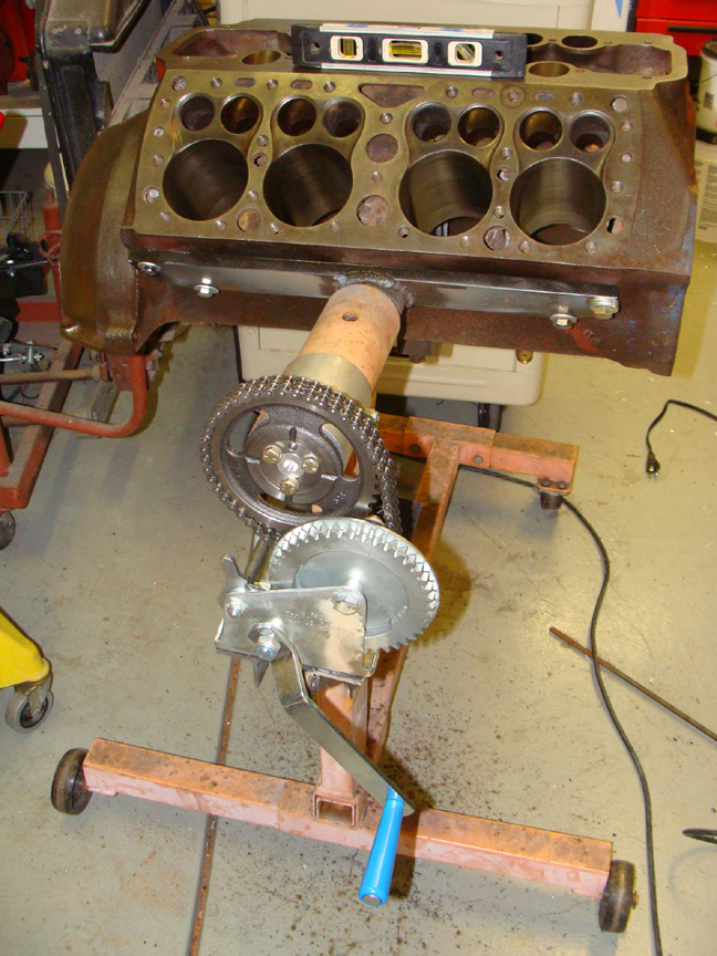

  20. Ebbsspeed
    Joined: Nov 11, 2005
    Posts: 6,515
    Ebbsspeed
    Keep on keepin' on Carl! Ain't retirement great?
    I like the gear reduction drive on your engine stand, need to do that to mine.
  21. roseville carl
    Joined: Dec 29, 2008
    Posts: 5,218
    roseville carl
    OahuEli, 48fordnut, UNCLECHET and 2 others like this.

  24. roseville carl
    Posts: 5,218
    roseville carl
    sleeves in, block poured, ready for re***embly.............sort of 1 19 2019 (1).jpg 1 19 2019 (2).jpg 1 19 2019 (3).jpg 1 19 2019 (4).jpg 1 19 2019 (5).jpg
