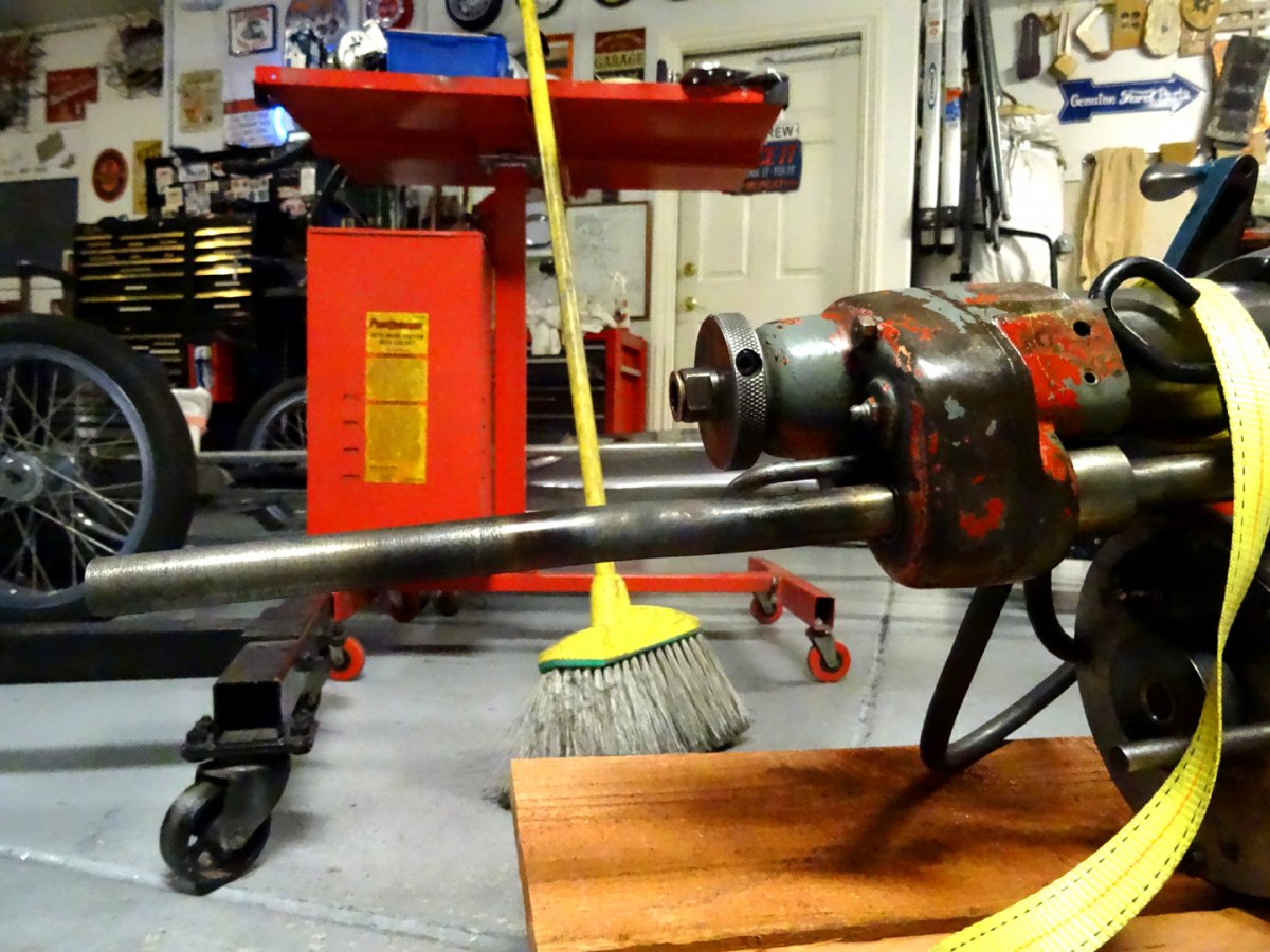

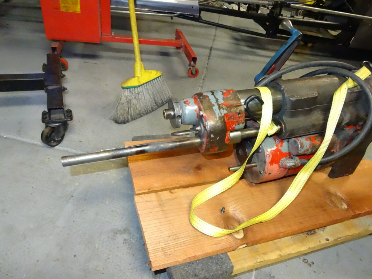

    Well somedays are diamonds and some are RUST.................boring bar decided to take a **** on me after five holes and have a mind of its own.........................UGGGLY.............. Oh well thats what Sleeves are for...............

  22. Sorry to learn that, Carl. Can the boring bar be repaired?
    Bob
  23. roseville carl
    Joined: Dec 29, 2008
    Posts: 5,218
    roseville carl
    yea, parts on order should be here in four days or so...........sleeves in two or three........so here we go again......oh well will give me a chance to clean up the garage

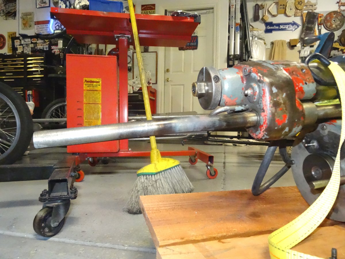

    Locked up again fell over and bent drive shaft..............if it wasn't for bad luck I'd have no luck at all...........
