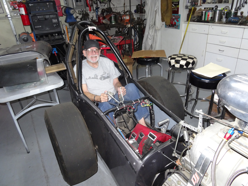

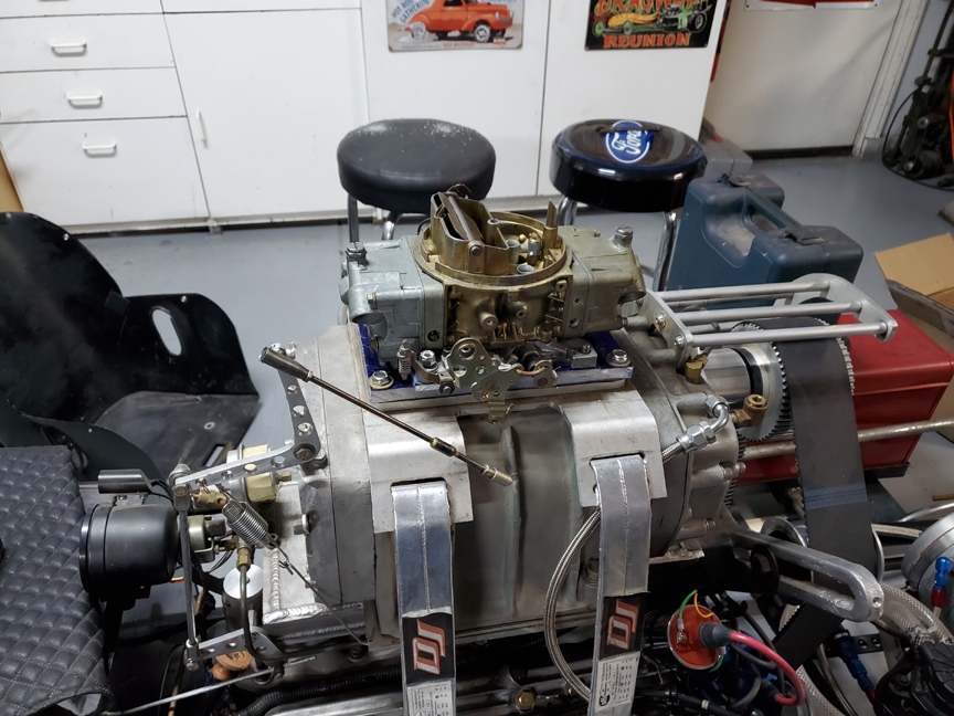

    This month 11 years ago
    Today......lookin forward to a better Year 2021!!!!!
  7. spanners
    Joined: Feb 24, 2009
    Posts: 2,196
    spanners
    In the first shot you look like a grumpy old man. In the next 2 shots you look 50 years younger with a lighter wallet.

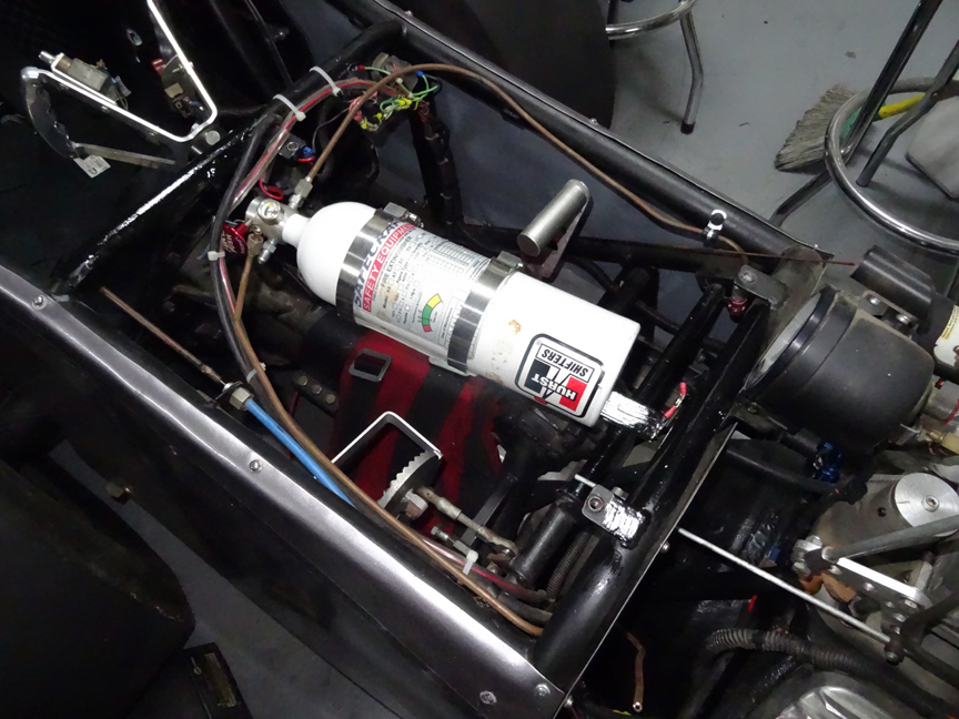

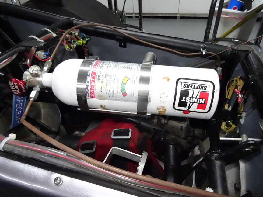

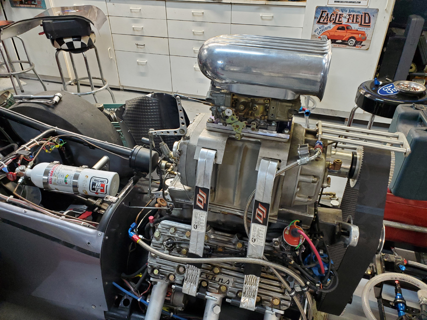

    Well well well......... DSC02788.JPG DSC02789.JPG DSC02790.JPG DSC02791.JPG DSC02792.JPG DSC02793.JPG gotta keep my *** from burning up............

    Blown, Methanol, sub 9 seconds = on board fire system ? Depending on, who is reading the rulebook, and which part, of which book you read!

    Ha ha that's my line, but Carl already answered that 9 or 10 posts ago........ Running Pop means a 20 lb fire system .

  19. Vic Walter
    Joined: Jan 21, 2018
    Posts: 172
    Vic Walter

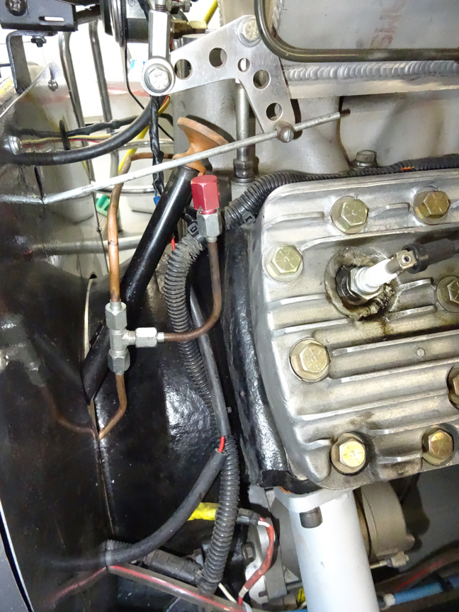

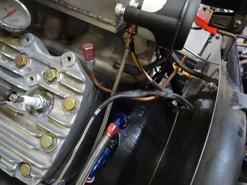

    Any plan to add a mounting bracket near the end of the copper tubing ?
    The added m*** of the fittings on the end of the tube and the vibration present in all cars will eventually fatigue and break the tubing, imho....
  20. roseville carl
    Joined: Dec 29, 2008
    Posts: 5,218
    roseville carl
    yep brackets will be added, steel tubing not copper.

  27. Add blowing out those fire lines to your regular maintenance. Never know what can be plugging them, bugs, dirt etc.
  28. roseville carl
    Posts: 5,218

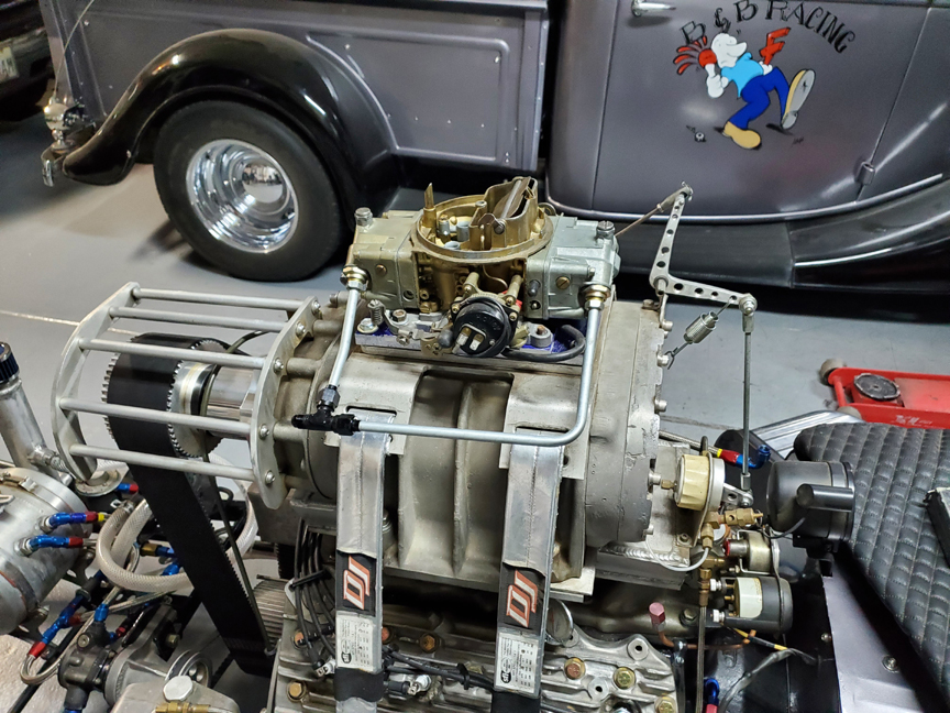

    Well **** it back to square 1................took her out to T&T and didn't make a complete run so back to Gas for a while........Some days are diamonds some days are rust.......... 1 (1).jpg 1 (2).jpg 1 (3).jpg 1 (4).jpg 1 (5).jpg

  30. Flat Roy
    Joined: Nov 23, 2007
    Posts: 533
    Flat Roy
    Well, POOP A DUP anyway. That quad can still give ya a big thrill. Mine does. Go get em.
