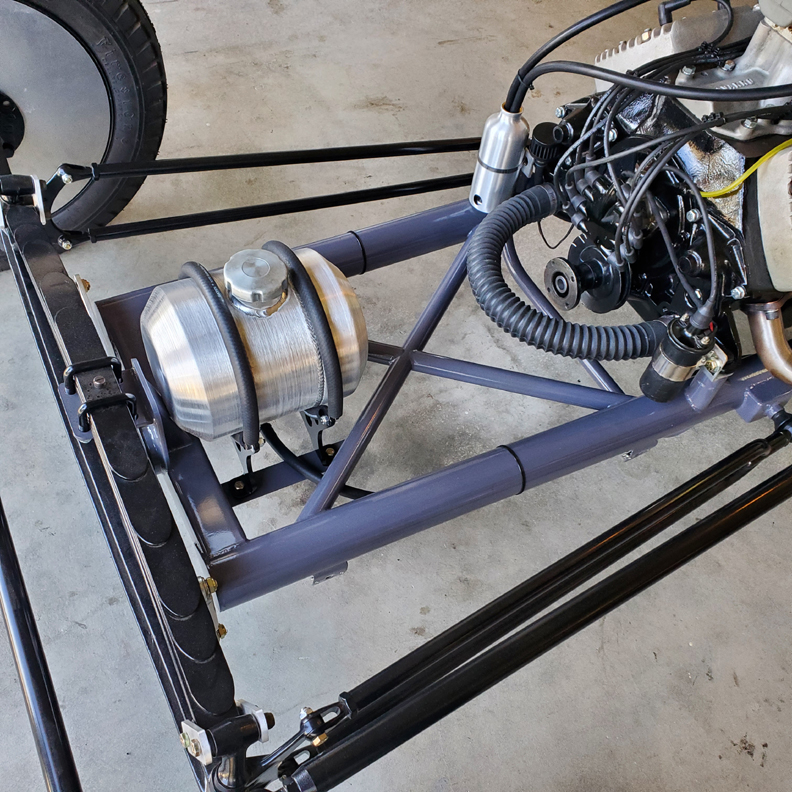

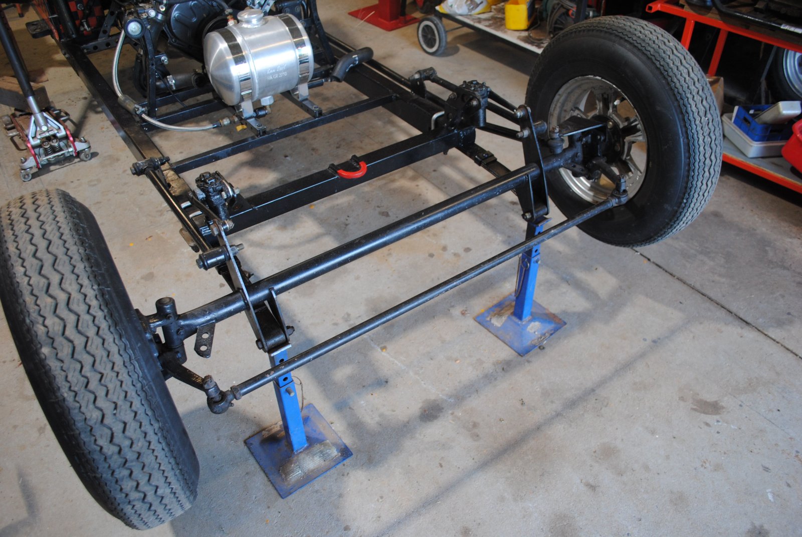

    Got a little done tonight, made a stiffner for radius rod 20221027_182107.jpg
    test fit
    got er tacked in place
    now on to finish welding then get the other side done...............

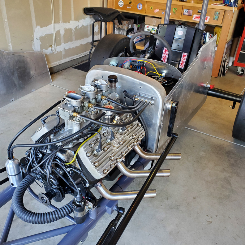

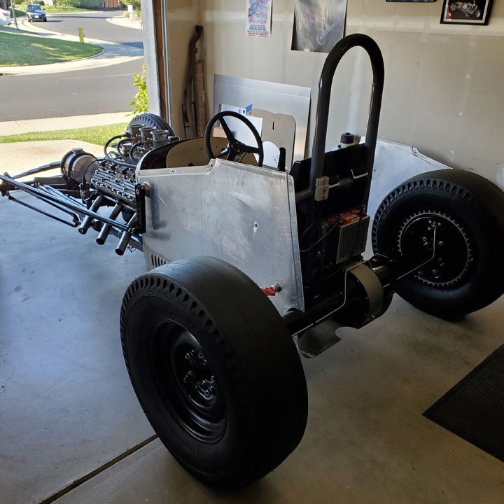

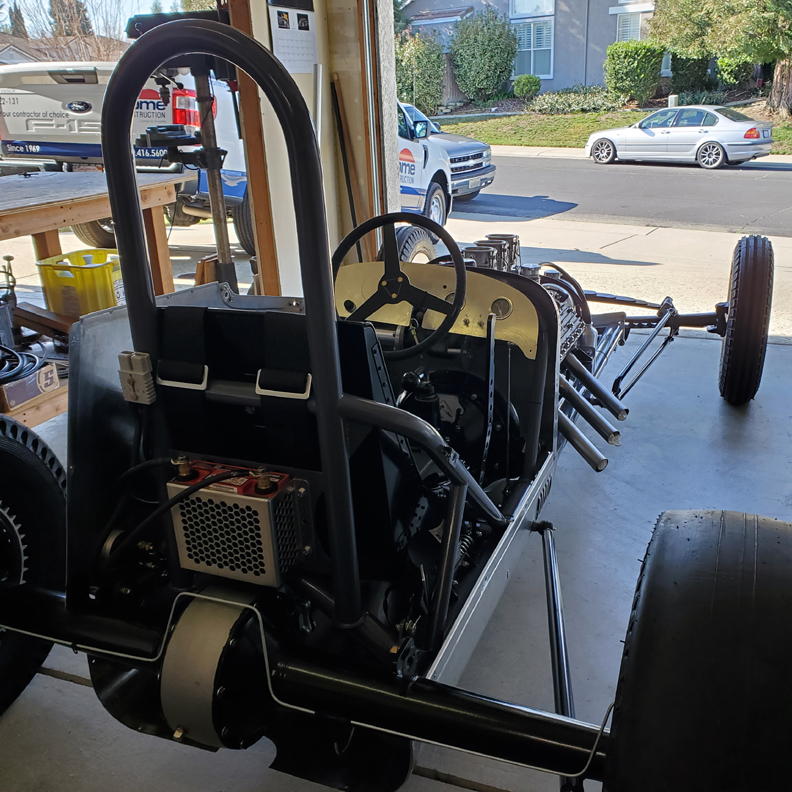

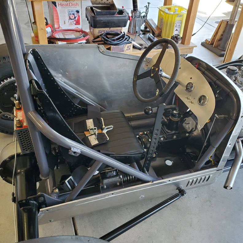

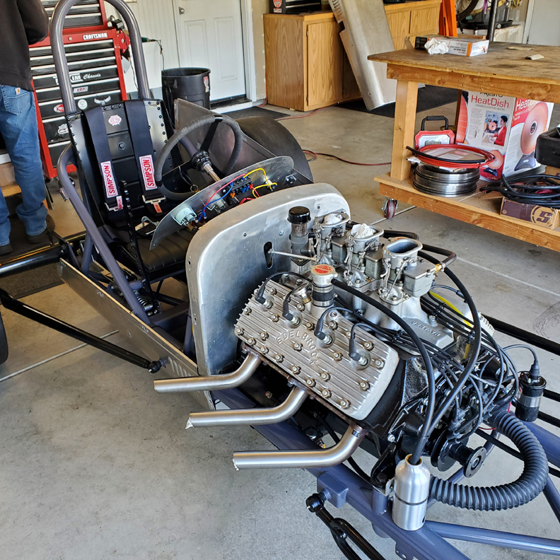

    Been helping a friend with his car, Eagle in May.....
    20230121_121315.jpg 20230121_121324.jpg 20230121_121334.jpg 20230121_121343.jpg 20230121_121353.jpg 20230121_122653.jpg 20230121_122703.jpg 20230121_122716.jpg 20230121_122725.jpg

    Looks good Carl. Looks fast standing still.

    Looks sharp, the only criticism are the steering arms, IF you are running the ty-rod in front of the axle, you need to bend them out towards the wheel as much as you can. the Ackerman is so off, that if you turn the wheels full lock , the outer wheel radius will turn more/sharp and scrub . It will not be perfect, but a whole lot better than it is now

    thanks will tell him.......

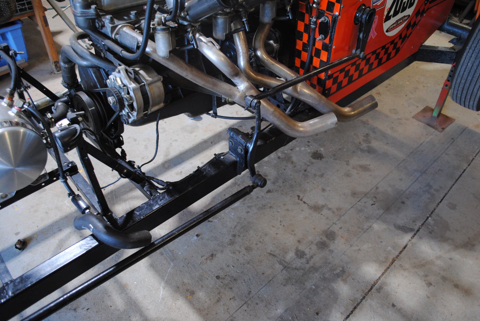

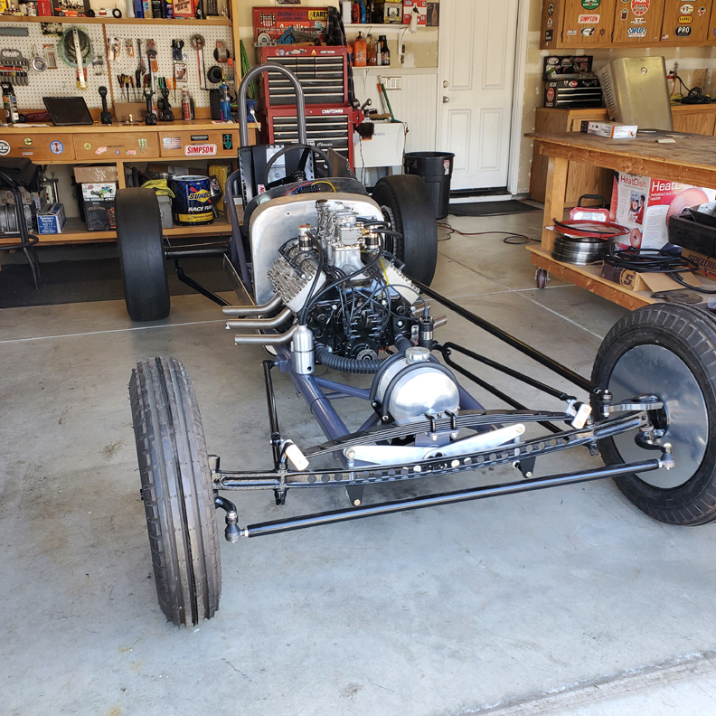

    Please don't take this the wrong way. You've had more to do with building fast cars than I ever will but I'm curious why you're concerned about Ackerman angle on a drag car. Mine is set up like this and is a one hand steer at admittedly just on 100mph 1/4 mile.

    No Problem--- If you can do it correctly and without any measurable expense--- Why not??? You still have to turn the car to get it off an on the track. If you have the chance, look down on your front end from the top of a ladder and have somebody turn the wheels, Some people are more worried about the amount of toe in or out then they are steering geometry. For the race cars I build, front tires are extremely expensive and anything I do that can prolong their life is money in my pocket. Nice Engine, I too am building a Chevy II for my dragster,

    It steers good enough to turn at the end of a run but yes, I wouldn't like to be negotiating a supermarket carpark with it.
    My engine is a Holden Grey six cylinder motor approximate 1956 vintage. 138 cu.in. of tar tearing power:D.

    Again your car and you have every rite to build it the way you want. In my business "Good enough" doesnt work

    Once again, I'm not h***ling you. In fact I envy builders such as yourself for what you construct. I bought this as an unfinished project and the frontend was already installed. I decided to leave it as was and try it. The original wheelbase was 103" but I added a frame section to stretch it to 113".

    Its not "HIGHJACKING" when a discussion on issues. Many look at the pics to give them ideas on how things are built an take it as gospel to copy for their builds. Even Aftermarket racing spindles have it wrong when they include arms, cant take into account the many variations that exist, But it does a better job when the ty-rod is behind the axle. In front just adds more problems because one turned the spindles around
