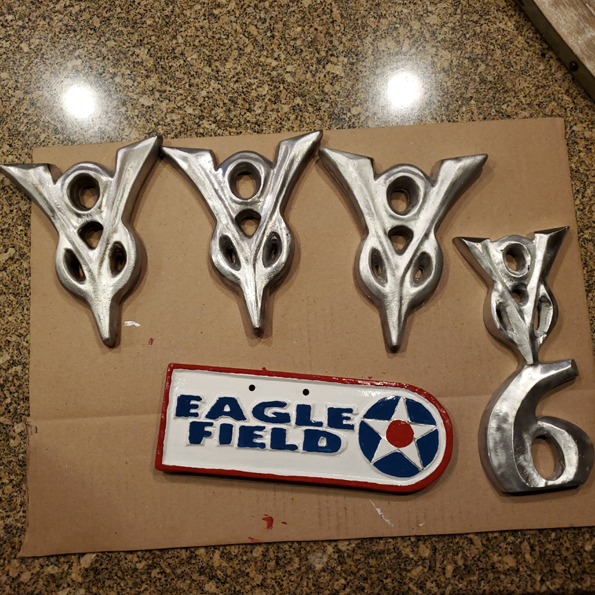

    well lookie here been pouring aluminum the last coupla days........ 20230326_202248.jpg

    Carl, I'd love to have one of those, how much would you sell one for?
    Eli
  13. roseville carl
    Joined: Dec 29, 2008
    Posts: 5,218
    roseville carl
    Well Eli if I charged by the hour I couldn't sell one. Since this a home casting set up I'm just casting em one at a time for use at Eagle Field drags and the racers and Flathead Cars there at this time, if it ever changes I'll let you know........

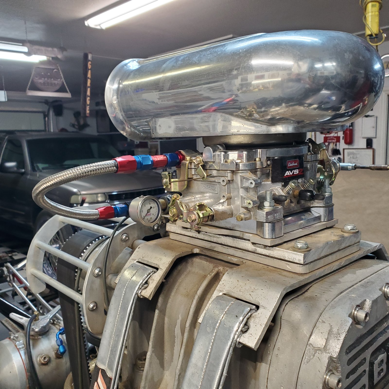

    well after a lot of consternation, cussing, cajoling, and contempt had to remove the Holly and put the Edelbrock back on now, now for some test and tune dates and time to reset the Edelbrock as I have lost all my old timing info, or can't find it anyway, so its back to square one, seems normal Huh?????

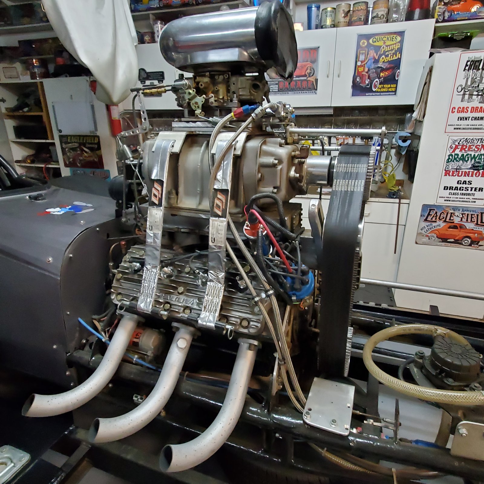

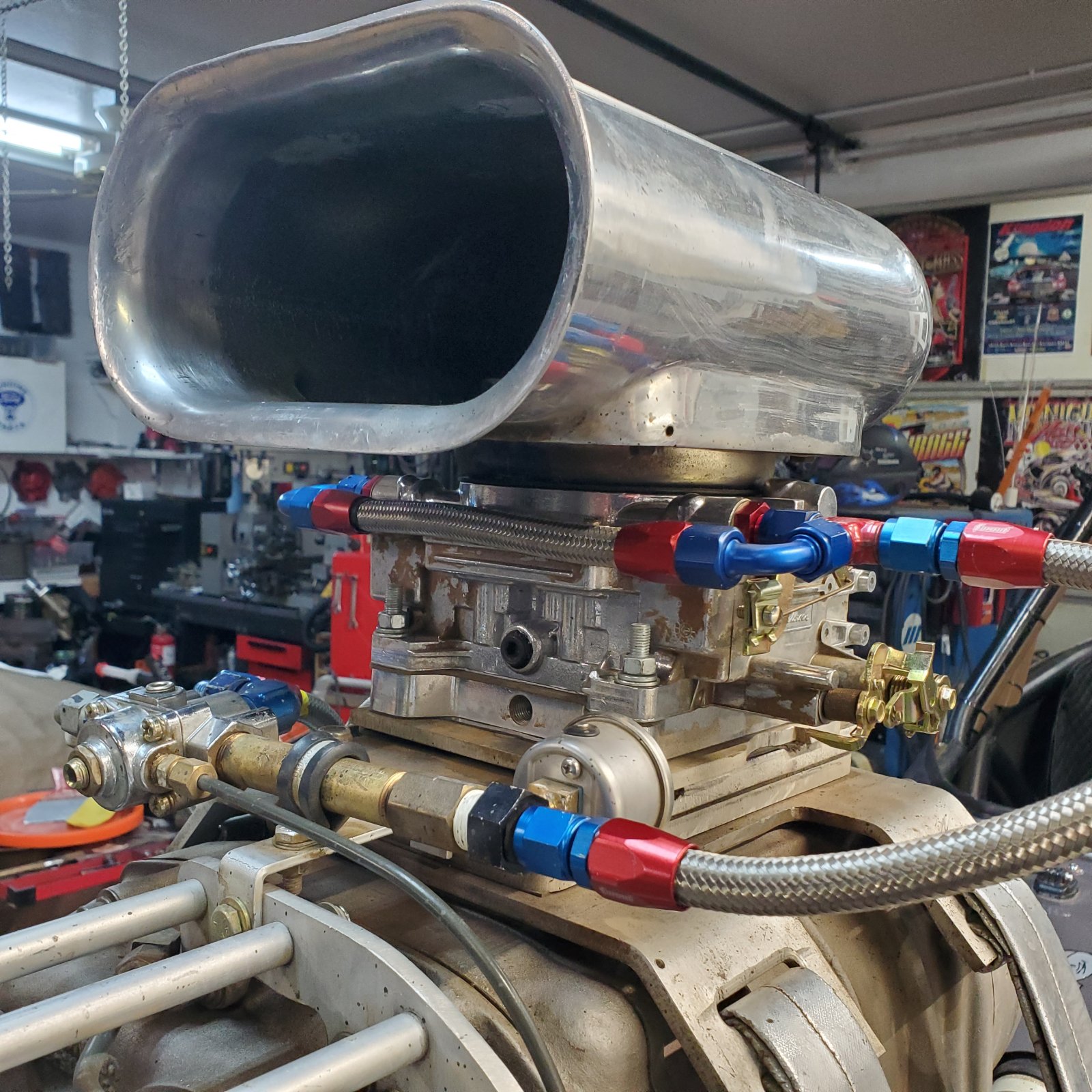

    Well **** here we go again, went to the opening of Mendota drag strip on the 12th. She backfired an blew another blower gasket, said this ****s went home and decided to get down to all this consternation. Well to make a short story long, I did a compression check and the left bank was zero! Oops time to get to the bottom of this. Head is now **** either have to reweld it or modify another head I have for chamber size. See pics 20230821_124531.jpg 20230821_124558.jpg 20230821_124617.jpg 20230821_124704.jpg 20230821_134928.jpg
  28. The reason you blew the head gasket is because the cylinders were pushing fuel into one another - with the intake open on one, it had to go someplace . . . and it popped the blower gasket. It sure looks like you were a bit lean to me, given the color of all your valves (especially toward the front on the engine). That is not uncommon on these old style blower setups as the fuel tends to be pushed to the back of the blower. In modern compe***ion blowers the discharge/outlet is way up front (to help combat this issue). Of course, most compe***ion setups run injectors - with one set of down-nozzles in the ports to help with fuel distribution.
    Are you running alky or gas? It might be time to think about moving over to alky - runs a lot cooler and has a much wider tuning window than blown gas. Blown gas is one of the hardest things you can run (as far as tuning).
    Also, what type of head gaskets are you running? You might think about the MLS Cometic gaskets - all steel and I would think they'd hold up a lot better than copper or composite gaskets under boost with no o-ring. Singe you don't have an o-ring groove, you really can't run solid copper, so your choices are limited.
  29. Also, there appears to be quite a few cracks in the prior welds in the heads - around plugs, around the blown gaskets in the middle, etc.. My guess is that these heads are toast. Hate to say it, but they look like they've about run out of useful life. ;)
