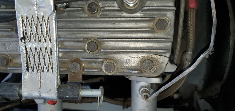

    ouch, Race it, break it, fix it, repeat.

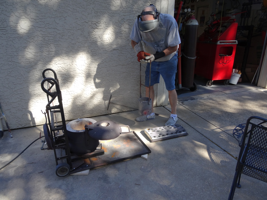

    Humm OSHA approved?

    a little earlier, no CNC here all manual.......

    Ya ain't running any water in that thing. Why not just mill a pair out of solid bar stock or cast a set of your own? Just saying you have the technology....... I know Carl, it's easy for me to say.:rolleyes:

    thas the next step Tom, but this is cheaper........ and I'm cheap

    Just fill the water jackets in the head with a low melting point metal???

    thas what I was doing Jeff

  24. Did you TIG weld the crack up? Looks like it was a real mess! ;) Glad you got it back together!

    Na Dale it was too bad and cracked in three other places. Got an old Weiand 8ba from a buddy of mine for free and all I had to do was hog it out to match my other head, new Cometic gasket and off we go. Next step is to order some 2" blanks and make my own B&B heads.........
