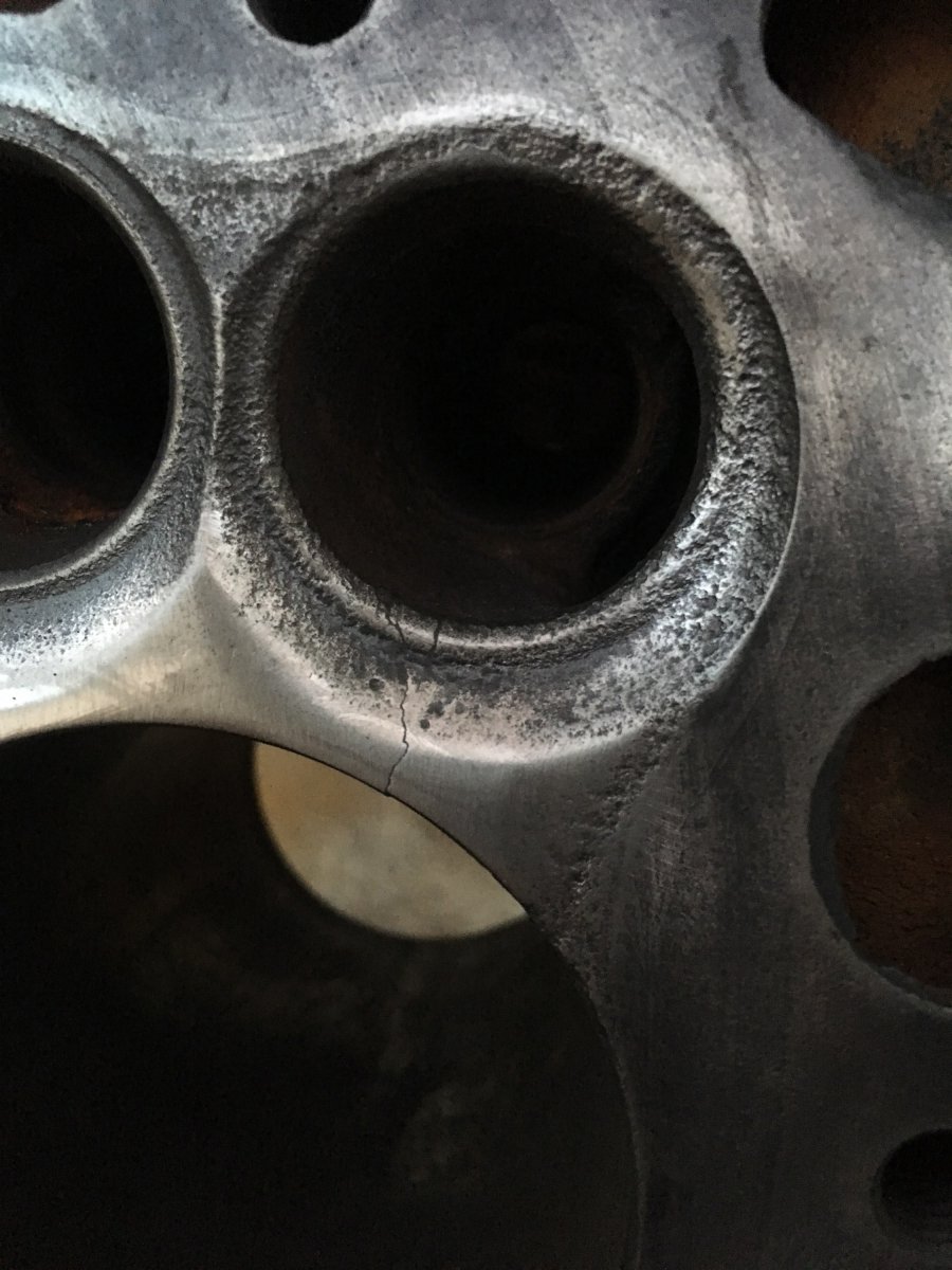

    Engine number one no good. Block is cracked between two exhaust valves and cylinders. On to engine number two. Lesson learned..pull the heads before purchase. Second block looks good so far. Also picked up a Mercury crank. The plan is to build a car worthy of th Race of Gentlemen.

    The picture is too close up, I can't figure it out.
    Stock flathead heads are pretty common and cheap.

    That's the bunk of buying flatheads, you really need to be able to see the top of the block and check for cracks.

    I thought the crack was in a head, which is a different thing. Good heads are easy to find, good blocks, no.
    The new picture makes it clear.

    Always a good idea to pressure check and Magnaflux a block prior to spending money at the machine shop. These cracks were not visible to the naked eye. Sometimes a running engine may have cracks not evident. A bore scope will let you look inside the exhaust ports and also check the pan rails.

    I was under the impression that you could fix that with a sleeve if that was the only thing wrong. No?

    I had a block with a crack between the exhaust seat and cylinder repaired as Markdtn suggested, with a sleeve and seat insert quite a few years ago. It worked fine for the year or two I kept in touch with the owner.
    I don't recall if there was an issue with the water jacket, or if and how it was fixed. It was a long time ago.
    An old timer I knew said that back when the flatheads were still a common engine, the rebuilders initially refused a block with any crack. However they could not get enough cores, so they started accepting cracks between the water jackets and studs.

  25. I would think also, Back in '94 I had a flathead Cadillac block repaired. It was cracked in the valve bowl and up and back down into the cylinder, this in two cylinders. They installed new sleeves and "cold s***ched" or "plug s***ched" the valve bowl. Forgot what they called it but they drilled a hole, threaded it and installed a plug, drilled another hole halfway in the first plug, threaded it and plugged that .... all the way to the end of the crack. Then machine out the valve bowl. The car has been running since 1994 so it must work, but it was not cheap, had more money in the block than the car cost.

    IMG_20180820_193223.jpg I have an 8BA with 3 exhaust port to cylinder cracks. I was going to use Lock n S***ch pins in the port and across the deck and have 3 cylinders sleeved. Probably about $750-800 by the time it's all said and done. This was a running motor I took out of a customer's car because of a dead hole. It was free. Am I wasting time and money trying to save it or are they getting scarce enough to warrant the effort?

    Fix it, run the **** out of it. If you blow it you won't be sad.
