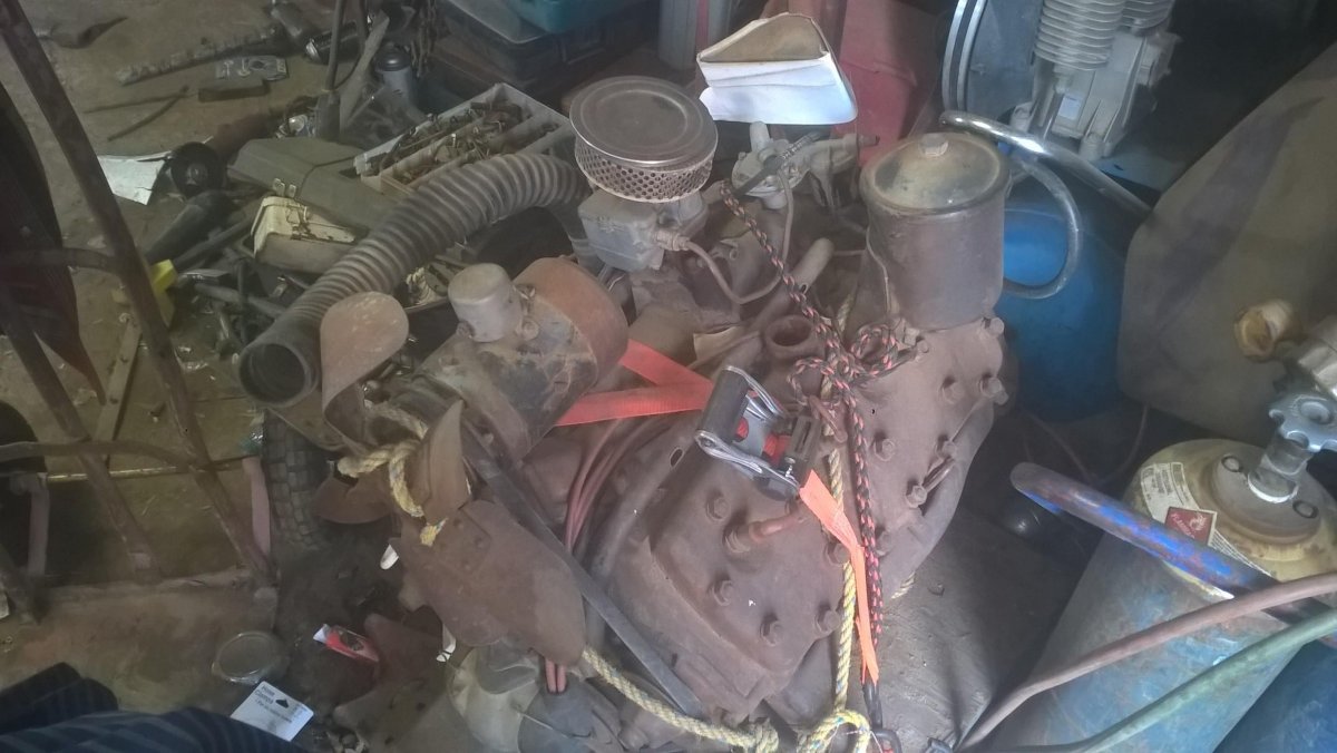

    image.jpeg can anyone tell me the approx year of this motor....it came out of a 1934 truck but looks later model to me by water spigots on the heads and location of water pumps....i know very little about these motors, but this was a good running engine when removed and I can get for $500 motor, trans and everything in between . Im hoping this is actually an insert engine instead of babbit.... little help please

    I'm no expert either, but looks like it's maybe a '37 or '38. 21 stud, center outlets, water pumps on the block.

    I'm gonna' say a 39 or 40, 24 stud, 85 horse.

    That's what it looks like to me, as well.

    Its definitely not a 24 Stud motor...it is 21 stud and as you say the water pump location combined with the 21 Studs indicate an insert main bearing 37/38 motor. If the distributor , carb and generator, fan , manifolds are original it narrows it down to 37 early 38. Single fan-belt , oil filler and type of dipstick says car or pickup not a big truck.

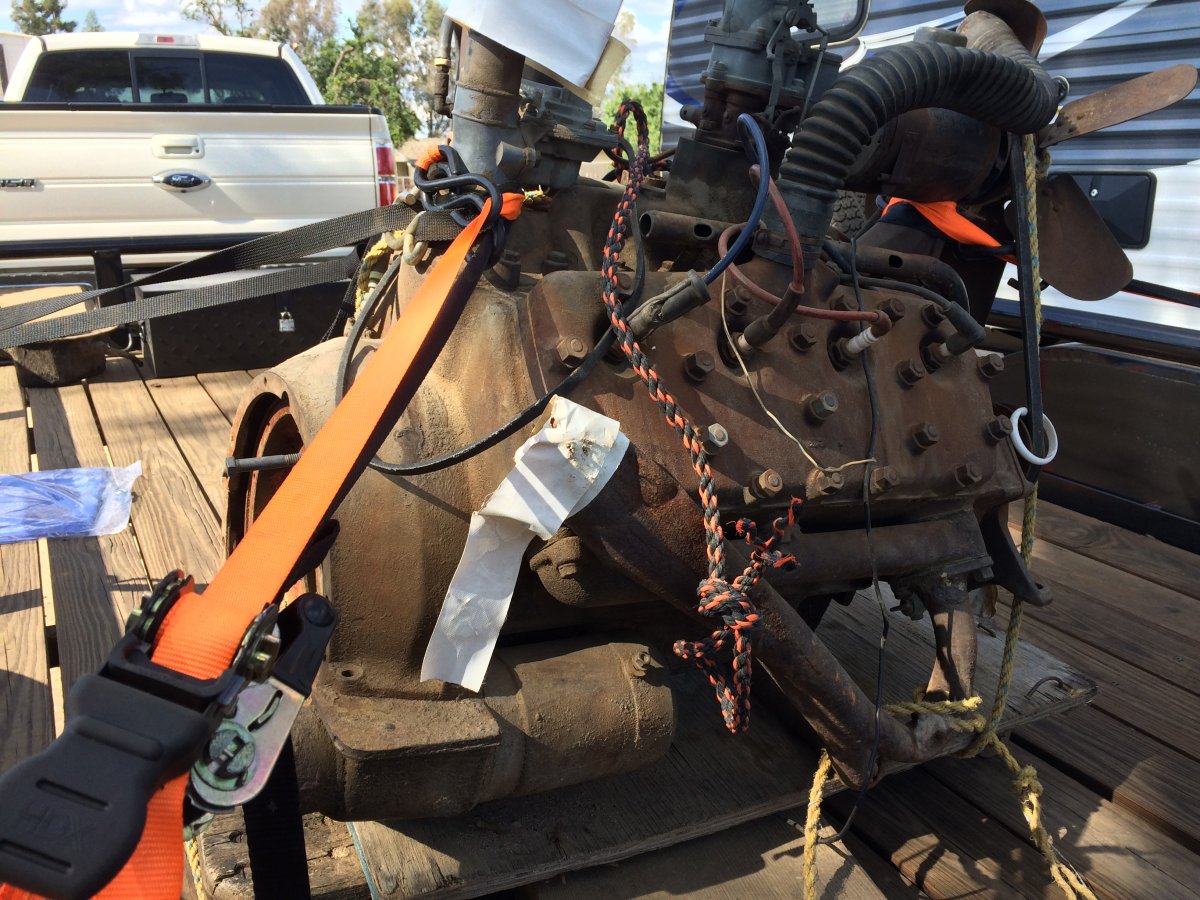

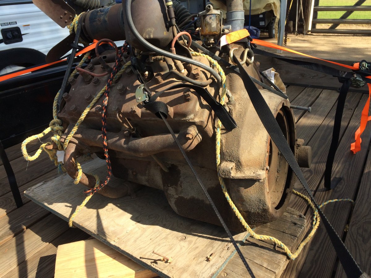

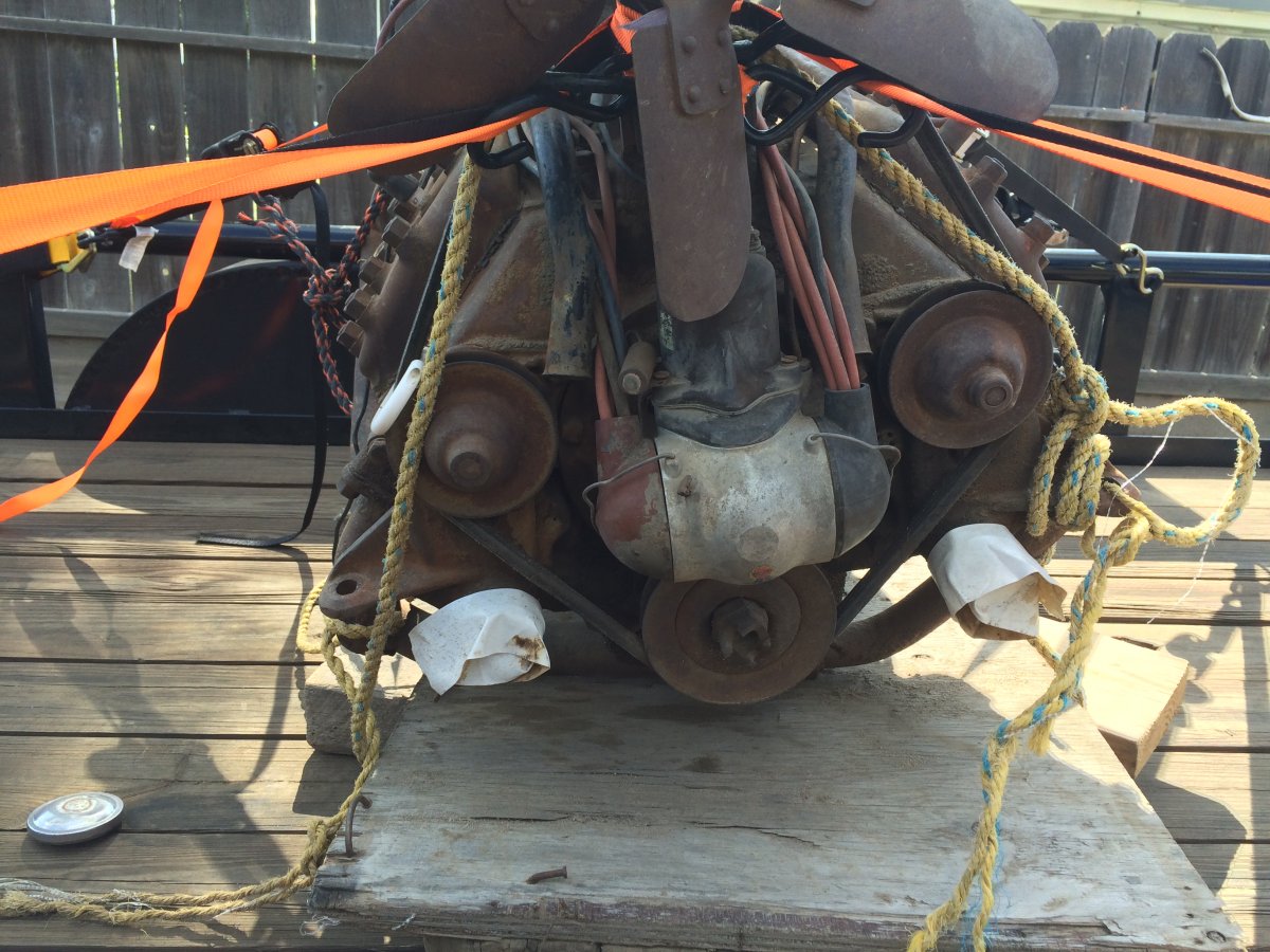

    image.jpeg image.jpeg image.jpeg Picked up the engine today...its about as complete as they get...ended up paying $300 for it. I will pull the pan and heads soon to get a better look....thanks for all the responses guys...oh yeah the rope was already attached and free...what a deal

    from everything i can find this should be a 37 with insert bearings. can anyone tell me what model it is, such as 8ba, 59ab and such thanks im pretty pumped about this motor got the ****** and bellhousing. the ****** has a lever to, i believe lock out reverse type thingy this whole setup was in a 34 one ton

    It's a model 78, the general '37 clasification. Heads will have PN beginning with 78 OR 79, which is the designation for slightly lower compression truck heads. FWIW, this engine was used '37-much of '38 here, and was built in England right through WWII and up to about '54.
    Truck trans would have three rows of shift rails on top, be astoundingly heavy, and have a little trigger on shift lever as reverse lock. P***enger trans will go right on.
