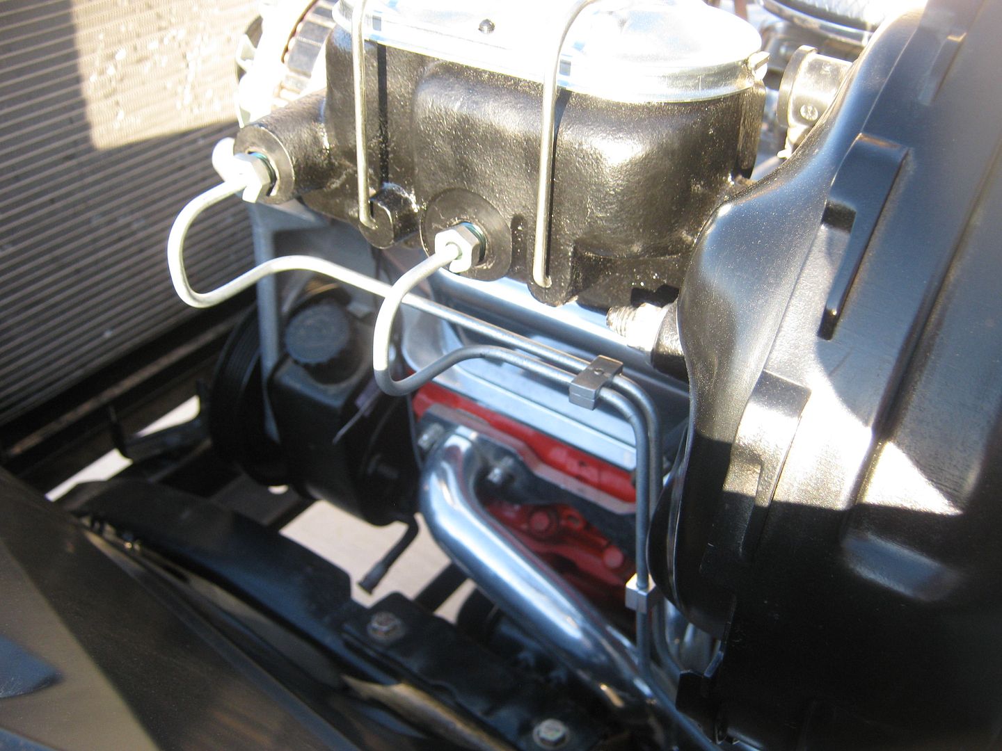

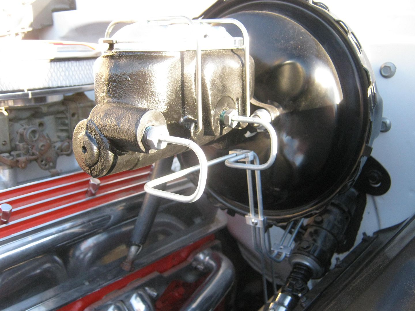

    I spent the afternoon yesterday getting the master cylinder lines bent so I could test fit them in the truck. I had to do a lot of measuring and taking the master cylinder in and out multiple times before I started bending lines. The lines are still only about 80% done, as I still have to figure out how I want to terminate them at the frame rail so they can continue to the front and rear brakes. I'm glad to be done with this part because I'm certain that it was the toughest section of lines to make.
