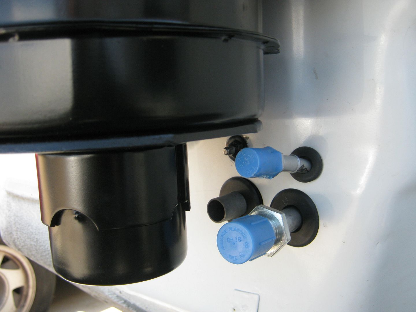

  3. I've been busy working on some of the smaller stuff that has to be done before the motor and trans can go in. The steering column is almost finished (pictures coming soon), the heater control is now restored, and I've been working out the small details on the A/C, namely the evaporator box. I'm a real stickler about weird stuff like wiring and hose routing, and the evaporator fittings protruding through the firewall was one of those cases. I didn't want a gaping hole with a small line running through it, so when I welded up the firewall, I did a test fit of the evaporator and adjusted the hole sizes to fit. Instead of a big hole with tar tape wrapped around the line, I wanted bulkhead grommets for a nice, clean look. After having the evaporator in and out dozens of times, I finalized the hole sizes, and then it was time to weld on the receptacles that are compatible with the Parker Beadlock A/C fittings.
    This was a bit more tricky than I expected. I knew that I was going to have to cut up some new fittings or go to the wrecking yard and find something that would work. On my evaporator, the low pressure side was aluminum, and the high pressure side was steel. I had a fitting I could use for the aluminum, so I hit the "yard" and found a steel fitting from a '76 Chevy truck, so I cut it off the hose and it cost me a whopping $2. I had my buddy Mike Jones weld them up for me:
    You can also see the new Throttle Suction valve in that picture. I wrapped the fins in cardboard because they are SUPER fragile and will bend with hardly any pressure. If someone wanted to do this mod for hardly any money, here's the info. For the larger line, use the fitting from a mid-90s Ford Explorer. It's on the ac***ulator, and you'll need a hacksaw to saw it off. For the smaller line, find a '73-'79 Chevy or GMC truck with A/C and get the fitting from the line that goes between the evaporator and the condenser. It's easy to spot. The line is more like a hard plastic than a flexible rubber. Use a razor blade and cut the hose and take the fitting. A word of caution: Make sure the A/C is discharged before you go cutting. Most all of the self-service yards mandate that all fluids and g***es be drained, but it's best to unscrew the service ports and use a small screwdriver and depress the valve core and see if it hisses.

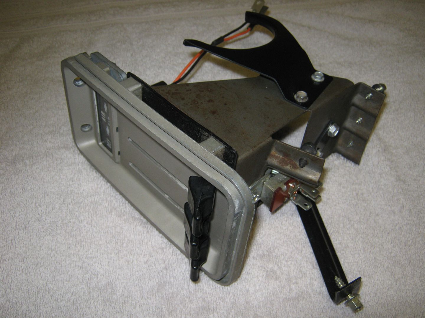

  5. finished restoring the heater control tonight. I wound up swapping in a new fan switch because the original one was really stiff and felt like it was going to break. I spend a lot of time getting the levers nice and free, and they work and feel great. I did not want to respray the face because I want to leave the interior sheet metal in it's slightly-pantina'd condition.
    I am working on a slight twist to the normal operation of the heater control. The issue I have always had with the design of the A/C system on these trucks is the fact that the heater core is always at the coolant temperature (180 degrees+) and the outside fresh air supply has to go past the heater to get inside the inside air box. I want to use the second post on the "Temp" lever to actuate a cable to shut off the water supply to the heater. So when the lever is at the coldest setting, the cable will shut the water valve on the heater hose in the engine compartment, and coolant is no longer flowing to the heater core. I have a feeling that it might make a difference when the A/C is running. We'll see......

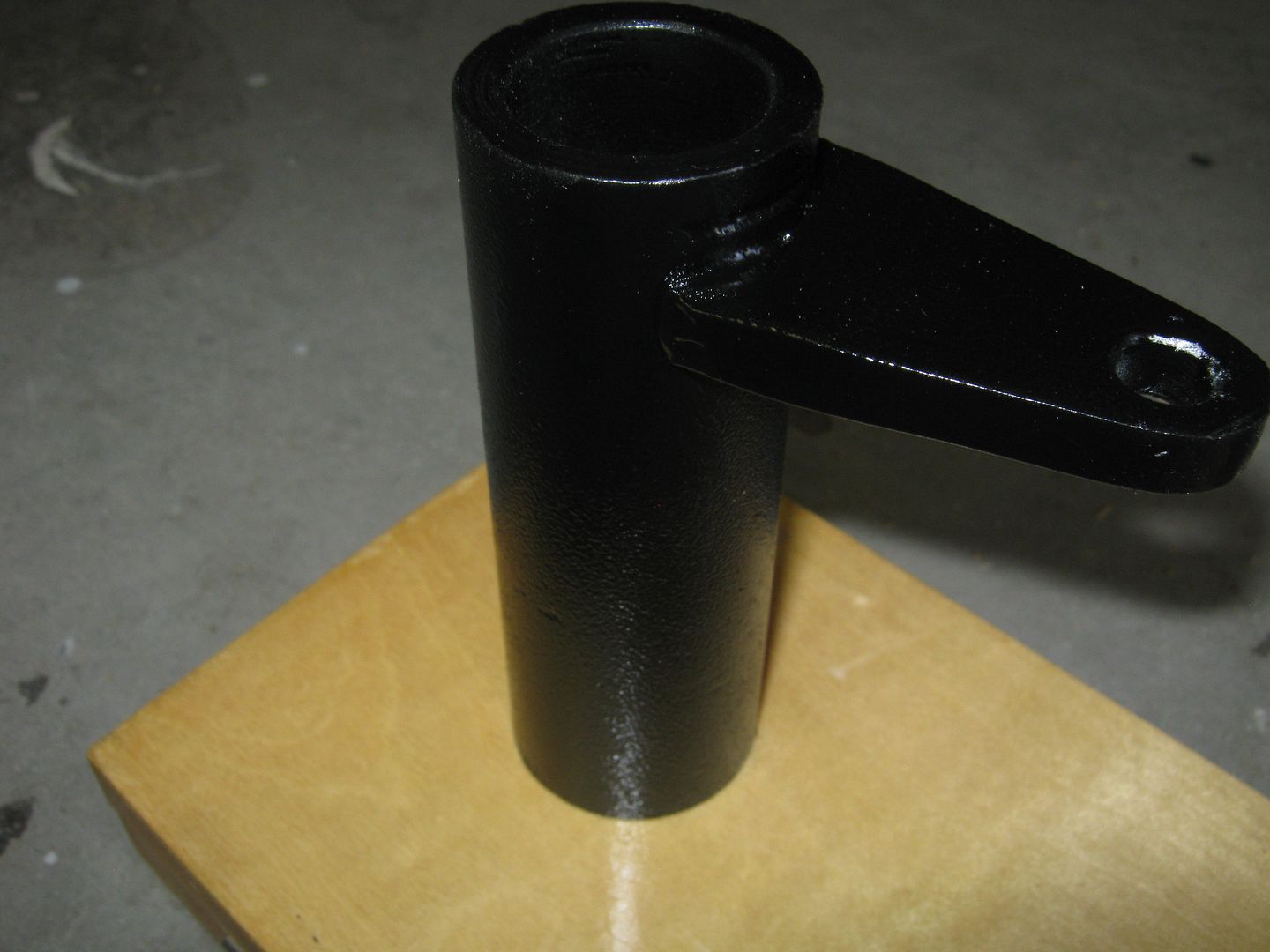

  6. Because I've been working on the interior stuff lately, I have really been thinking about what steering wheel I want to use. I've got a couple of Deluxe wheels, but I'm not crazy about the huge diameter and the thin rim, especially with the power steering I'm using. I don't like over-***isted steering with big steering wheels, so I went through my stash of old wheels to see if there was something that would work. I was originally going to use a mid-60s Vette 3-spoke wheel because I love the way they look, but they are the same diameter as the stock truck wheel. So, I looked a little deeper in the stash and found an old grungy wood-rimmed wheel that I bought at the Hot Rod Reunion swap meet a few years ago. It was nasty, and it looked like the guy who owned it worked as a mechanic because the wood was black (seriously). I paid $15 for it, and the seller looked at me like I was crazy for wanting it. I think it's either a Superior or a Grant, and probably late '60s vintage. Wood wheels in excellent shape go for a pretty good amount of money on ebay, so for $15, I couldn't go wrong.
    After a few hours of scrubbing it with a red scotchbrite and acetone, the wood finally cleaned up. I didn't try to fill the gouges or other blemishes because I wasn't going for perfection. The chrome is in really bad shape, with a lot of thin spots and pits. Once I got the wood where I wanted it, I shot it with a satin polyurethane clear. It got a total of 6 coats, and after every 2 coats (fully dried), I worked it over with 0000 steel wool. Well, the old nasty wheel turned out pretty good:
    The horn ****on is an old one that Brad had in his stash. I have a new one, but the chrome is too nice compared to the chrome on the steering wheel. The jury is still out on this wheel, but it does what I'm looking for: a smaller diameter, it's almost completely flat for extra room inside the cab, and the rim is a nice and thick. I won't know until I get it bolted up in the truck.

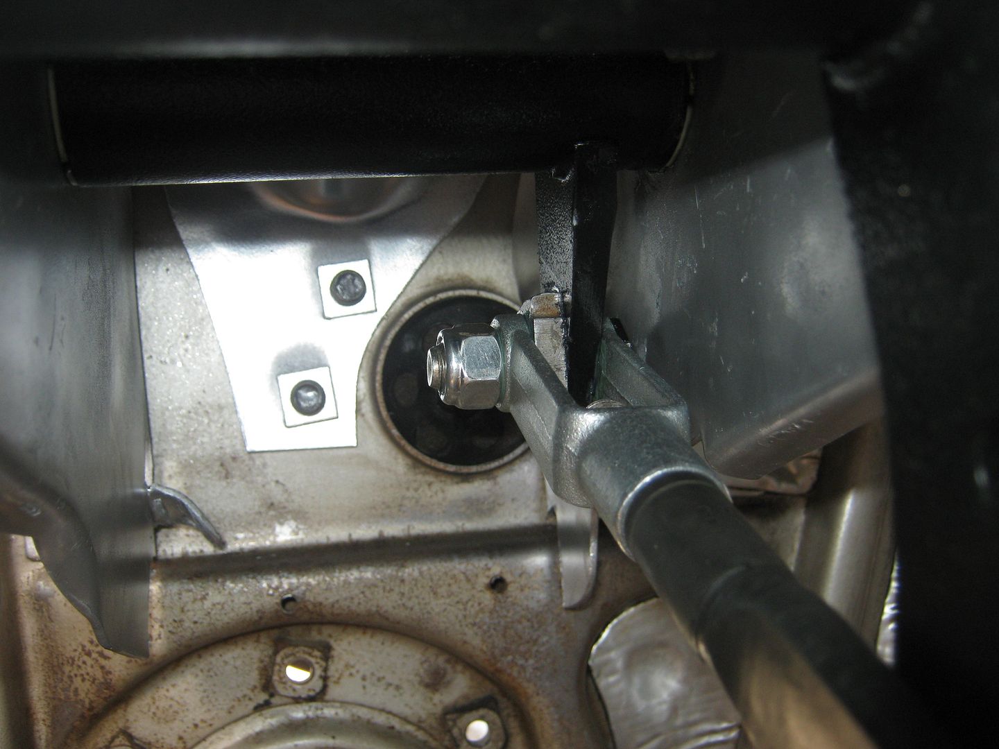

    I have one of Capt. Fab's booster adapter brackets (HIGHLY recommended) and have a 1996 S-10 booster. The biggest issue (at least to me) about using a late model booster is what to do with the eyelet on the end of the booster rod. A lot of guys will chop them off and re-thread the rod for a clevis or a heim joint. I actually LIKE the eyelet, but just couldn't figure out how to integrate it into my linkage. The only way for it to work was that it had to be supported so the booster rod would stay in a stationary arc. I pulled the pedal/clutch pedal ***embly out of the truck and noticed that there was an unused hole about 3" back from the brake pedal hinge pin. It was obviously used on another truck application, probably the C60 and up models. I measured the i.d. of the hole, and came to the conclusion that it was the exact same size hole as the brake pedal hinge pin. Thank You, GM!!

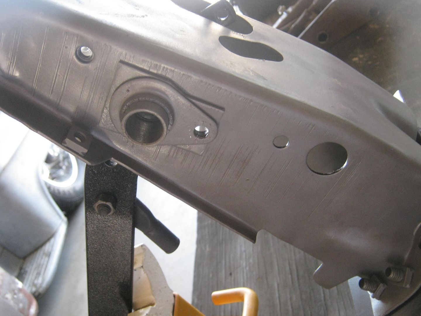

    Now, I knew how I was going to support the booster eyelet. I went to the wrecking yard and got another brake pedal and hinge pin. I wound up getting the entire ***embly for $12.50. In this picture, you can see the pin slid into the previously un-used hole, and the attach bolt lined right up.
    Here's the trial run mock-up. I did a quick chop on the extra brake pedal and basically turned it into a bellcrank. The existing hole in the brake pedal for the factory brake linkage worked out fine. You can see that the clevis on the brake pedal (the pedal painted black) will now attach to the tab on the chopped pedal.
    Here's what the chopped pedal looks like after a little grinding and some paint. I want this to look 100% factory.

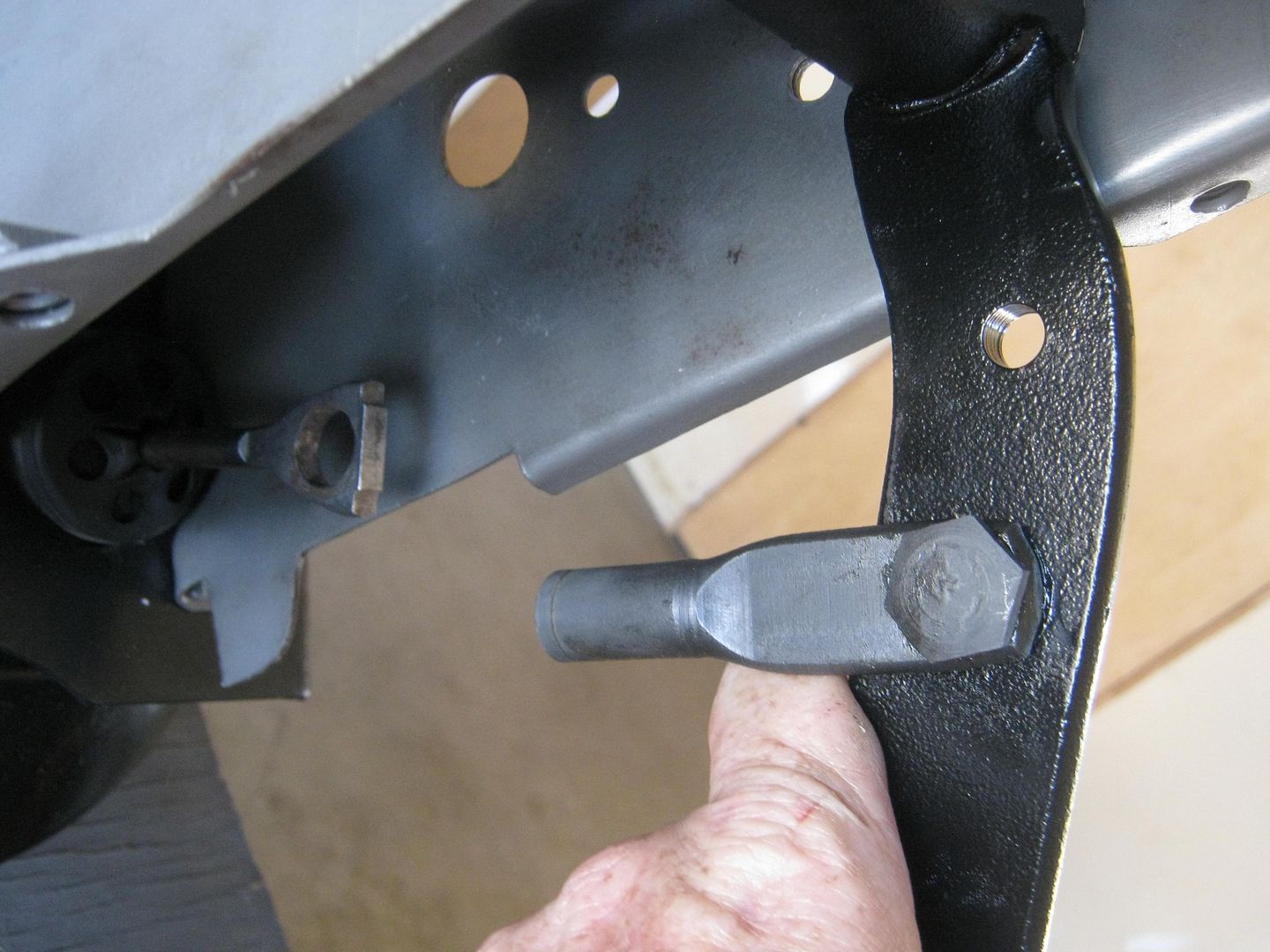

    Here's a picture of the set-up mocked in place. You can see how the bellcrank now supports the eyelet. You can also see the reinforcement pieces around the penetration holes for the hinge pin on the rear pin. I drilled out the spot welds on the piece I got from the wrecking yard and spot-welded the plates to the pedal support in order to make it all look factory. The issue now is how to attach the bellcrank to the stock brake pedal.
    It had to be a clevis of some sort, preferably one that captured both sides of the bellcrank/booster rod connection. Brad was at the bolt shop and they had the perfect clevis. It's about 2.5" long, and the span of the jaw was .500", and it was a whopping $5. I measured the total width of the booster eyelet and the bellcrank tab, and it was .585", so the jaw was opened up slightly. The clevis is threaded on the end to accept a 7/16-20 fine thread bolt, just like the factory linkage. The only goofy thing about the clevis is that the eyelet holes are 7/16", so the factory hole in the brake pedal (which is now the bellcrank) needed to be opened up to 7/16". The eyelet in the booster is .640", which means that you will need to find or fab a bushing with an outer diameter of .640 and have an inner diameter of .437 (7/16"). I found a bronze bushing at Lowes with an o.d. of 5/8" (.625) and an i.d. of 3/8" (.375)., and it cost $3.88. The o.d. would work, but I opened the i.d. to 7/16" and chopped the total end to end length to .275. It worked perfectly. The linkage rod is merely a 2.5" 7/16-20 set screw, and it cost $1.80. The through bolt is a Grade 8, 2" long. The bolt head had to be ground down to about .250" tall in order to clear the side of the structure when the brake pedal is depressed. After all of the attach points were greased, the linkage works like ****er, and the booster rod depresses the plunger with very little change in height. Another thing that this mod did was move the brake pedal closer to the floor. No longer will you have to lift your leg completely off of the seat to push the brake. Mission accomplished!
    Sorry for the long explanation, but I think that this mod will help anybody wanting to make their brakes work better and have vastly improved ergonomics. Plus, it was cheap, and I like that!!
