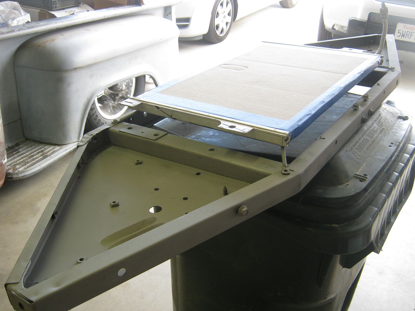

  12. I have been working on mounting the A/C condenser for the past couple of days, so I figured that I should post up the progress. I have an original condenser that came out of a parts truck, but it's so fragile that it feels like it's going to crumble when you pick it up. Plus, I am converting the system to R134, and I need an efficient condenser designed for the current refrigerant.
    I was able to find a guy on Craigslist selling a condenser out of a 1999 Z06 Corvette, and after he rattled off the dimensions, I knew it was going to work perfect. Here's a picture of it sitting on top of the core support. The width and height is perfect, but the inlet and outlet fittings were going to be a problem.
    So, I got out the cut-off wheel and commenced to cuttin'
    I had some square tubing in my s**** pile and made some pieces to cover the removed areas and tacked them in. I also chopped off the original outlet line because it wasn't going to work for my application.
    The stock Corvette mounting tabs were not consistent from side to side, so they got whacked.
    Grabbed some aluminum from the s**** pile and made new mount tabs and make my buddy Mike Jones TIG them in place.
    Fast forward a little, and I drilled the core support for the AC bulkhead fittings, and shortened and reshaped the dryer clamps. I chopped up some new fittings to accept hoses at the inlet and outlet lines and had Mike TIG them on. I installed the old mock-up dryer and started mocking up the lines and have a couple of the hoses ready to crimp. I still need to get a #10 female straight fitting for the inlet line at the top and cut the hose to length. The mounting tabs will need to be drilled for mounting bolts and rubber isolators. Once this gets done, I'll blow it all back apart and send it back to the sandblaster to get it touched up due to all the grease and oils from working on the condenser. After that, I'll do a little body work, and it'll be ready for primer and paint (ch***is black). Speaking of black, everything you see on this core support will be painted black because I do not want to see anything behind the grill of the truck. I always think that it looks wrong when I see shiny stuff behind the grille or body-colored core supports. You have to hide that stuff!
