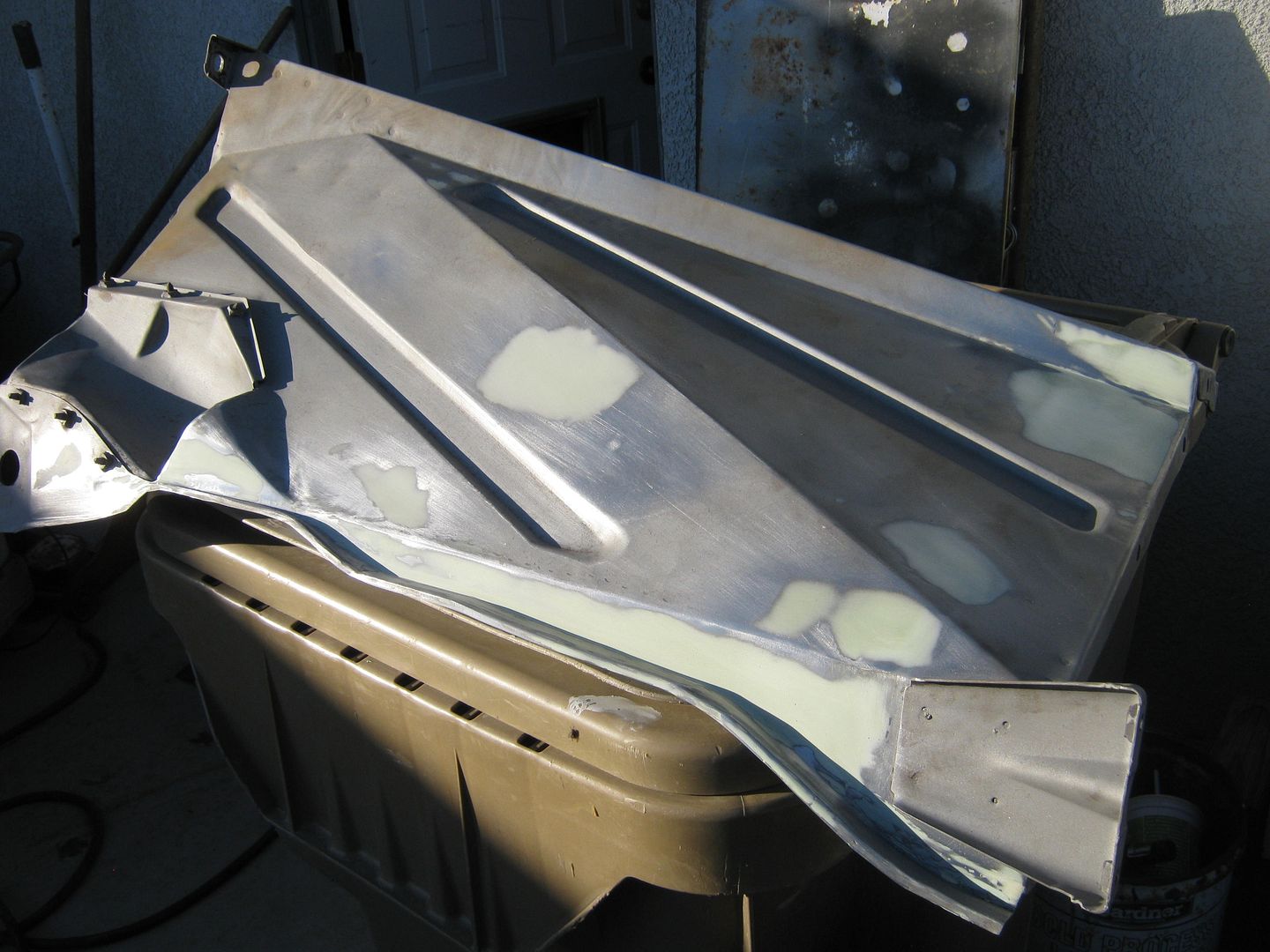

  14. It's been awhile, but that does not mean that I haven't been bustin' on the '64. As a matter of fact, I have been doing a lot of work, but it just wasn't exciting enough to post up pictures. Most of what I was doing was bodywork on the inner fenders and prepping the under-hood parts for paint. Man, I have a real respect for the guys who do bodywork for a living.
    If you remember, I took out a 2" lower section of the inner fenders to compensate for the 2" Z we did on the ch***is. It was important to me to have it all look factory, so that meant that I had to do some welding and bodywork. Here's a shot of the driver's inner fender right before we primed it.
    And the p***enger side:

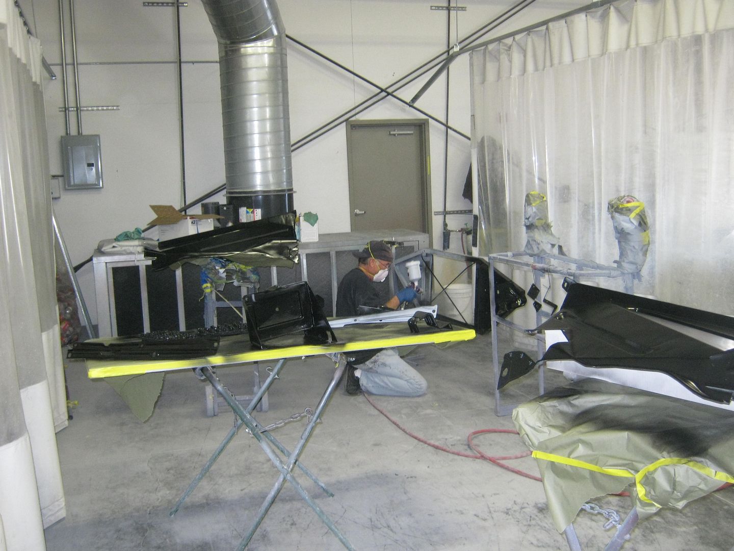

    So after a bunch of sanding and prep work, the parts were ready for paint. Brad offered to do the spraying, and another buddy, Ryan, offered up the use of his shop. A big thanks to Brad and Ryan for doing this!

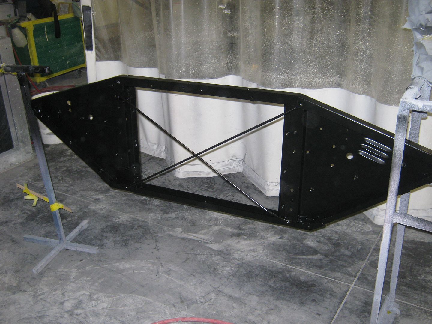

    The funny part of this is that the paint we used was a Frankenstein mix of a couple of black enamels and it turned out perfect. I'm a stickler for ch***is black, and it has to be the right sheen to look "right", and this batch has the perfect eggshell sheen I was looking for. And to top it all off, instead of using the high-dollar Iwata spray gun, we used a $15.99 Harbor Freight special and it worked incredibly well.
    The next step is to ***emble all of the stuff on the core support and start installing parts! More pics to come...
