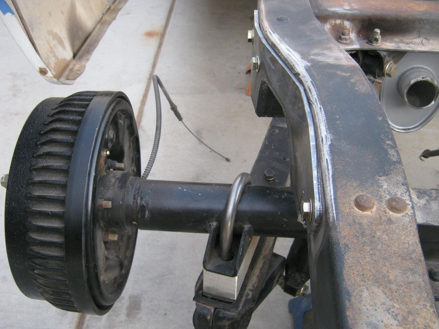

  4. Finally got the notches installed. I have done notches before on '73 and up Chevys, and these were by far the most difficult ones I have ever done. Every part of the install area was either double wall or triple wall 3/16". Cutting it was no fun, and drilling was even worse. I wound up breaking a total of 5 drill bits. With the thickness of the metal, once the drill bit caught, you were going for a ride. I used a torch and warmed up the top portion to make it fit the contour of the frame better because it's getting fully welded around the entire perimeter of the notch.

    Hey flat n low next time you have to drill any truck frame that is thick or double wall, try using a tapered reamer , start with a small dia. Drill , then use a tapered reamer to take it up to the size u require . I have a set made by Lawson products , they are designed for this purpose, slow speed 1/2" drill with a swivel top handle will not send you for ride when it catches, I have drill many holes (reamed) in frames and axle flanges , works slick as shat !

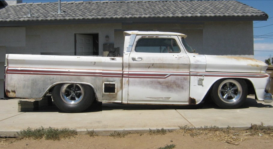

    Chop it, drop it, shorten it!!!! ;)

    That is BAD ***!!! I gotta stay on target and not get sidetracked, but if I saw picture that at the beginning of the project, sparks would have been flying! Thanks for the PhotoChop, I'm definitely saving that one.

    I drove one of these that was chopped as a parts hauler in the early eighties for a resto shop I worked at. Just seeing that picture made my head do the turtle thing and **** down between my shoulder blades!

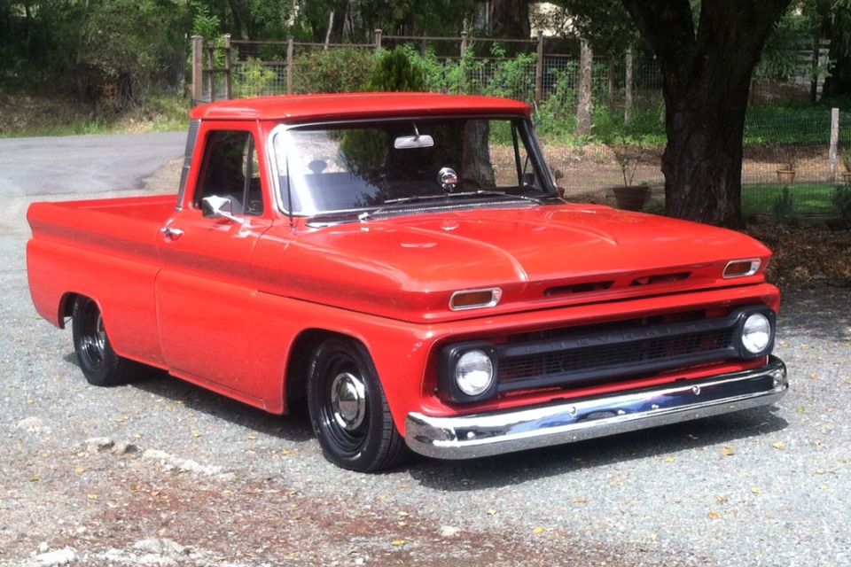

    *****in! You could say I have thing for these trucks...if you need any parts let me know. ImageUploadedByH.A.M.B.1392946878.066605.jpg who'da thunk they look good chopped!

    Mr. MUNDSTER, if that is your truck, the stance is perfect! Nicely done. If you are dealing parts on these, I'd sure like to get my grubby hands on an original a/c dash insert like Mr. Flat-N-Low's.
