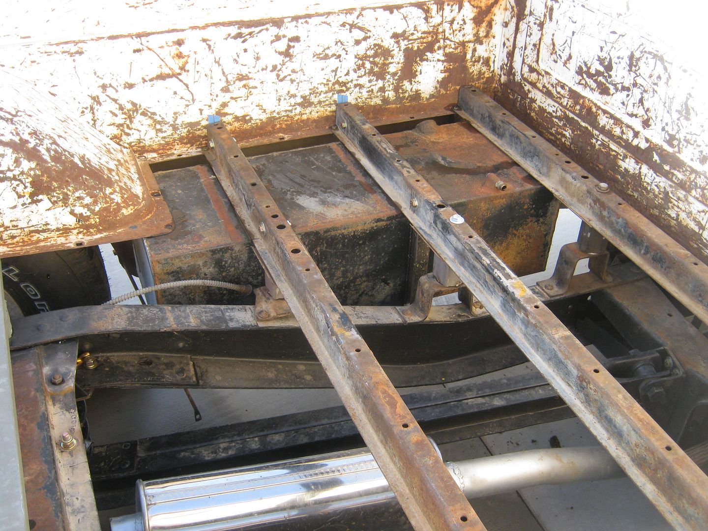

  9. It's been awhile since I posted, and I was hesitant to post any pictures of what I've been doing because I wanted to complete some of it first, then do a start to finish explanation. Today, I was doing a bunch of stuff, so I took some pictures to show a little bit of what's been going on.
    This is an unattractive picture, but it shows how I raised the bedfloor 2.75". The bed wood usually goes underneath the flange that goes around the perimeter of the bed. I decided to mount the bed wood crossmembers on the top side of the flange, thereby raising the floor by the height of the crossmember (2.75"). The two primered crossmembers are ones that I made to support the floor in the area adjacent to the wheel tubs. In the stock configuration, the bed wood rests on the tops of the frame rails. Now that I raised the floor, there was no support for almost 36", so the crossmembers will now provide support. Without the supports, the wood would have snapped as soon as you stood on it.
    Right now, I'm in the mock-up stage. When I'm done, everything from the cab to the back bumper will get removed, sandblasted, and painted ch***is black.
    I removed the gas tank from the cab to gain more cab room, and I didn't want to mount the tank between the rear frame rails because I want to utilize the factory spare tire location. So, that meant that the old saddle tanks that I almost threw away would be put back into service. Because the bed floor was raised, I built new tank mounts and moved the tanks up as high as they could go. I plan on sending out both tanks to Redi-Strip to be chemically stripped. When they get back, I will install new sending units and a vent system, and utilize the GM fuel tank solenoid switch from the '73-up trucks. I want to be able to switch tanks from inside the cab and use all factory parts. I was going to get really trick and fill the tanks using the factory filler neck, but I think I'm going to put access doors in the bed floor to fill the tanks. Here's a picture of the nasty looking saddle tanks.
    I've been spending way too much time trying to save the original bed wood. It was cracked and broken everywhere, but after a lot of biscuits, filler shims, epoxy, and Liquid Nails, it's starting to come together. There is so much epoxy in those pieces that it they ever caught fire, they would melt instead of burn. I plan to cover them all with deck restoration paint, tinted in black. The bed strips will be sent out for powder coat. The wheel tubs were also moved up. I had to cut into the stake pockets so the tubs would clear, but it all looks factory. Here's shot of the wood just setting in place, with no bed strips.
    I was also able to install the 67-72 Fleetside rear bumper. I still need to do a little tweaking, and the license plate box is a '73-up, which puts the plate at too much of an upward angle. I am probably going to build a new box, unless the factory 67-72 box solves this issue. Can anybody tell me if the license plate boxes are different?
    That's enough for today. Tomorrow, I might try to tackle the spare tire mount.

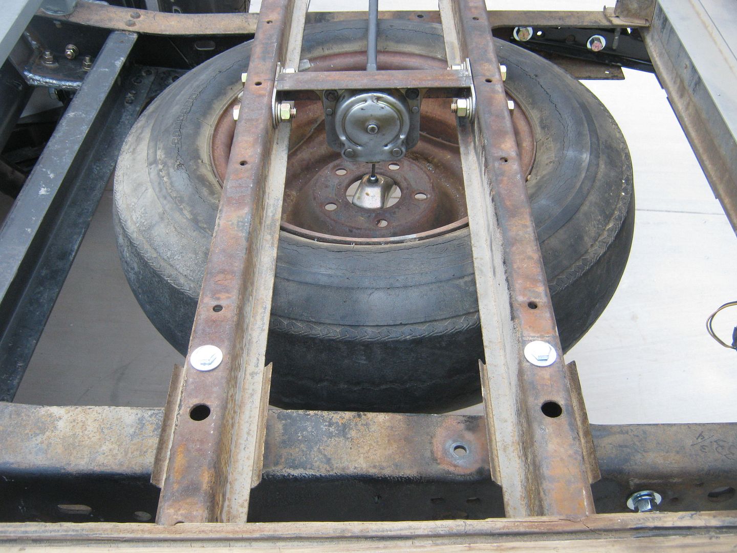

  16. I did some work on the spare tire mount yesterday. I wanted to use the factory spare tire mount location, and now that the bed floor is raised, I have a little more room to tuck the tire up and out of sight. I don't like the look of the spare tire hanging down when it's up and installed. I also never cared for the clunky factory spare tire bracket and how much of a pain it is to take the spare in and out.
    The first step was to blow out the rivets on the two spare tire crossmembers and remove them. One of the crossmembers is the small u-channel one on the top of the frame, and the other is the thin sheetmetal one about 12" back from the u-channel. This now makes an open space that if you place your spare tire winch correctly, you can stow a 27" tall tire between the frame rails.
    I went to the local wrecking yard looking for a suitable spare tire winch, and unfortunately, our yard likes to use the area where the winch is to prop up the trucks, so there were hardly any that were accessible. Lots of guys have used Ford Ranger winches, but I could access any, so I wound up using a mid-'90s Blazer unit.
    I built a simple bracket using a section of 1.5 x 1.5 angle iron, and I welded in some tabs on both ends. I wanted it up as high as it could go, so I made it level to the tops of the bed floor crossmembers. I went a little over-kill on the bolts (1/2" diameter, 2.5" long, Grade 8).
    I mocked it up, using the two aft bed floor crossmembers as the supports. I could have mounted it one of two ways. Either with the jackscrew facing aft, or facing to the side. I would have preferred to have it facing aft and have the end of the shaft extension wind up behind the license plate, but that wasn't possible. When I raised the bedfloor, the bedfloor crossmembers went up 2.75", but all the other crossmembers stayed in the same location. The jackscrew shaft would have had to change direction a few times in the 18" distance for it to work, and even with a flexible shaft, that wasn't possible. So, I decided to move it to where the jackscrew faced to the p***enger side. The reason for the p***enger side is because if I ever have to change out a tire on the freeway, I don't want to be laying out in the road trying to get the spare tire out. I wound up using a factory GM flexible shaft from a mid-'2000s Chevy/GMC truck. I haven't built the bracket to support the end of the shaft yet, and I'll do that today. It'll be a bracket that will bolt to the p***enger side frame rail with a tube welded to the top. The tube will have a .750 inner dimension, and the extension will slide inside it. The end of the extension will have a 3/8" end on it where I can use a ratchet to raise and lower the tire. Here's a picture taken from the p***enger side.
    Driver's side
    From the rear looking forward
    Here's a picture from underneath. It's a bad picture, but you can see that the spare is completely tucked out of sight. The bed floor crossmembers are now the "stops" for the tire. The tire sidewall is even to the bottom of the frame rail. You cannot see the tire at all unless you get on your ear and look up. Disregard the old tire and wheel. I found one in my pile that had the size I needed, and this was only used for mock-up. You go with a large as a 27" tire. You could probably go a little more if you trimmed the frame rails.
    Next step: Building a trailer hitch. The hitch crossmember will also restore the frame strength that was lost when the two spare mount crossmembers were removed.
