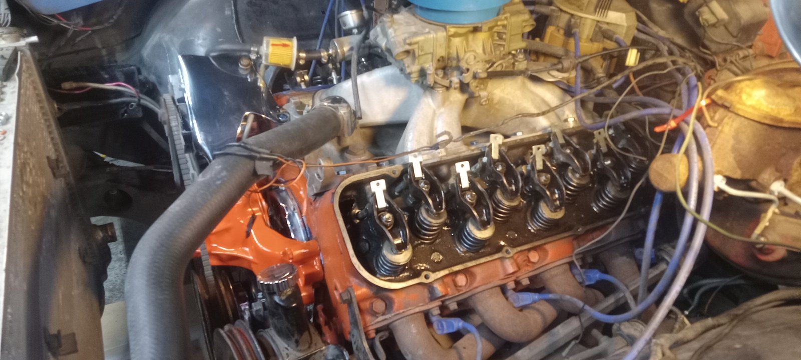

    Just broke in this BBC comp cam. Pulled intake to fix vacuum leaks, cam lobes look good, watched pushrods from start.....all spinning fast.
    Replaced his Holley Strip Dominator intake with a lower volume Edelbrock Torquer 2-0. Runs great, starts like a champ.
    We good to go.
