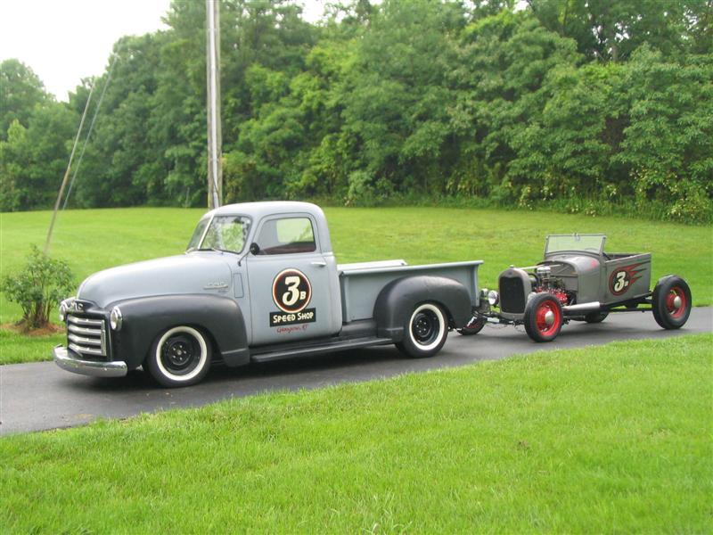

    Thanks fellas, I was just worried about the trans not getting lubed. I’ve flat towed my stuff several times. On my old truck with a Muncie trans I disconnect at the rear differential and tie the shaft to the safety hoop. And my Model A I just pulled a spur gear. Both pulled nicely behind my little GMC Canyon.

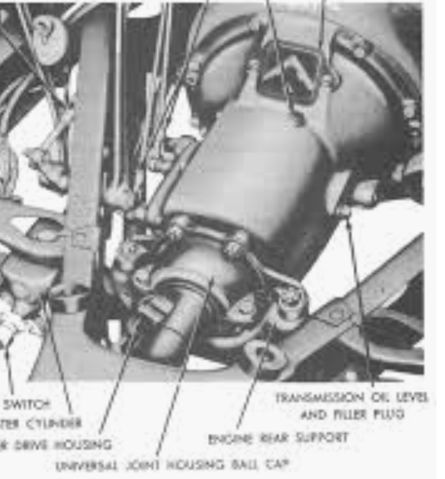

    Flat towing most manual transmission long distance can cause problems. Most transmissions get oil from the cluster gear spinning. When towing the cluster gear does not spin. The pocket bearing and other top bearing will run dry. How far do you need to go before damage? Not sure.
    One way to prevent possible transmission failure or damage, is to stop on the trip and start the engine with the transmission in neutral to lube the upper bearings.
    Some latter transmissions and transfer cases have provisions for splash lubercation from the output shaft and can be towed indefinitely.
    Bones
  21. depends on where the fill location is in regards to the output shaft
    and of course, the amount of lubricant is important
    Boneyard51 and Tim like this.

  24. The higher the fill the closer to the main shaft the less likely for any damage
    If that trans has the correct amount of fluid, towing should be fine.

    Make sure the trans and rear axle are full of lube, trans in neutral and you are good to go. Nobody worried about this until automatic transmissions came along. Most only have a front pump, if the engine is not running they get no lubrication. Manual transmissions lubricate themselves, they don't need a pump.

    I almost seized up a '39 Ford top shift box towing it 30 miles!
    The rear bearing had no lube and transferred some metal from overheating.
    Topping off the lubricant(to top of box) would have probably saved it.
