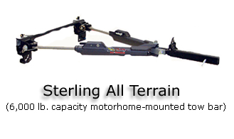

    If you make up your own baseplate and pull the gears from the rear.roadmaster makes a real good aluminum tow bar that will do 6000 pounds.It is there sterling model.Its a little pricey,But just like anything else you get what you pay for.

    Heres 1 !!
  26. Rusty
    Joined: Mar 4, 2004
    Posts: 9,487
    Rusty
    Yeap that is it

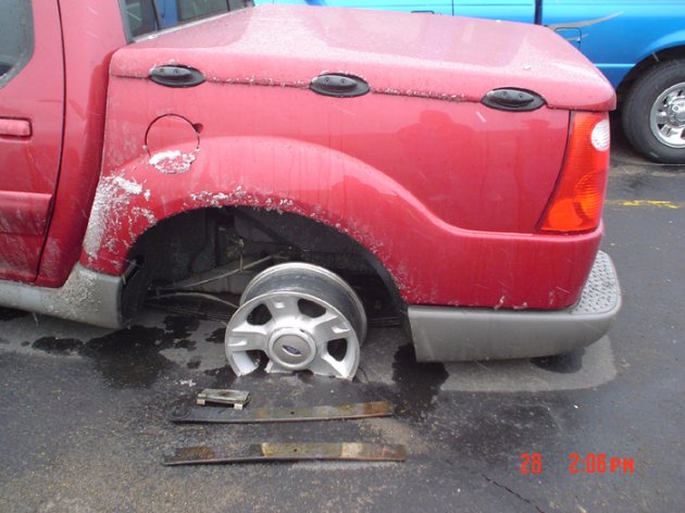

    saw this pic a couple years ago. i still laugh. must have been a big diesel pusher , or a completely oblivious driver.
