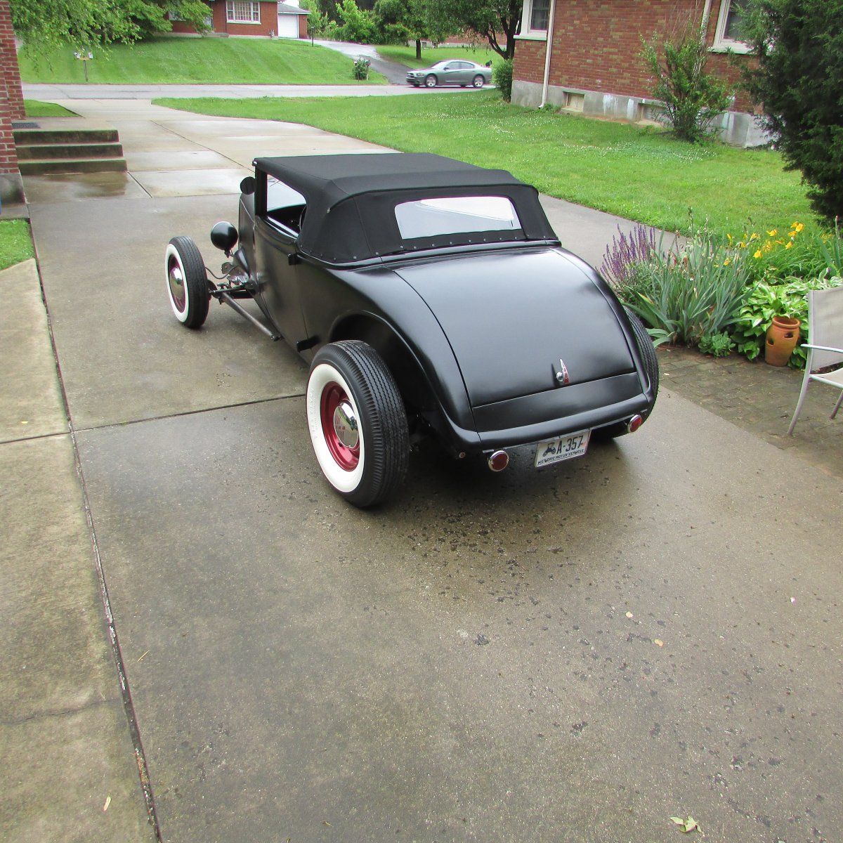

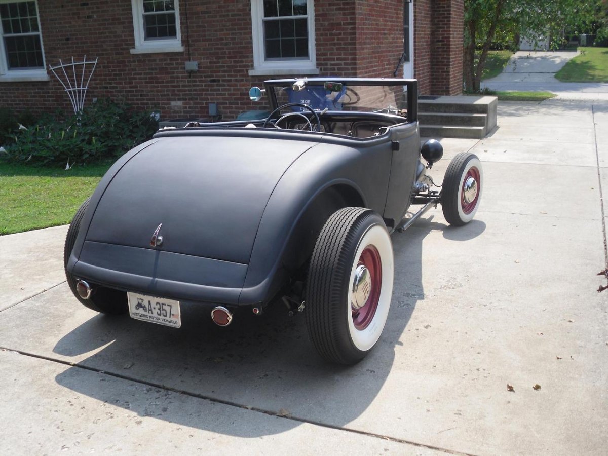

    003.JPG 002.JPG For comparison. First shot is black lacquer primer, second is "Kirker" hot rod black, satin urethane primer.

    Like Tim,I used Kirker SG Hot Rod Black.
    The photo below shoes just how well the finish holds up,6 years and still looked great.HRP
