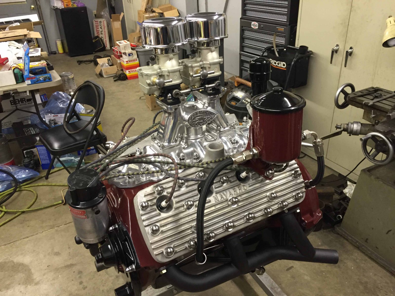

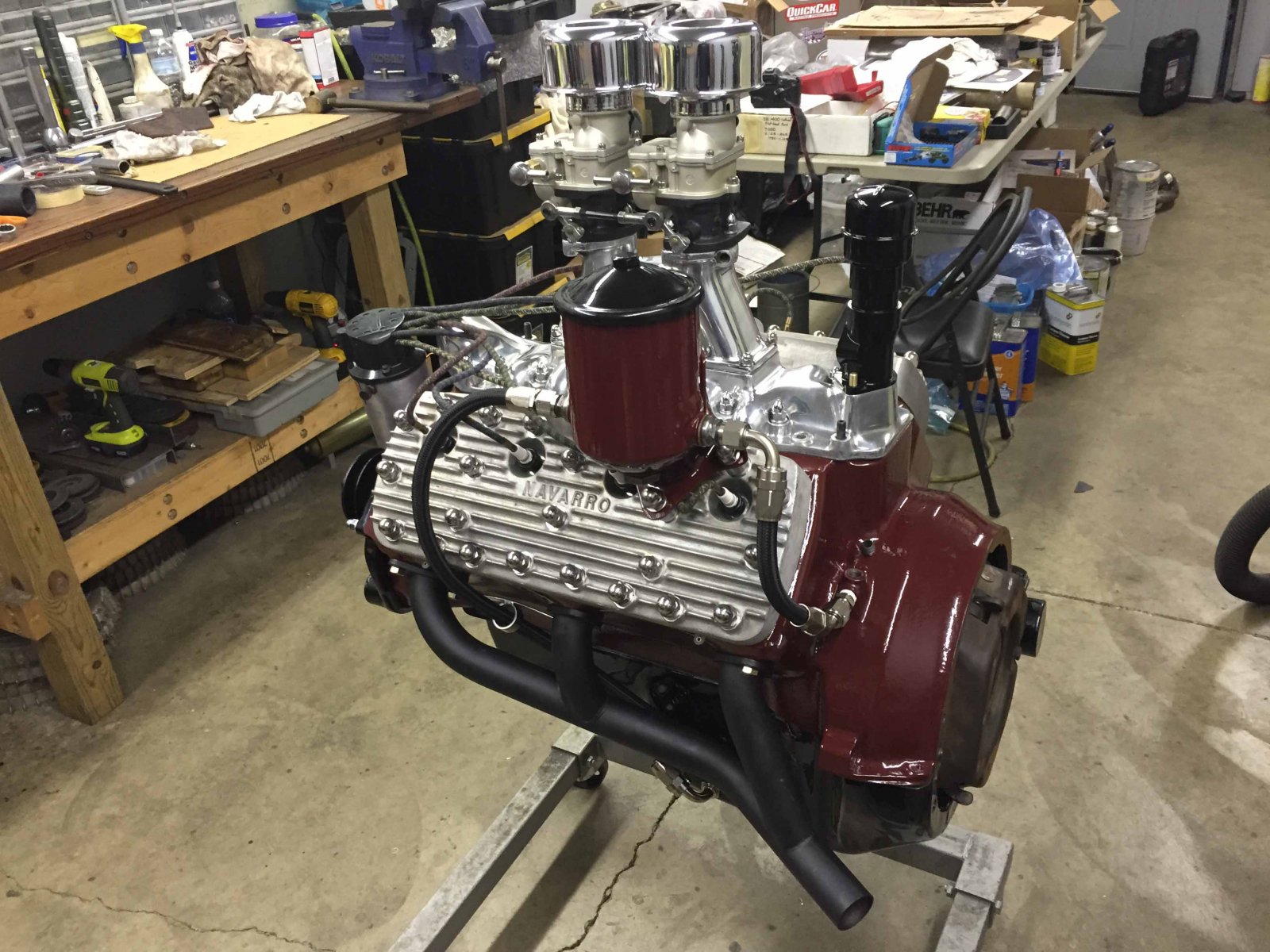

    Here is the latest ***embly stage on the stand . . . have yet to paint the generator and fan, it will be done shortly. Also, need to put some better plug wires (probably Packard 440 if I can find it), Rajay plug ends, mount the fuel pump and run the lines.
    So here it is . . . and don't give me any grief over the later Navarro heads or damn braided oil lines . . . I know, I know, I know . . . feel my pain! :)

    I'm getting close boys . . . and boy do I want to start it and see how it performs . . . but I must wait a bit . . .

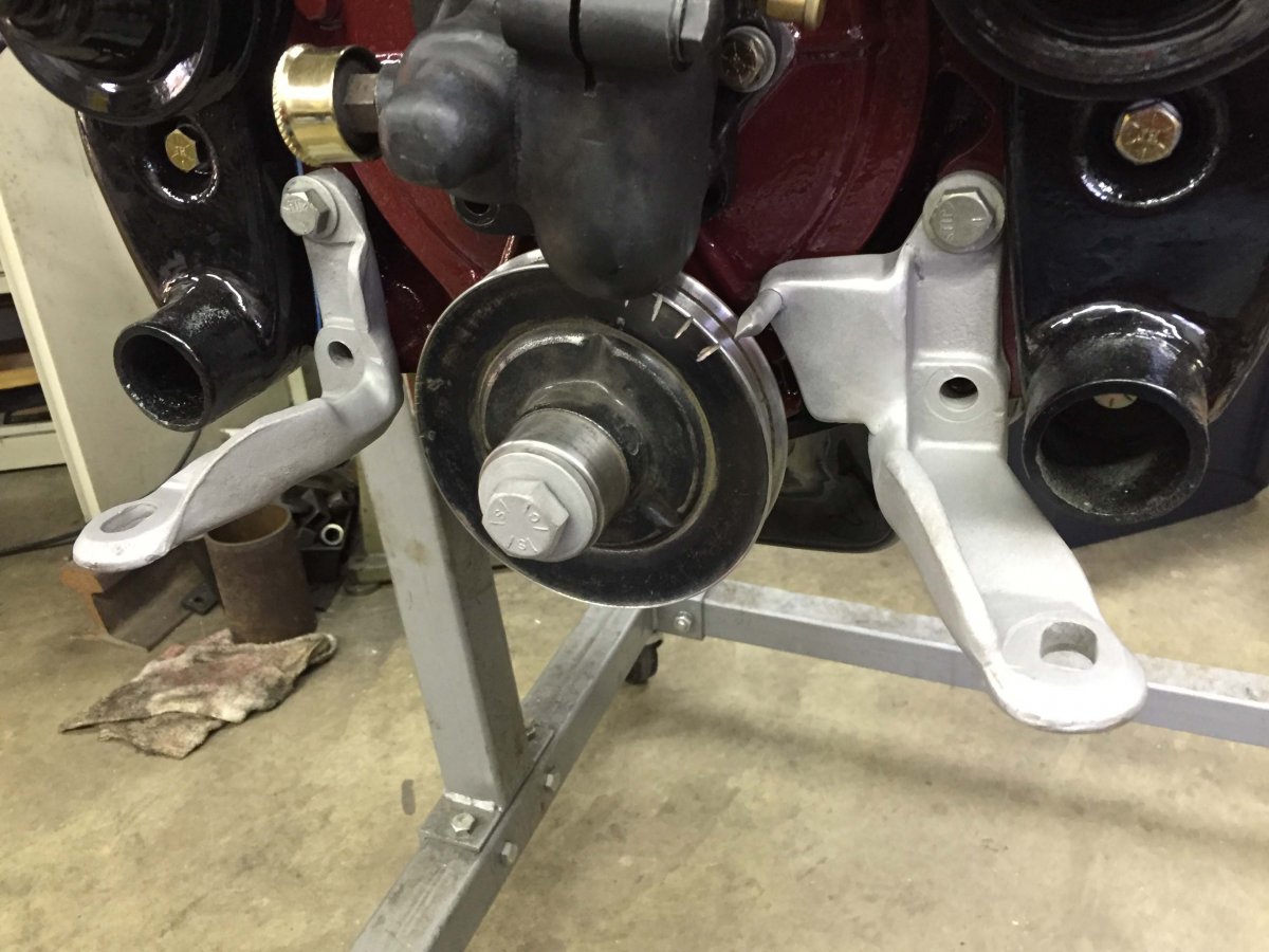

    1) Front of the Motor Work - Problem, Timing Pointer Setup: I needed to come up with a way to add a 'timing pointer' to the front of the motor - and setup/modify a crank pulley to match. I used a late 30's crankshaft pulley (the one that mounted a fan on the front). It was the only one I had that would do the trick.
    2) Cut the Fan Mount Off the Crank Pulley: Even though it clears the 32 cross-member, why have it on the pulley in the first place - so chop it off on the lathe! Then clean up the pulley to look like it belongs on the dang engine.

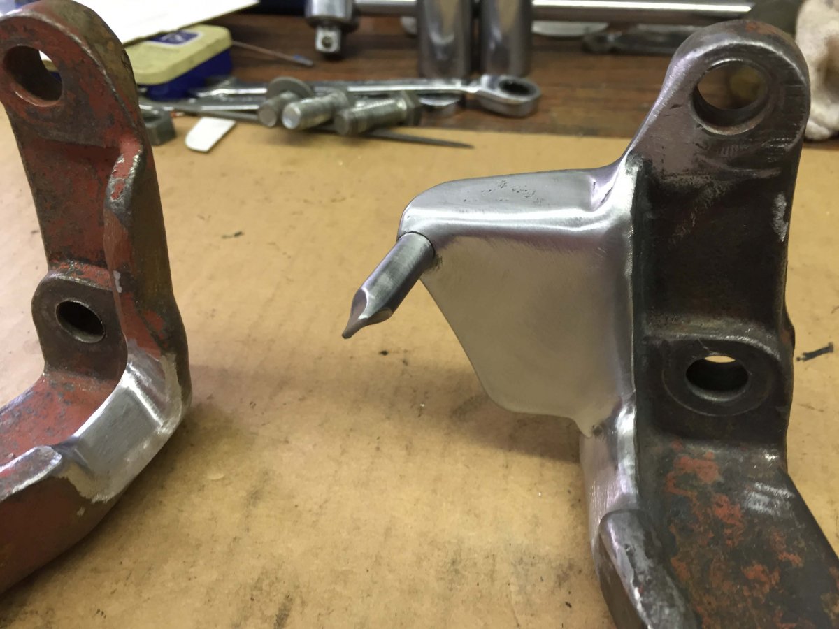

    3) 32 Motor Mounts - Modified for a 59X Engine: As this car had a 59AB in it already, it was using the stock 32 front motor mounts. This is the only year that I'm aware of that used a mount of this sort. This is probably why an original set goes for over $200 on the Bay. Given that a 59AB has a wider fan-belt angle (due to the pumps in the block - instead of in the heads), then it was common practice to take a grinder and notch the stock 32 mounts to clear the fan belt. This had been previously done to my mounts - though I cleaned them up a bit more, added a little more clearance, etc..
    4) Driver's Side Mount - Adding a Timing Pointer: I wanted to create a timing pointer and fabricate it into the stock mount - in a way that at least appears that it could have been made that way. This is one of those easy projects that should take an hour - and takes 4 or more by the time my picky *** is through!
    5) Marked the Crank Pulley for TDC, and 10, 20, 30 before TDC. I used my big degree wheel to move the crank to the correct positions, then put the pulley on each time and ground a new timing mark. I'll paint it and use white in the 'timing mark' grooves.
    6) Front of the Motor: Everything is cleaned up and ready for paint - I liked the way things turned out. Kind of looks like it came this way from the factory (which was my goal).

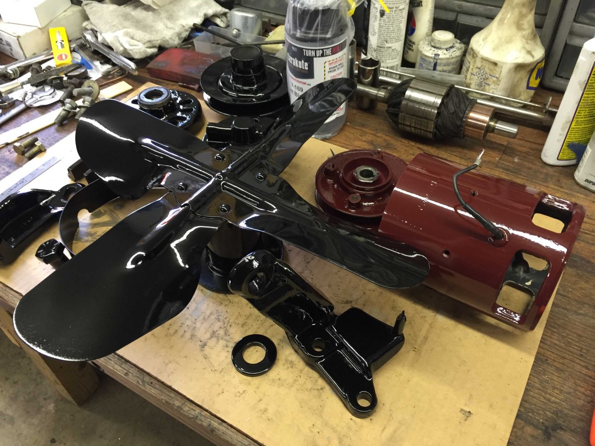

    This is the tedious part of the job - cleaning up all the parts, dis***embling, masking, painting . . . you know the drill. Sometimes I want to be in a big hurry (as the engine being started is close!), but I've learned to keep my focus, continue the quality of work I've done and don't cut corners.
    1) Original 34 Generator: This is the generator that came on the 59AB that was in the car - heck, it puts out 18 amps and works great . . . so why not use it until I get my 'super-duper' 40 amp version made. The only reason I need a high-amp generator is because of the bright Halogen headlight bulbs I've installed - and they are definitely worth it. But, for the short term - I'll just run this old generator. I took it apart - was either a new item or "recently rebuilt" - circa the 1950's when the car was parked. No wear on the armature, bearings were good, brushes looked like new, etc.. There cloth covering on the field coils was a little dry rotted on the front side - so I figured "Hell, mix up some epoxy and coat them a bit" . . . figured it can't hurt them. The armature was working just fine, so hopefully my screwing around with it didn't disturb any of the old winding insulation (these old parts are a bit fragile). I will carefully put it back together, grease the bearings and see if the old girl still works!
    2) Enamel Painting: I used to shoot a lot of enamel - but that was 35 years ago and I was a bit out of practice when I painted the engine block (couple months ago). I had to relearn a few things - so I was happy to see that I did well on these parts, the fan (hardest part to paint) came out really well . . . so I'm back with being good with enamel.

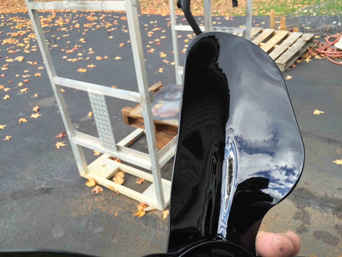

    3) Headers: When I got these from Drake, they came with some cheap black paint on them. I now damn well it won't last worth a ****. I used to bring all my headers down to a place to be ceramic coated - always came back looking okay, but the coatings didn't last all that well either (and cost a ton). Since I've managed to get deep into coatings in general on this engine, decided to blast and coat the headers myself - with coatings that require a heat/bake cycle to cure them. I baked them last night - turned out really well. Now we'll see if these coatings hold up any better than the ones I paid a ton for.
