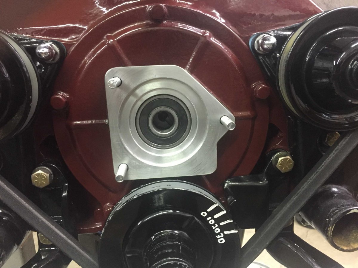

  23. New Magneto Drive Plate:
    The angle drive for the magneto put the edge of the magneto cap - really close to the fan belt. When I originally built the engine, I "punted" and ground the edge off the cap to gain some clearance. Also, I had to "tilt" the generator/fan ***embly off to the Driver's side - to move the belt away from the cap. This has bothered me for a year - time to solve the real issue.
    Move the Mag Out! - Well, what it really needed was to space the magneto out about 1/2" more - which brings the edge of the cap away from the belt and gives me a little bit more room. This will still allow the fan to miss the magneto - with a tight fit, both directions.

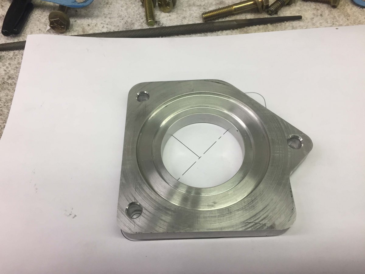

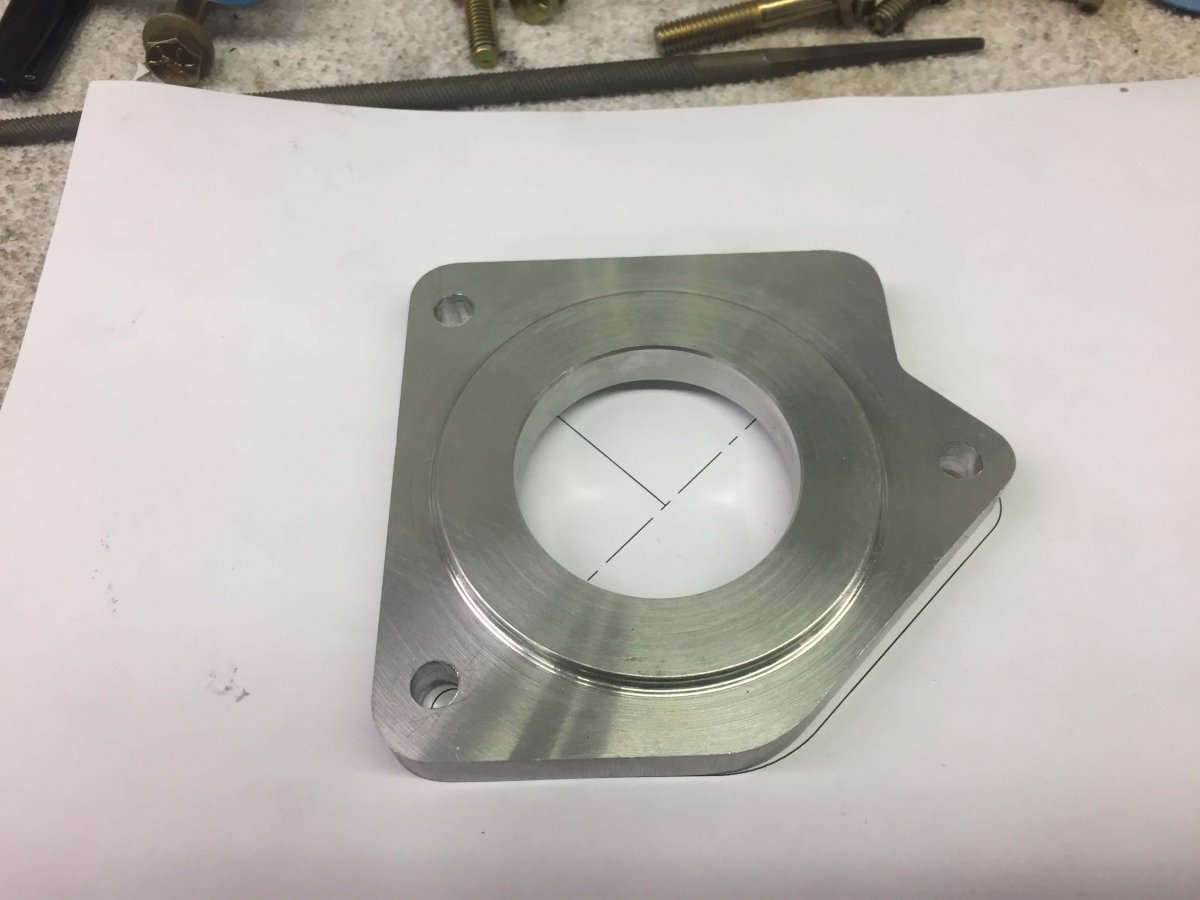

    So, I drew up the plate in CAD, but didn't have access to a CNC milling machine to make a "one off", so time to use my old school mill and lathe . . . the good ole' "traditional way". Takes a lot longer - but the results are the same.
    1) Let the Chips Fly: Here I'm using a 3/4" plate of aluminum, which I'll then machine for a precise flange to fit into the timing cover - and a receiver on the front side to precisely center the mag drive.
    2) Plate - All Done: Here is the plate with the mag drive receiver, flange on the back and bolt holes.
    3) How About a Dang Sealed Roller Bearing: Decided to put a nice roller bearing in the middle and press fit the new magneto drive spud into it. This will give the spud something to run in, keep timing accurate and hopefully last awhile.

    5) Studs: I used studs in the timing cover - makes it a LOT easier to put the two gaskets, the new plate and the magneto on (everything is held in place on the studs) - glad I thought of that at the last moment. This picture is without the 'drive spud' - you can see the slot in the end of the roller cam.
    6) Final Pictures:
    Glad I took the time to "fix" stuff like this - cause if I don't do it now, then who knows when . . .
