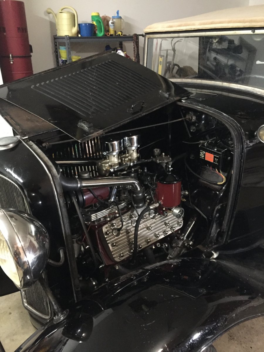

    Went and bought a new battery and had the previous one checked on a load tester - nothing wrong with it. I bought a second one anyway (helps to have a spare in case of future drama). What I think is happening is that my starter is hanging up on the flywheel at times - never did this before, but this is a new oil pan and the starter is registered/mounted off the oil pan. Guess that gives me something ELSE to screw with an figure out. It is always something now isn't it.
    It snowed about 4 inches last night - and they salted the roads as well . . . so the old girl doesn't need to go out in that ****. Rust is the enemy - give it no more chances than it already has on it's own.
    All back together:
    Here is another short video - just of it running in the garage . . . I know, boring . . . but it is all I have today:

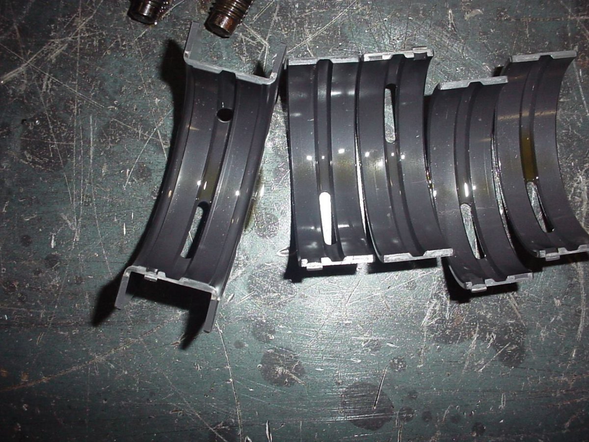

    dale, LOVE this motor build and the use of coatings... and just trying things in general. the timing of pulling the motor apart is interesting as a friend of mine who owns several midgets (I used to race as well) had just sent one of his motors off to the shop to get it freshened after 16 races. It's an essingler motor so it really has no comparison to the flathead but any motor that can run 16 races at full song and still look like this is pretty cool. unfortunately the flathead is no where near rigid enough to get this kind of wear. all tolerances are exact and the oil is Synergen 20W-50 synthetic. I know it's Off topic but thought you might find it interesting in relation to coating life.
