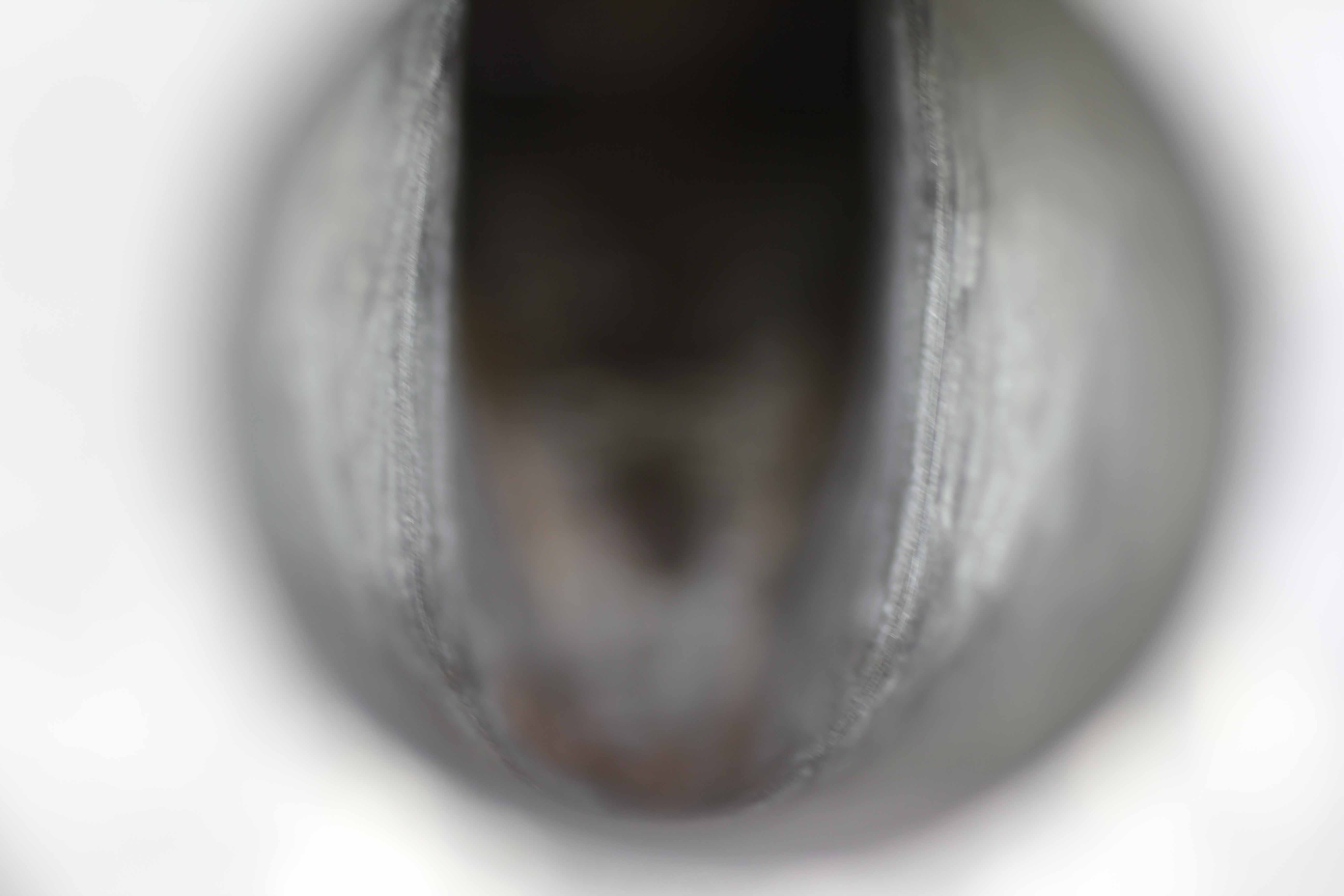

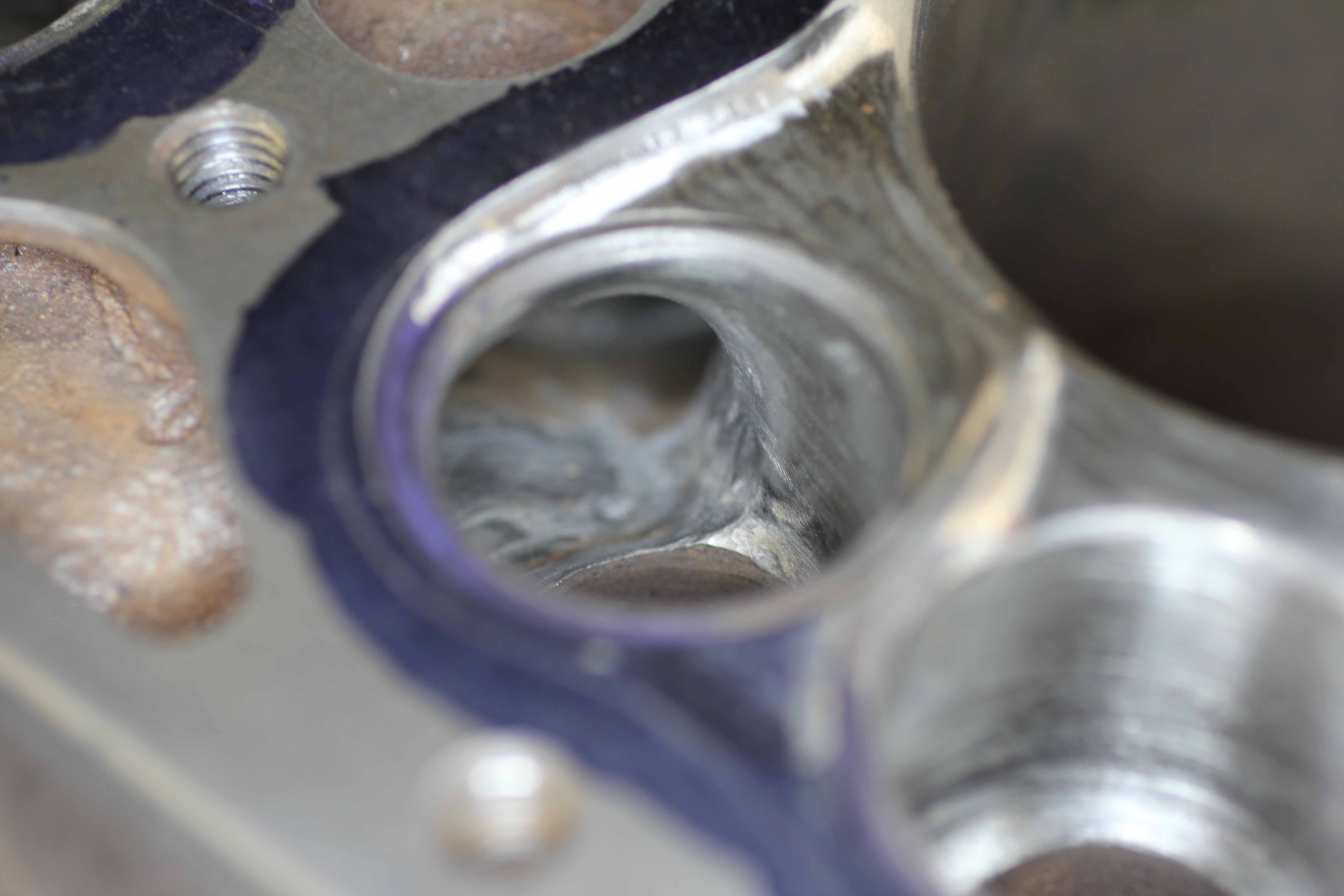

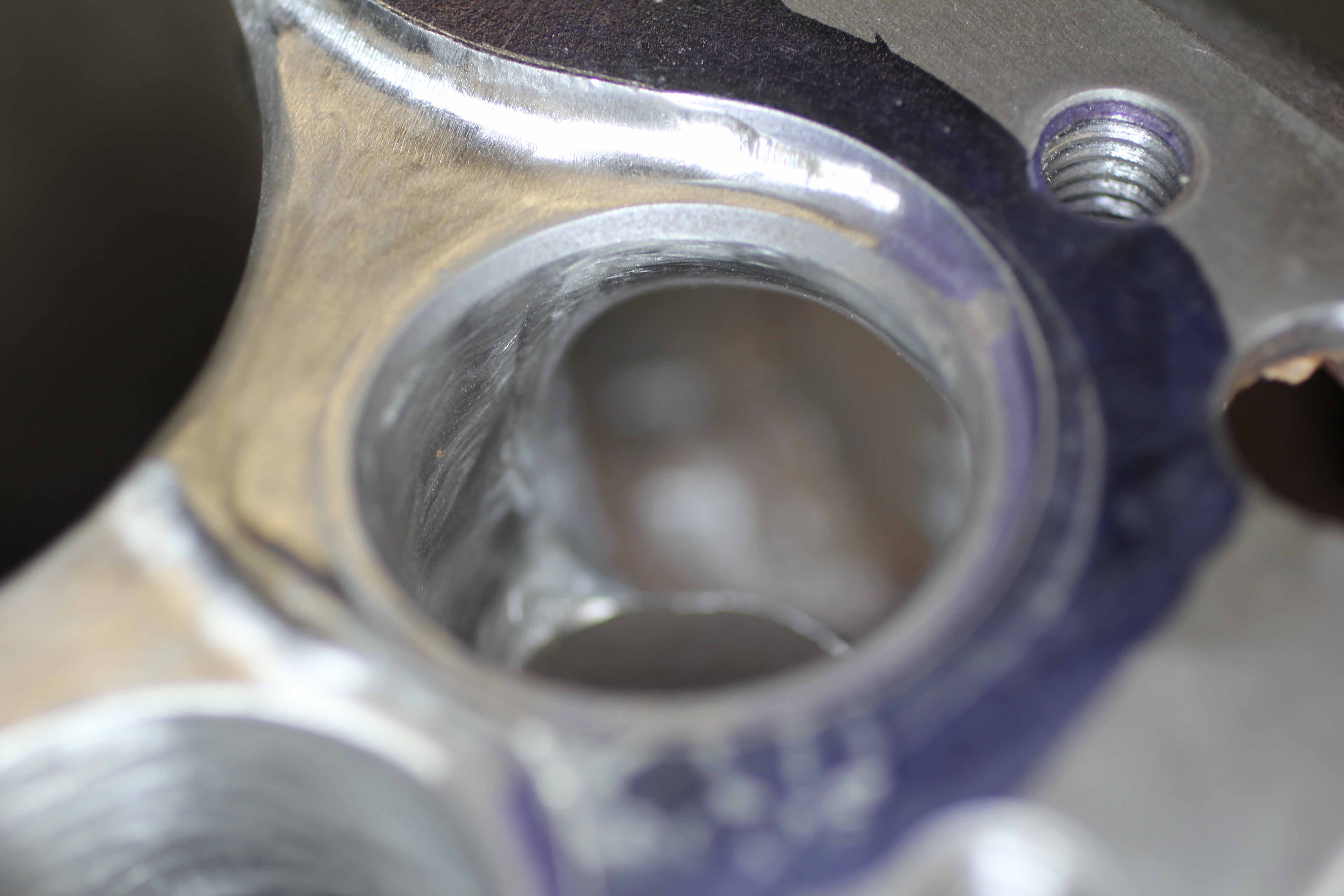

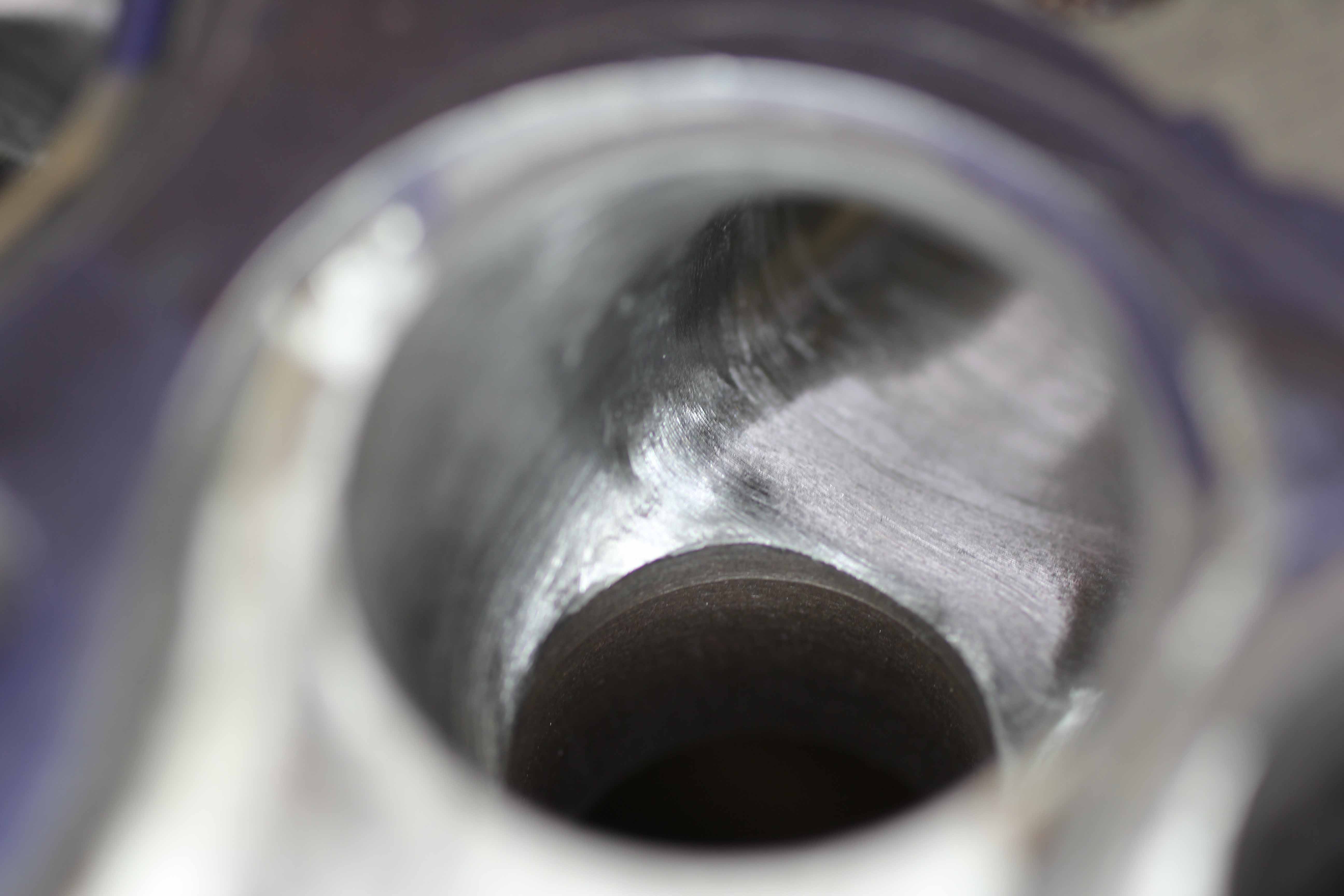

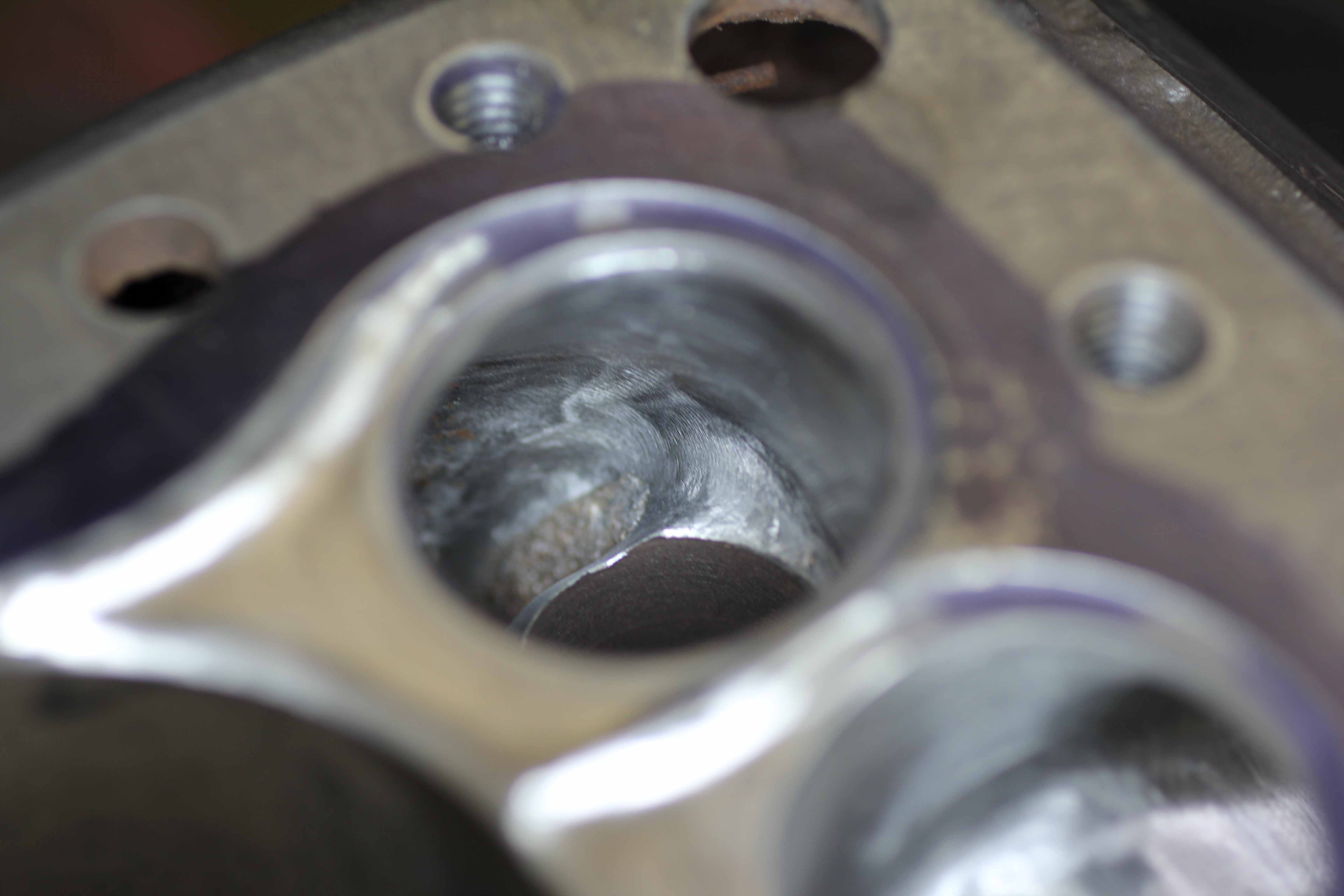

  5. Some More Porting Pictures - With a Macro Lens:
    Just bought a macro lens for my camera and a LED light ring - to make close-ups of ports a lot better. You can focus in on a very small area.
    Here is a collection of pictures:

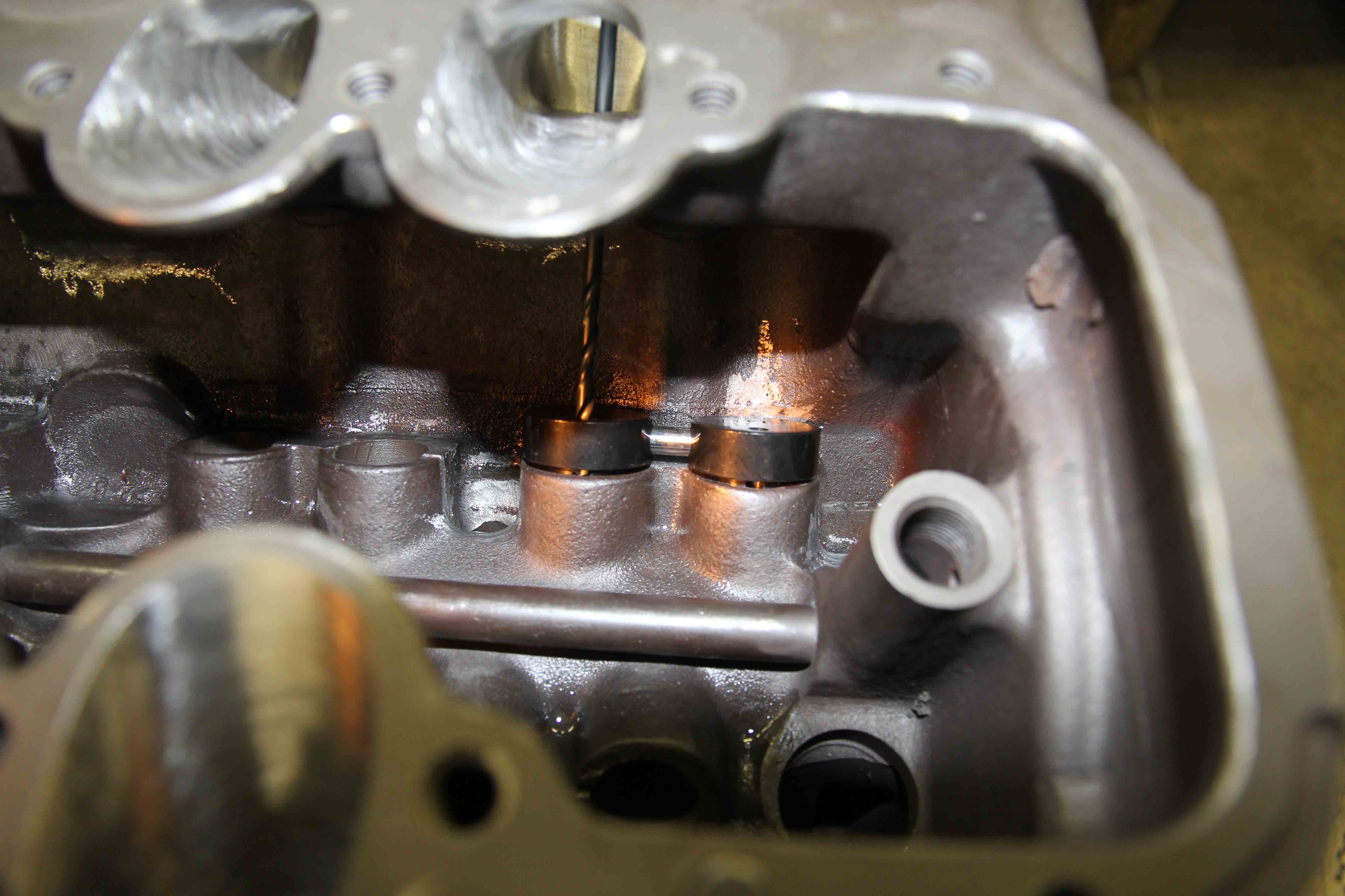

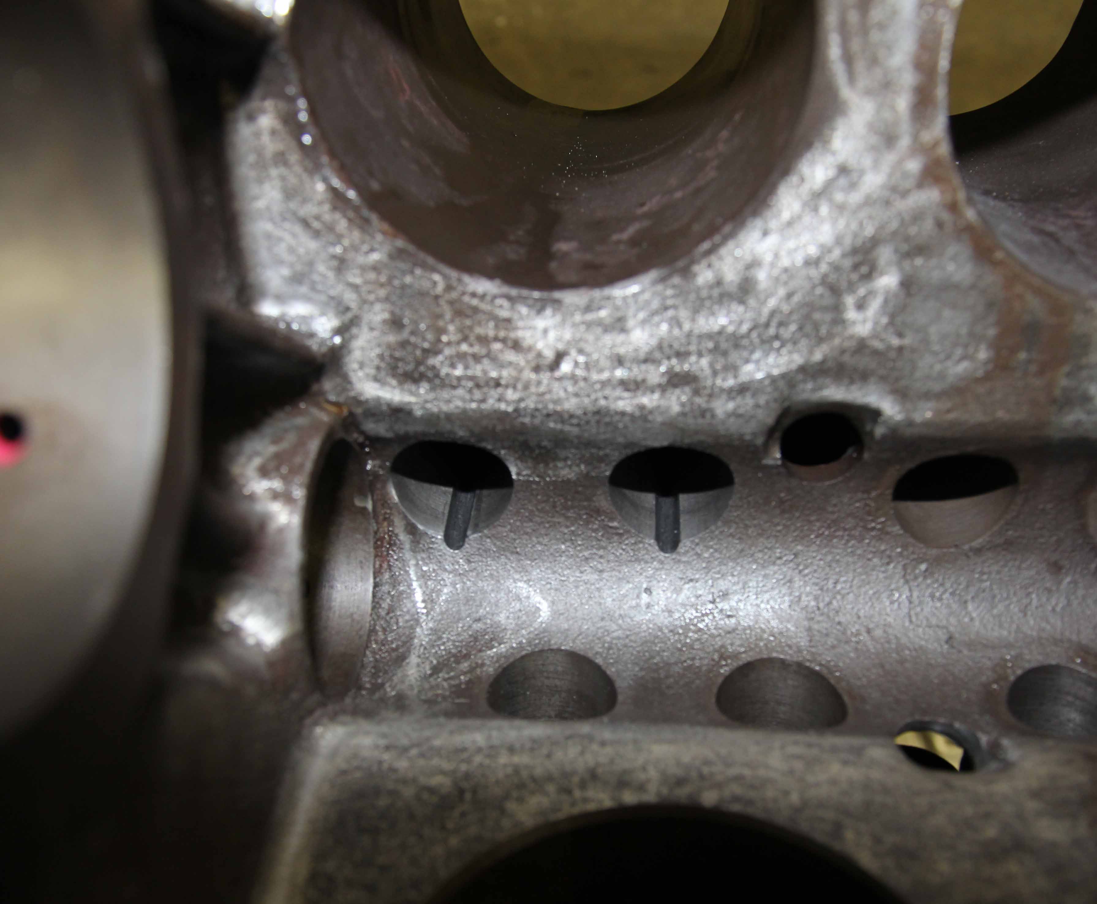

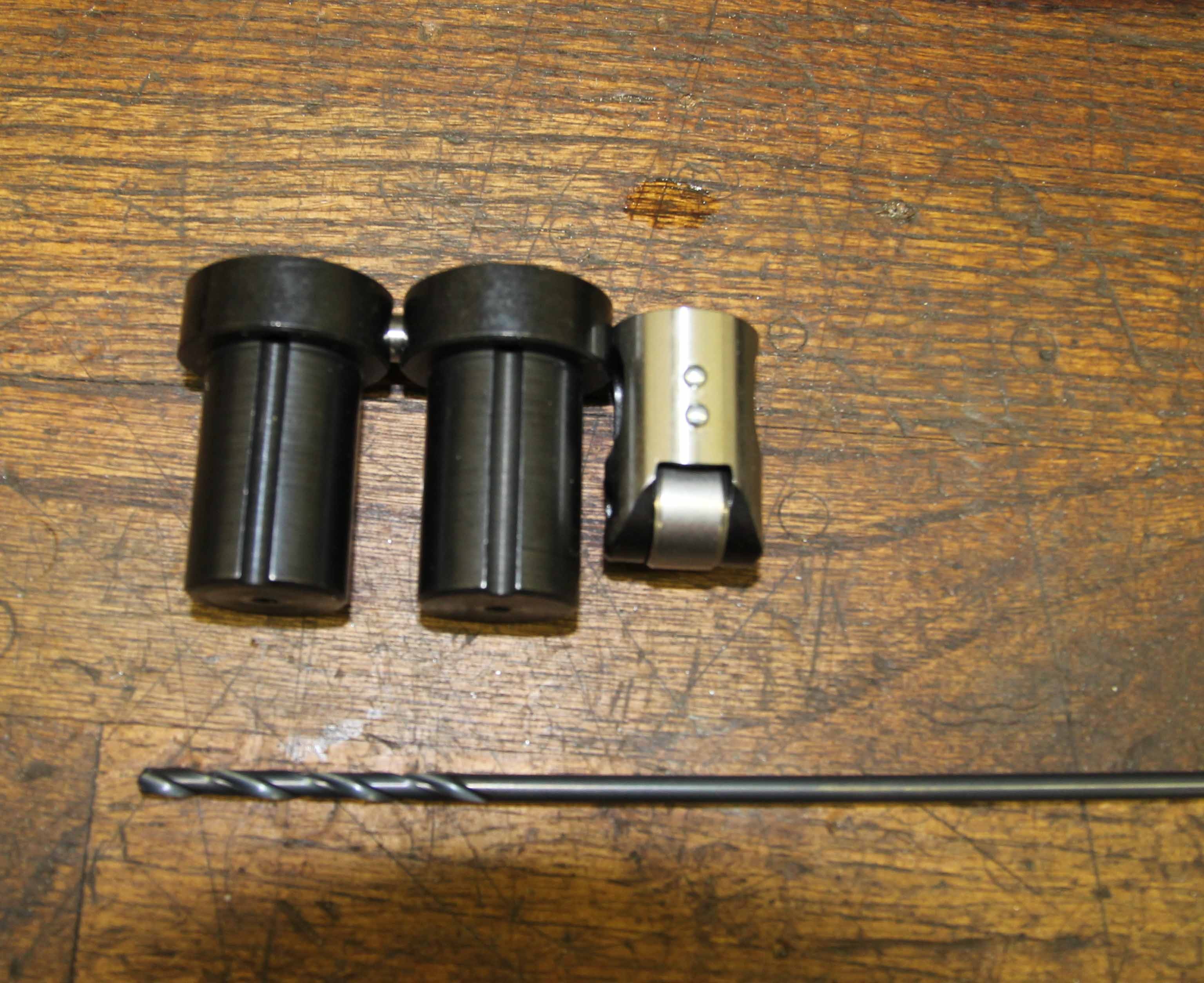

  8. Crower Groove-Lock Roller Lifters
    Here are some pictures of the Crower 'groove-lock' roller lifters, the jig that is used to drill the lifter bores and the resulting view from the bottom.
    Pretty slick setup if you ask me!

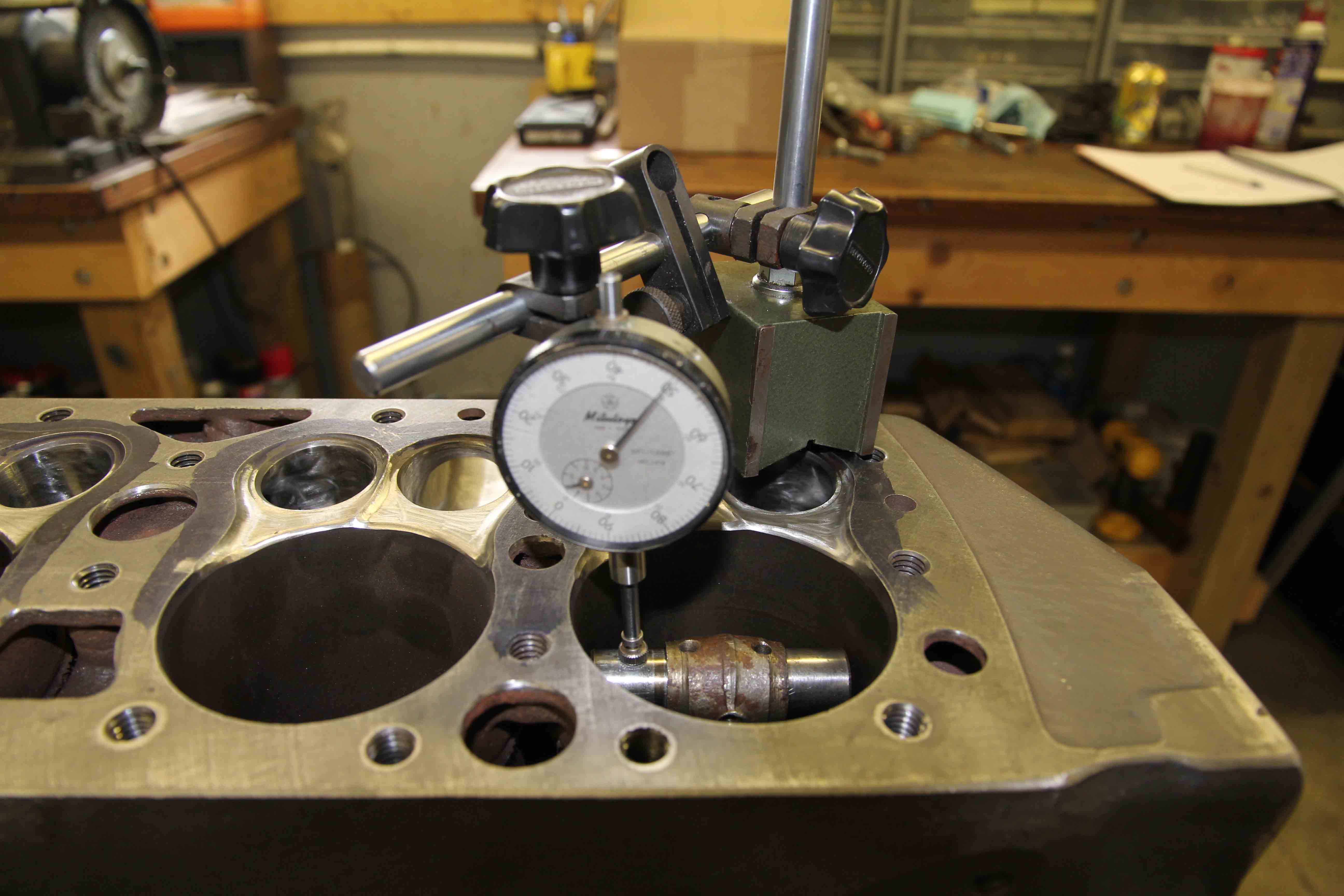

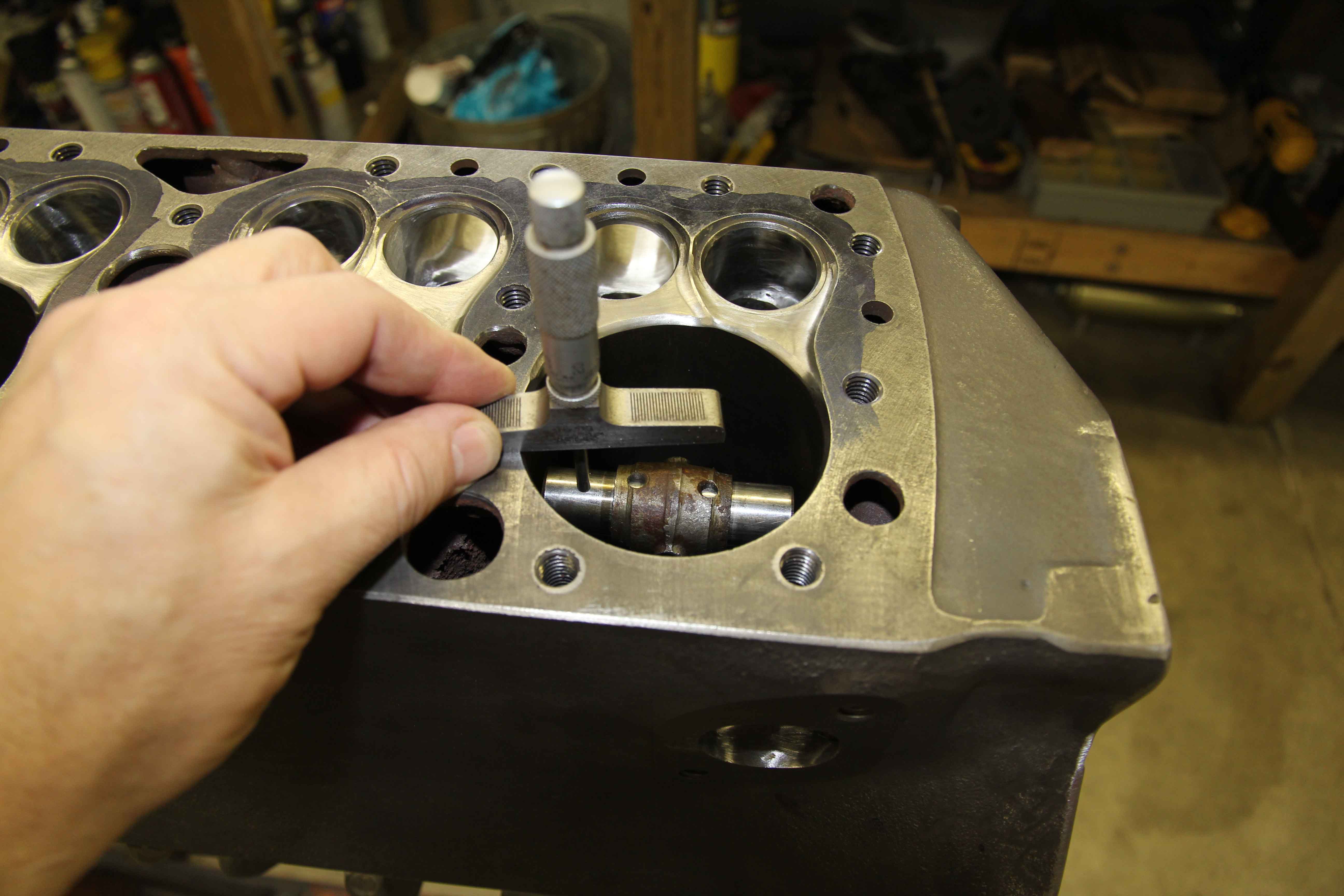

  9. Checking Compression Height - Before Piston Ordering
    I don't trust the 'off the shelf' pistons to magically match my crankshaft stroke and deck height. Due to this, I measure the compression height on both cylinder banks.
    So some are asking - "WTF is Compression Height" and why should I give a ****? Well, it is the distance from the center of the pin-end of the rod bore to the deck surface. In theory it should be the same on both sides - rarely is this the case in the real world.
    I first use a dial indicator to setup the max stroke height - then I use a depth gauge to measure the top of the piston pin. Take this measurement and add 1/2 the pin diameter (.375) and you have compression height.
    On this block, the p***enger bank is .008 taller than the driver's side. So, when I have the block head surfaces square-decked, I'll have the machine shop take off an extra .008 on the p***enger side (to true it up). Then I will custom order the exact pistons I want from Ross. This will put the DOME and squish height of the heads exactly where I want it to be . . . which is about .040.
    This is very important stuff - not a lot of guys take the time to do it.
    Note - Don't Think Your Stroke Is Exact on a Merc Crank: Another reason is that if you have a 4 1/8 stroker Merc crank, don't count on it being the exact stroke they say . . . that is usually off as well. So, specifying the exact compression height number when you order your pistons will get everything the way it should be.
    Custom Pistons Cost: Custom Ross pistons with the GOOD Total Seal rings are about $250 or so more than the off the shelf pistons with those totally **** Grant rings. Don't use them, go to the 1.5, 1.5, 3.0 millimeter ring packages!

  10. Awesome work Dale..this is what seperates a good engine from a great one. Right click, save....repeat.....

  11. Sunday Fun: Compression Height Example - As Compared to Off the Shelf Pistons
    Here is how my numbers worked:
    Height From Deck to Pin, 1/2 Pin Thickness = Compression Height
    __________________________________________________________
    P***: 1.030 + .375 = 1.405
    Drivers: 1.022 + .375 = 1.397
    Now, lets say we're going to square deck the block.
    Amount to deck the block, on Drivers = .010, P***engers = .018 (to fix the unequal deck heights).
    1) Gross Compression Height: 1.397 - .010 = 1.387 (but a few more calcs to consider below . . . )
    2) Wait - The Head Gasket: Thought I was done now didn't yah! :rolleyes: What piston to head clearance am I looking for - .040. How thick is a head gasket when it is compressed (that depends on brand). I always measure my head gaskets when I take them off - or keep them around. The ones I just measured came in at .050 compressed.
    3) Heads - Milled or Not? We're reworking my ancient Eddie Meyer heads - so they will have a complete/fresh dome.
    That means that with a .050 gasket thickness, that my pistons will still be .010 'down' from the correct height (due to the gasket). So, I'm going to scwag the CH number to account for this. I'll add .010 back, giving me the new/calculated CH of:
    1.387 + .010 = 1.397
    4) Milled 'EBay' Heads: If your heads are milled - any amount, and you bought them used, then you need to consider the dome depth and redo these calcs!. You'll notice a LOT of the old used heads have small dome areas, that is because they've had the **** milled out of them. BEWARE! Having your nice new pistons and/or valves hitting the heads - not good.:eek:
    5) What if I was a Lazy or Cheap ******* (Not that there is anything wrong with that! :eek:)
    Say I didn't order custom pistons, then the 'stock' 4 1/8 stroker ones from Ross will have a CH for a 4 1/8 stroke of 1.374. This translates to the piston being .023 thousands too short and 'down in the hole' that amount. Will it run - sure . . . will it perform at it's best, probably not.
    5) Ring Location: When you order custom pistons, you can specify the ring types and locations. I'll be using the 1.5, 1.5, 3.0 mm total seal rings. I'll specify the top-ring to be .300 down from the deck edge. This keeps it below the 'relief' I put in the deck and shields it a bit from the heat of the chamber.
    Taking the time to do this can make a big difference in how any high performance flathead runs. I want as much compression as I can get and a tight squish area - so this is what I need to do to accomplish this.
    It isn't hard . . . really the most simple math there is . . .
    B&S
    volvobrynk likes this.

    Hey Dale:) That there is called porting ****, and i just soild myself:D:D:D!
    Your details are really to learn from. You adviced me, and my Block was off by 0.020" :eek:!.
    /K
