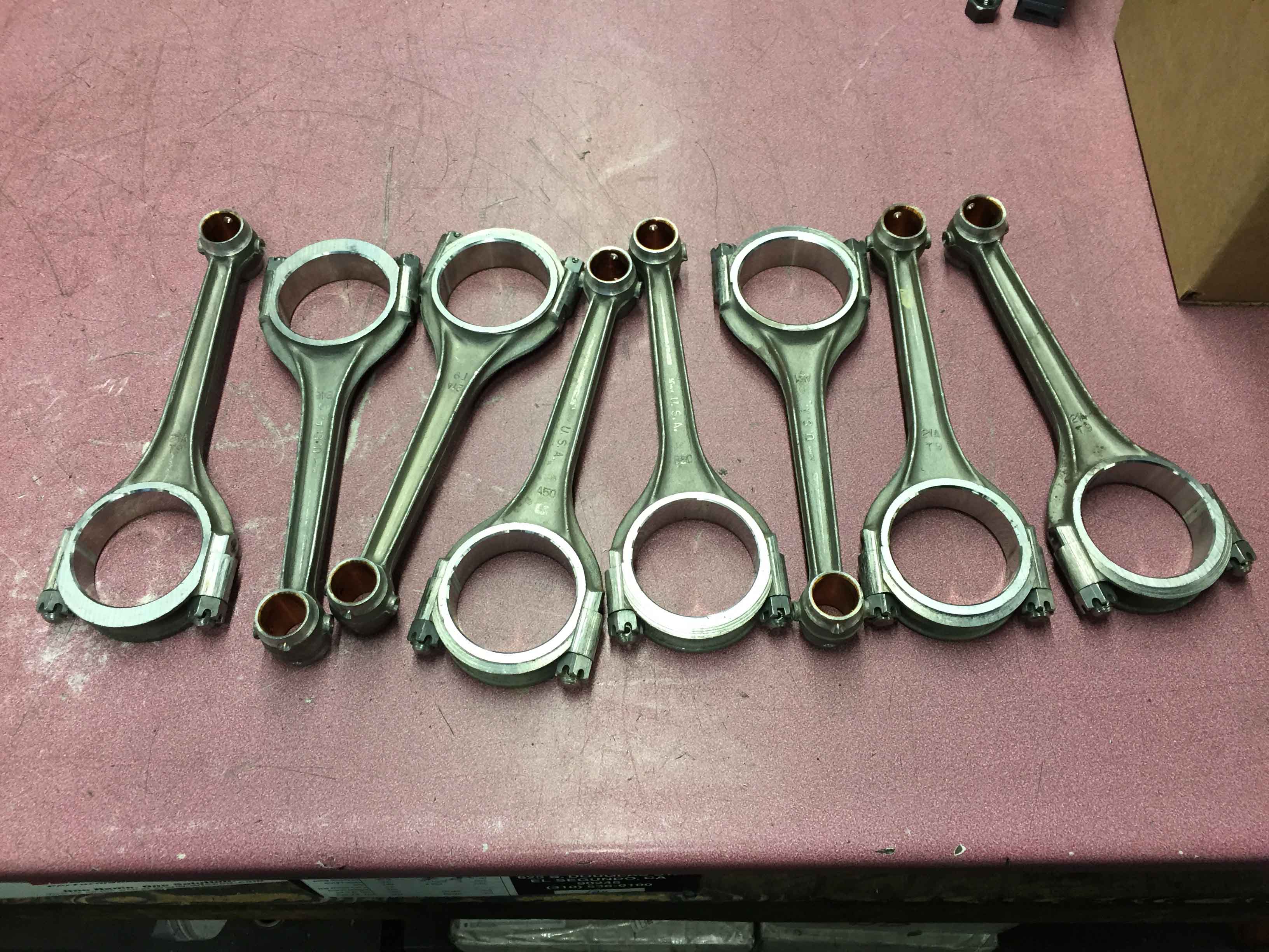

  4. Full Floating Rods - Old School, With Correct Balance Procedures:
    Seems that just about everybody these days either runs late 49-53 style rods or new H-Beams with insert bearings. Well, these didn't exist in 1942 and even in the 50's a LOT of racers still ran the full-floater 91A/21A rods from 39-42. These rods were part of the 'hot combo' that you hear about - where you take a 4" late Merc crankshaft and offset grind the rods to the early 2.00" 221 Ford flathead size and then run the 221 rods (91A/21A) and that gets you a 3/8" stroke increase ( 4 1/8" stroke). Also a lot of the guys building top-end race motors swore by the full-floater bearings - they are a bit harder to setup, but they have a lot bigger bearing surface and can take a heck of a lot of abuse. The key is getting the bearing shells to correctly fit the rod bores and to ensure you have the correct clearances on both the journal as well as the rod side (along with enough side clearances to get the oil out!). I prefer to run them 'loose' - and keep a lot of oil in them. This is a very proven setup, just not that many guys doing it today.
    I found a NOS set of 21A rods - packed in cosmoline from Ford - in a nice sticky *** box. Man, I love the look of a new set of these rods - such nice workmanship from Ford, wonderful steel, highly polished big-end bores (remember, these are bearing surfaces).

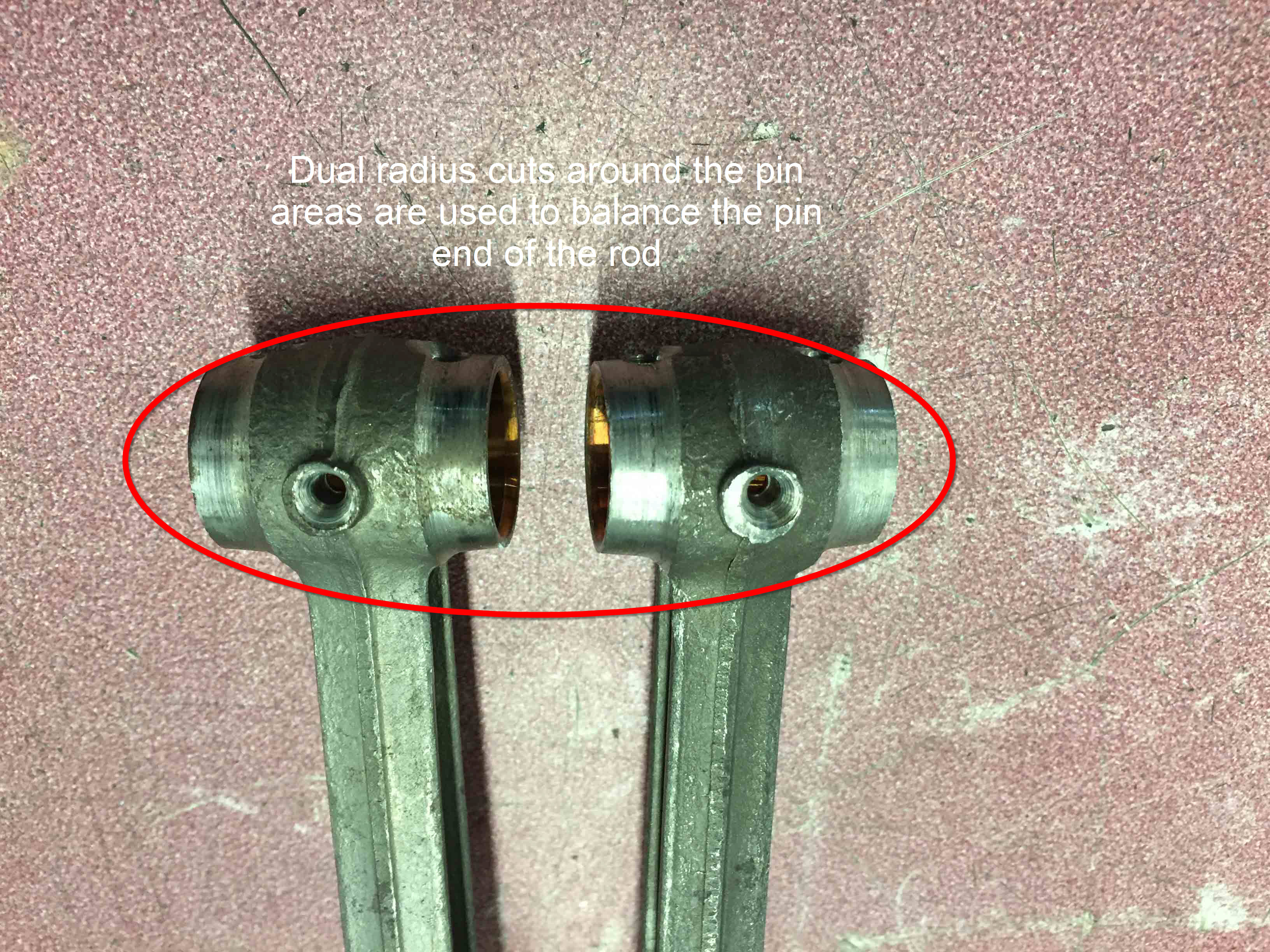

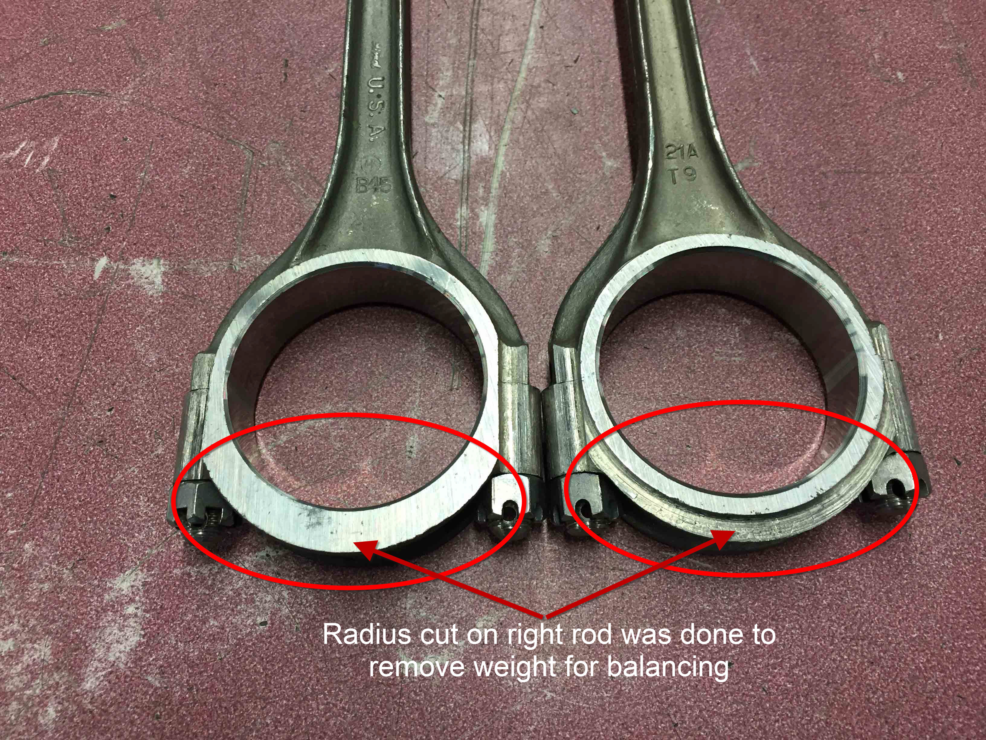

    Correct Way to Balance Flathead Rods - Like Henry Did! (Important!):
    These rods do not have big lumps of steel (known as 'balance pads') like modern rods - see below:
    So, what most machine shops do is just grind away on the bottom of the caps for the big ends and the tops of the pin areas for the pin ends. Yes - it gets them balanced, but this is the WRONG way to do it! Ford balanced their rods by cutting away material in a lathe of some sort - around the big ends on both sides and on both side of the pin ends. This is NOT what most machine shops have a clue about. If they just grind away on the bottoms and tops like they plan to, then you weaken the rod - don't let them do it!
    Notice these two pictures - I've denoted the areas where material is removed to correctly balance the rods - notice how on this complete set that you can easily see the machine work and differences. This is how you need to instruct your machine shop to balance the rods - if they won't do it, then find another machine shop!

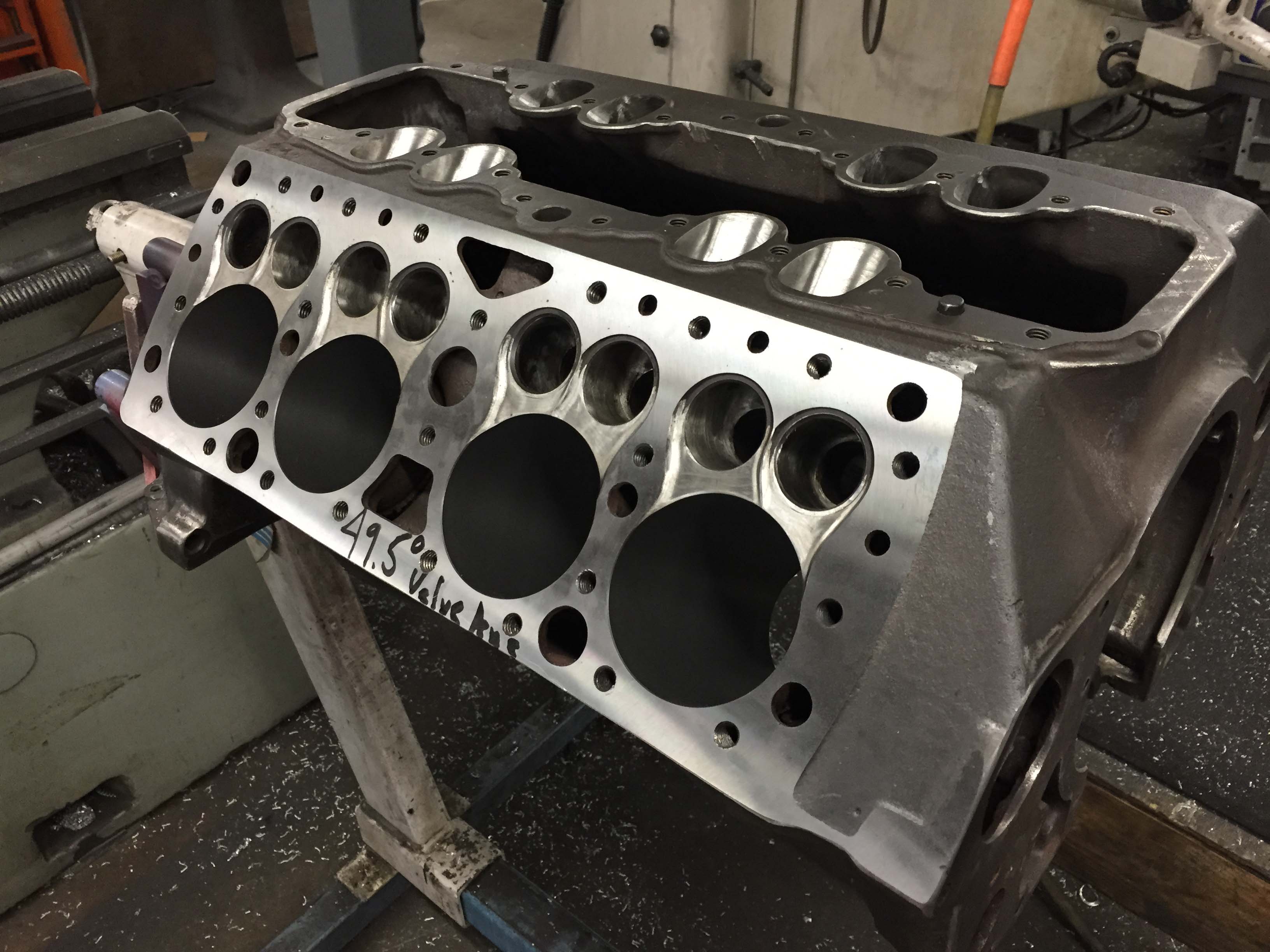

  23. Hey Gang - just got back in town, went down to Fowler's today to checkout the valve work. To refresh your memory, had 1.75" hard seats put in the intakes (using 1.72" valves) and then had all the seat and valve work done. I'm using the stock exhaust hard seats and 1.6" valves. The valves are all Manley severe duty stuff.
    Time and Money: Everything was done in a big milling machine - using a crankshaft saddle fixture that guarantees the correct block placement and angle in the mill. There is a lot of time consuming and complex work in setup/fixturing - as you have to setup each side of the block, get the valve angles correct, etc.. This is an expensive way to do it - but results in a really precision job as mandrels are used to pickup the guide bores and high quality multi-angle cutters are used - with the mill DRO electronics giving consistent cut dimensions (and depths) from one seat to the next. The new intake seats were about .250 in depth, but we only put them in about .1875 deep - as they are quite a bit larger than stock, we were worried about hitting water! The carbide cutters trimmed them down to the correct height to match my relief work.
    Anyway, was really happy with the work today - really done well. All the valves look consistent, same seat widths and margins, etc.. All in all, he put over 2 solid days into the work . . . yikes!
    Can't wait to get the engine back and start putting it together . . . though I have a lot of 'head work' to do!
    Here are some pictures:

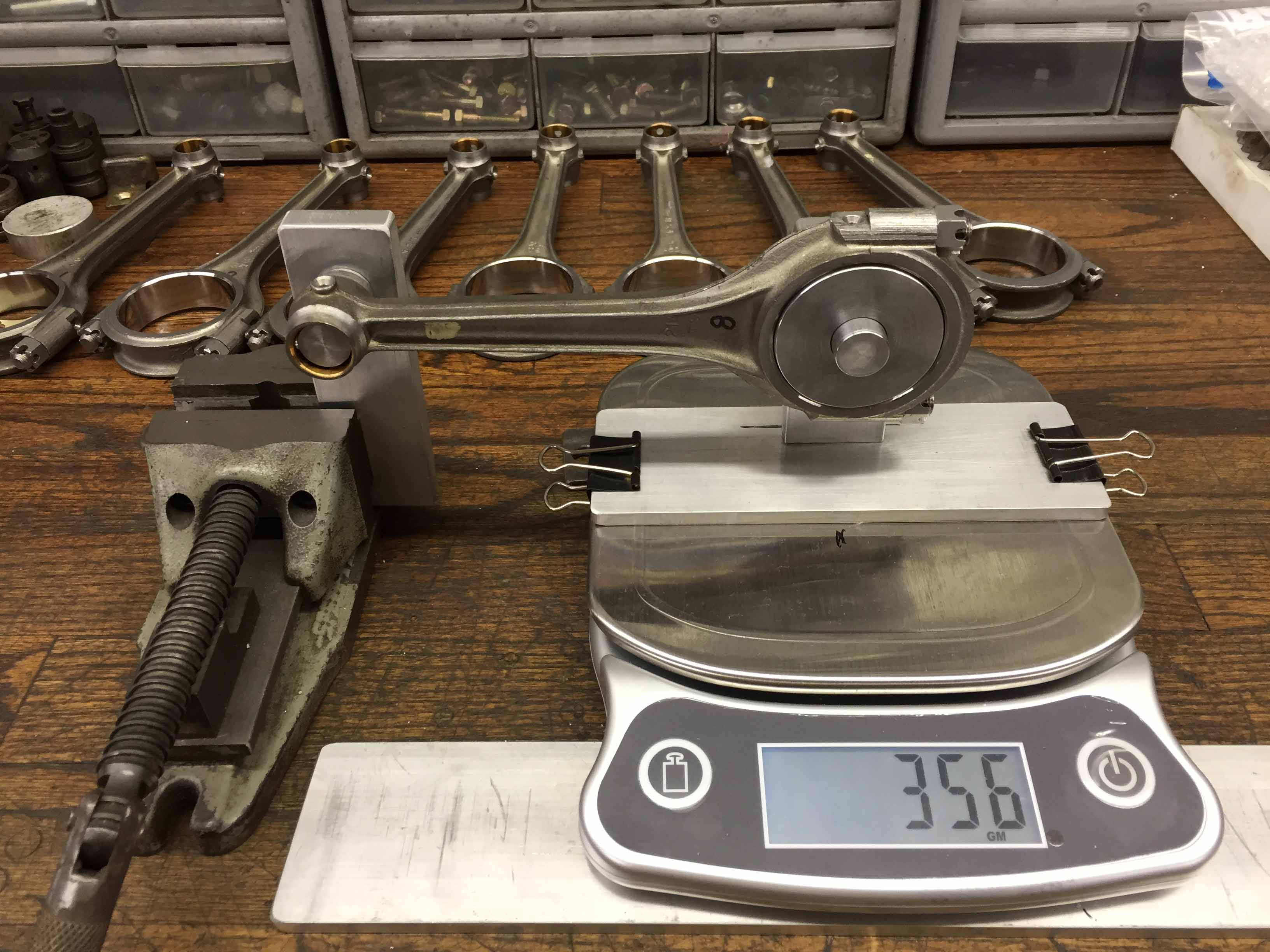

  29. Balancing Rods - Decided I Better Get Into It Myself (Building a Scale for Home Use):
    Given my previous post about my desire to balance the 21A rods the way that Henry did . . . and not like all the shops that I've ever seen, I decided to not wait for Fowler to do it (as it is a pain in their rear to setup for). Since I plan to run more Ford rods in the future (21A or 8BA), I kind of need a setup to handle it myself.
    So - the first thing I needed to do was create a rod scale to be able to determine the actual weight differences between the big and small ends. I built this last night - it currently uses a 'kitchen' scale I had laying around (only 1 gram resolution - not quite accurate enough for the long haul, . . . so ordered a .1 gram resolution scale tonight).
    Basically you have to measure each end of the rod and balance the ends to match the lightest of the set of rods. I found the following (keep in mind this is a matched set from Ford, packed in cosmoline and already balanced):
    Big Ends: There was a 10 gram difference between the heaviest and lightest
    Pin Ends: There was a 7 gram difference between the heaviest and lightest
    Note: My measurements matched Fowlers (as we did it on his scale while I was there a few days ago). It is kind of 'tricky' weighing rods - and the slightest movement of the rod will cause the grams to move around a bit. Even on the super precision one that Fowler has - one has to know how to use it and be comfortable with how to accomplish 'repeatability'. You learn to do the same exact thing - over and over and really pay attention to alignment. Also, any little piece of dirt or a burr on the centering plug (or the rod) can screw up a reading.
    Here is my 'fixture' I made:
    Next I plan to make a fixture to allow me to machine the Big-End Caps in my lathe - might as well make it for myself, so I can use it in the future.
    Stay tuned - this engine is getting close to coming home!
