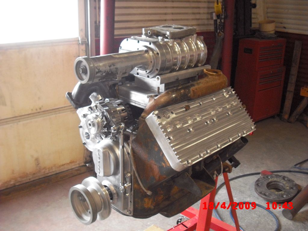

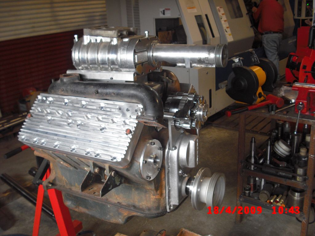

    I started building a '38 Lasalle, with a blown Cadillac flathead. Somewhere along the line, I became consumed with the engine. You can see that build here:
    http://www.jalopyjournal.com/forum/showthread.php?t=430439
    After setting a build goal of a hard to reach 500 hp, I asked myself what I really wanted to do with the mill. I've waffled for the better part of a year now, and decided that the salt was where I wanted to go.
    Soooo, here we are. I don't want to 'undo' the body mods that fink'd did to the Lasalle, so a '38 chevy coupe is the lucky recipient of the flatcad.
    And since I'm new to LSR events, any advice is welcomed and appreciated! We will be running in the XXO/BVGC class, on a 151.208 mph record set by Mike Hegarty in 2004.

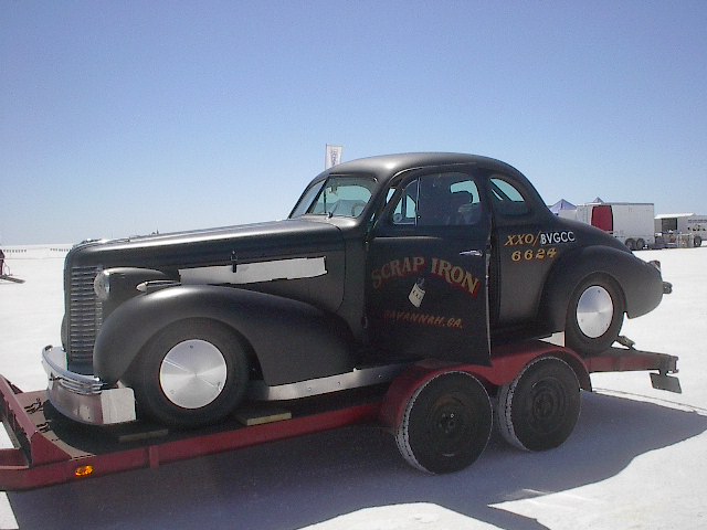

    The car has run 139+ at Maxton
  16. RichFox
    Joined: Dec 3, 2006
    Posts: 10,020
    RichFox
    Results show it running twice on Monday. A rookie pass and a 141.075

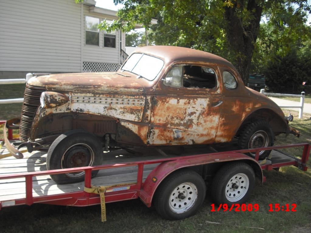

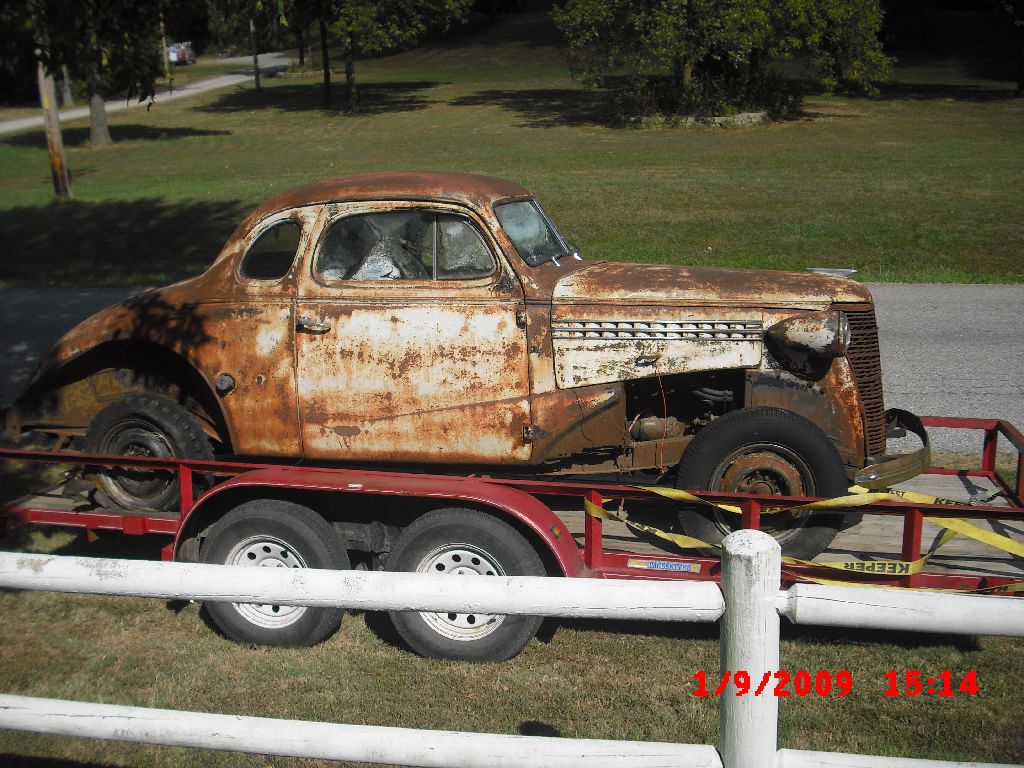

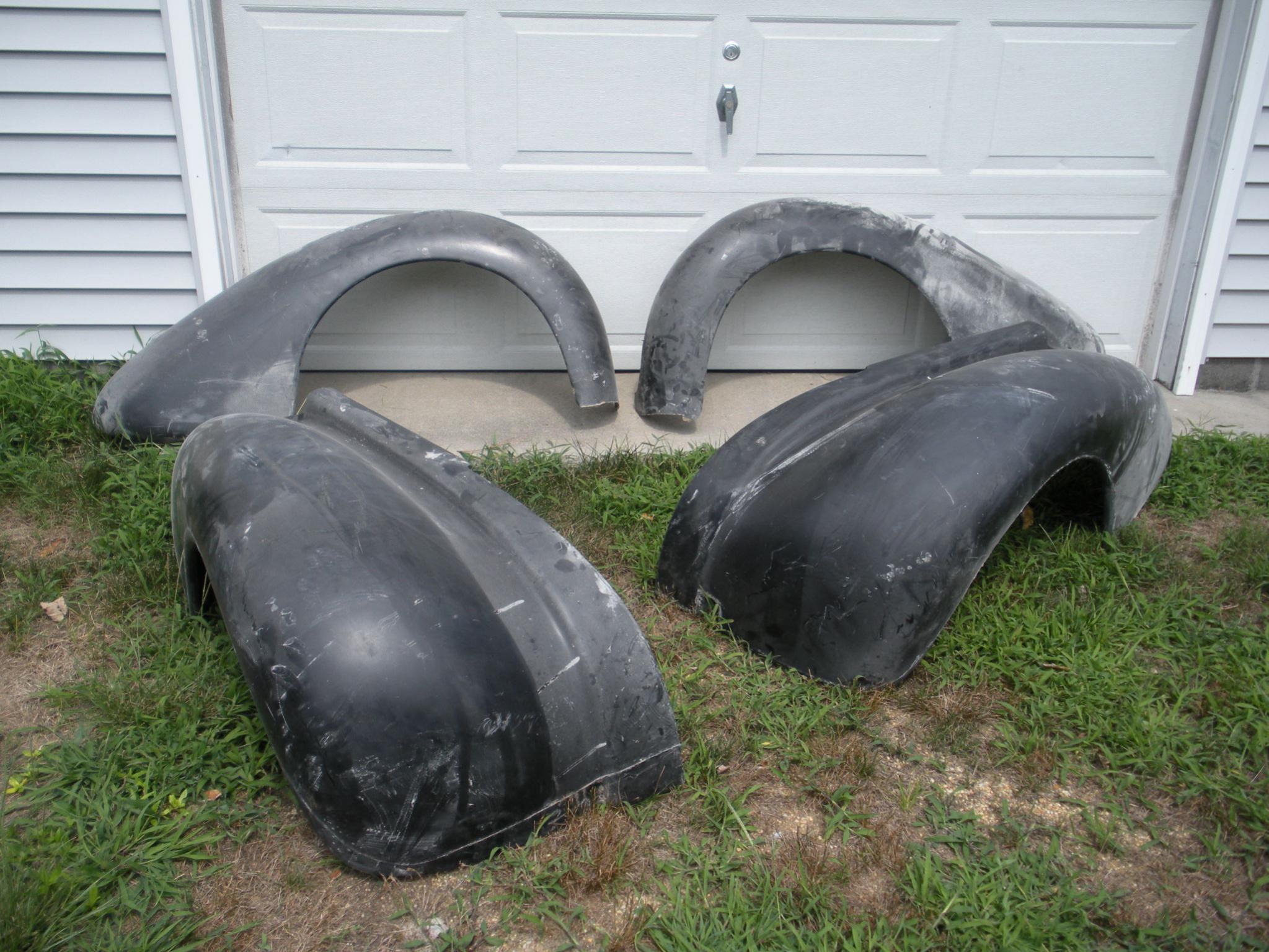

    Well, I picked up the '38 coupe this week, and took it to wrenchbender ( thanks Jackson!). He's going to put a Chassisworks 4-link with a Watts link under it for me. We are going to have the GM 7.5" narrowed 4", so that it's tucked in tight.
    I found some new fiberglass fenders for it, so we are on our way. We are going to concentrate on the body and chassis, while we wait for engine parts.
    After the rear end and 4-link are in, it's off to choptvan in Colorado Springs for a haircut!
    A special thanks to truckncoupe, for finding this car and lining it up for me!
