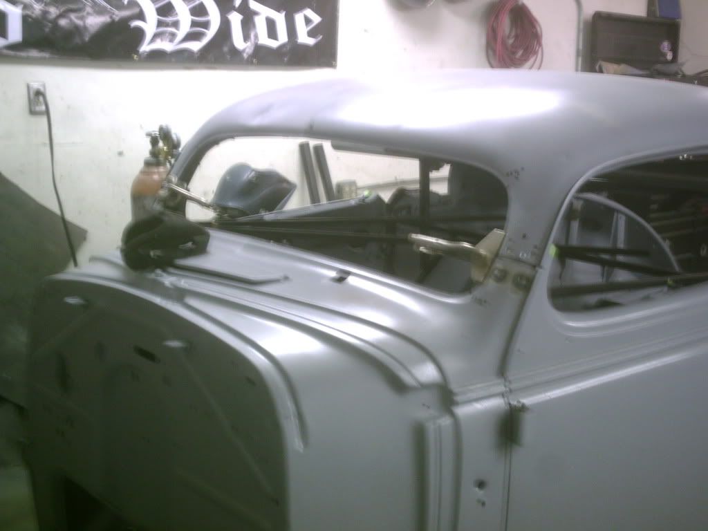

    She is sitting almost where she belongs. I still have a bunch more measuring to do to be sure I do not exceed the rules. But here she is as of today. And do not worry bout that quarter window. I have a plan.
    how to chop a car when noone is around....
    these are inserts to ensure strength. I know it will have a roll bar. But a little extra won't hurt right?

  6. truckncoupe
    Joined: Apr 4, 2009
    Posts: 1,428
    truckncoupe
    Holy cow Buddy,
    She sure looks a lot different from when I saw her under the tree in Chanute! Looking good!
  7. Sorry to hear about your newborn- hope the little tyke's feeling better soon!
    The chop looks great so far... VERY smooth:D

    Here is some progress for the day. Once I get the other side all tacked together, I am tackling it with a wire wheel to get all fo the primer off. Shouldn't weld over primer. These are only tacks. Then I am getting out the hammer and dolly to massage it as I weld it. The welding will be really slow, so after it is all tacked together, I will not really be showing to much progress. But here we sit as of today. I am still working on it but she is getting there.
    I just saw that the quarter window looks pointed. Doesn't look that way in person. So I will check it out better tomorrow.

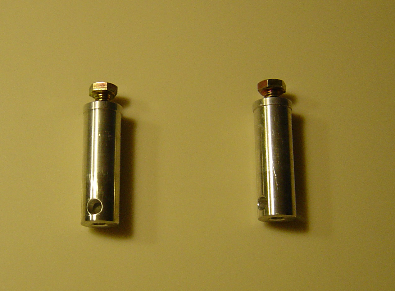

  18. Did a little bit of work today -- made a set of aluminum 'FlowBench' lifters. They're designed to go into the lifter blocks - the top has a flange so they can't drop down.
    These make it easy to put some 'setup springs' on a couple valves and set the valve open height to be .100, .200, .300, .400 and .500 -- then test the flow with all the rest of the things we need to try. We'll be using a junk block as a guinea pig - so we have plenty of ports to try. One thing that is different on a FlatCad versus a flathead Ford is that the ports are not the same - front to back, there are actually 4 different intake port lengths/shapes, similar for the exhaust. (Now isn't that a pisser - damn Cadillac engineers!).
    Here is the type of stuff that will be done:
    1) Base line numbers with stock ports, stock valve sizes, etc..
    2) Rework the valve bowl areas (lots of room for improvement), start the porting procedure (doing all the normal 'short-side' radius work, hogging out the runners, etc).
    3) Test a variety of larger valve sizes to determine when we are port restricted (with a competition port) - versus valve restricted. We can go up to about a 2.05 intake and a 1.75 exhaust -- though we may find that we run out of flow at smaller valve sizes. My guess (and that is what it is :rolleyes:) is that at about a 1.94 intake, we'll be done. Keep in mind that we will have a large-bore 6-71 on the top with a Enderle Bugcatcher - so we'll be force-feeding it . . .
    4) Test with our new combustion chamber designs and proposed block reliefs. We've carved up some prototype combustion chambers on a CNC mill - directly from the cool SolidWorks designs that Chris Daniels has done.
    Flowbench testing isn't going to tell us exactly what works or how much HP we'll make -- but hopefully it will give us some dang good ideas to try . . . the dyno and the track will tell us if we did the right things.
    The hard part is that we have NO real numbers for baselines for ANYTHING - other than the testing that was done about WW2 timeframe --- so we'll just use the knowledge/experience of the group, throw a bit of luck in, send a few prayers to the Flathead Gods and see what happens. Time always gives us answers . . .

    Here is an update worth posting. Starting to look like somethin finally. I have been workin on it most daily, but tack/cool/grind is hardly worth the effort to post. I would post a better profile pic, but it snowed a lot here so I do not want to push it outside right now.
  22. Looking sweet!!
    Got rid of the point too!
  23. Now we're talking!
    Good looking stuff . . . the corners look a lot better - I'm liking what I'm seeing!
    Dale

  27. choptvan
    Joined: Mar 19, 2010
    Posts: 2,161
    choptvan
    As close to a profile pic as I could get today. And some work on the other side. I have also begun the lovely process of grinding. Still have a lot left to do.
